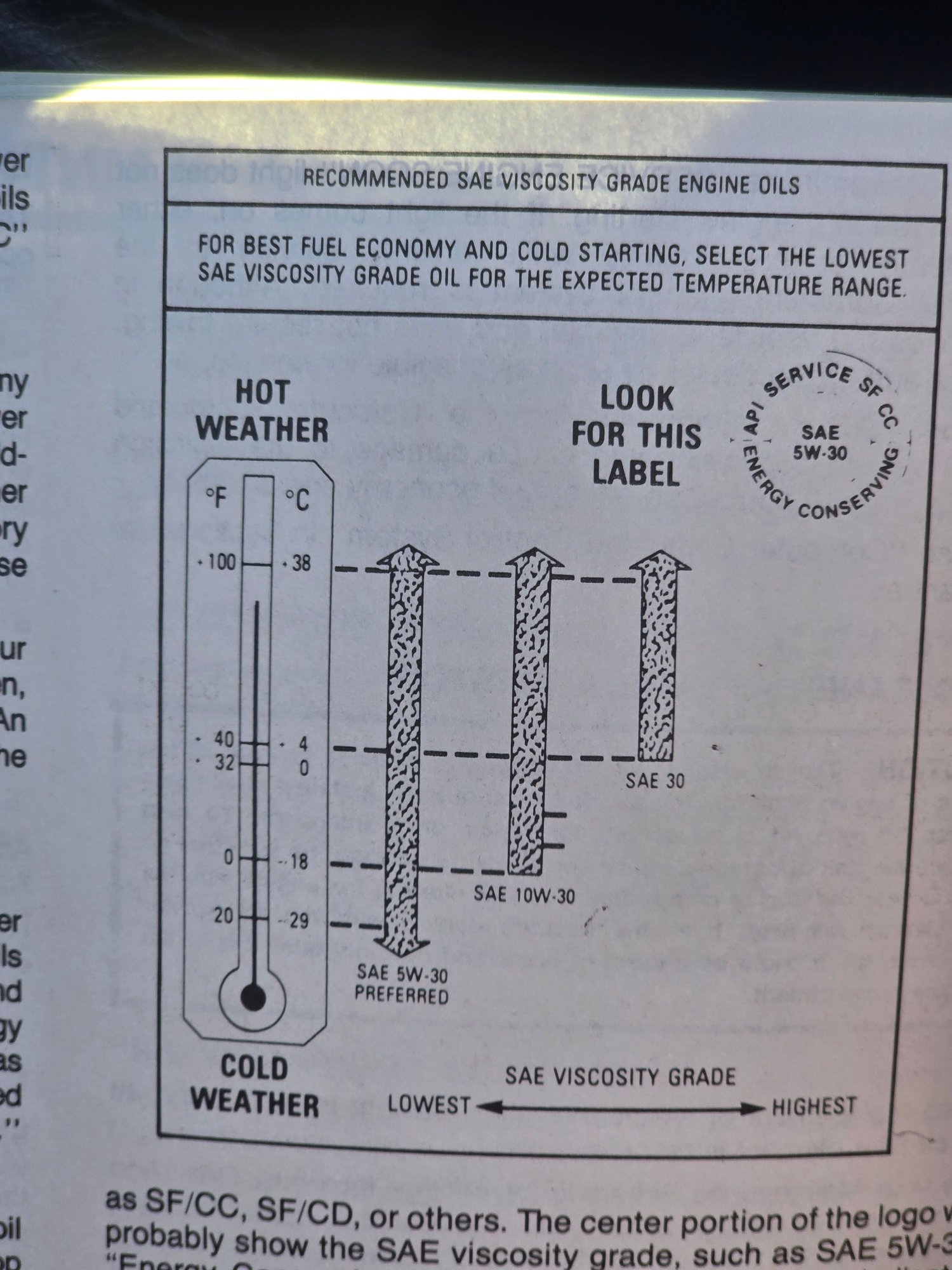

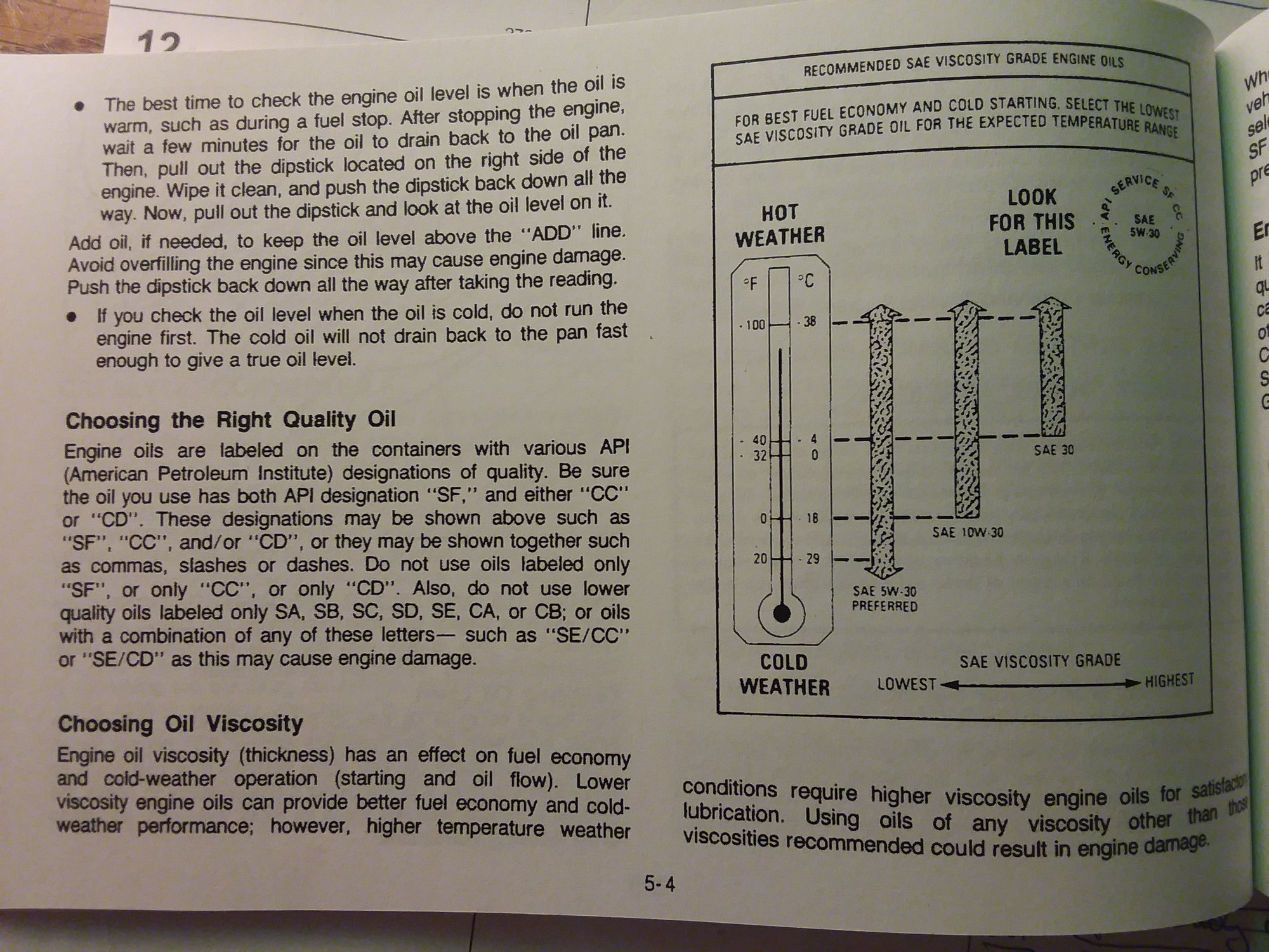

I have a 1986 base and the owners manual says to use SAE 30 for operating temperatures of 40 - 100 degrees. Which is heavy duty . Ive been using 5W 30. Can anybody give me some feedback on this?
This is from my GM  1986 corvette owner's manual

why does it say in the GM manual for my 1986 Corvette to use S.A. 30 oil for operating temperature 40° and above
Well the 30 is for its viscosity at 100 Celsius, so as long as you are using that you are following the spec. The engine gets to those temps very fast. 5w or 10w is the cold spec, which is thinner and what you want on starts.
Straight 30 would not be your friend in cold weather starts, and would normally only be used when in old engines the gaps are bigger than your thumb.
As to why its in a 40 year old manual, I don't know, just don't use straight 30.
lets see a screen shot of that

What it says is that "5W-30 is preferred". Note that the 5W-30 arrow is the only viscosity with the arrow pointing downward. They allow the other viscosities at the indicated minimum temperature or higher. They do not say to use the thicker viscosities. Only that they are allowed at the minimum or higher temperatures indicated.
I live in Southern California. Temperature at start up is <40F about 5 days a year. I ran straight 30 in my 85, my 4.3 S-series DD's, and probably the boat's 327 as well for a couple of decades. I liked the higher hot oil pressure and the engines ran quieter. The primary reason I stopped was that 30 is difficult to find except as a Compression Ignition (diesel) oil which has zinc and phosphorus levels that are harmful to cat converter health, which being in California is also a concern as cats need to be functional to pass biennial emissions.
I've never run 5W-30 in any of my cars even though that has been "preferred" since 1986. Reason being that the rod bearings in my bought-new 1993 S-10 Blazer looked like crap at 103k miles. I had been running 10W-30 (not the recommended 5W-30) and the rod bearings still had significant wear for the mileage. That engine used Delo 400 30W for the next 300k miles, the guy I sold it to never had the heads off either, and ran it to over 400k miles before the rust worms got it. Yes, he lived in Michigan, and still ran 30W because he didn't want to mess with what had worked for 20 years.
The "correct" viscosity is dependent on operating conditions and the specific characteristics of the engine the oil is in. I have 7 cars and the boat. They all use a different viscosity and brand oil. (One of the cars uses a specialty 10W-60 that solves a lifter issue unique to this particular engine.) Royal PITA, but I strive to use the appropriate oil for the conditions and engine. I don't have bearing or other trouble, and consumption is tolerable.
If the OP seldom starts his engine at <40F, he'd be fine with straight 30. If he can find it, he'll have higher hot-oil pressure at idle, and engine operation, particularly when cold, will be quieter.
