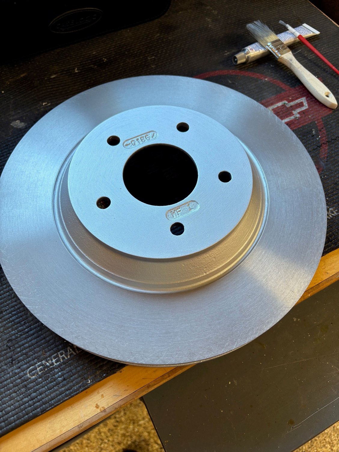

I had a 78 year old master machinist turn my stock rotors. Rotors are kind of like cast iron blocks. Everyone wants a "seasoned" block with a lot of heat cool cycles in them. A lot of internal stresses go away. He snuck up on them making only 2 thousands cuts. Since I have time I did a little cleaning and painting. These days half the rotors he machines are BRAND NEW. He said the quality of some of the Chinese rotors is horrible. I still have about 22 thousands to cut on each rotor before minimum thickness. The random scratches on the surface is from a sander he hits them with to create a surface that will bed the pad better. Dan

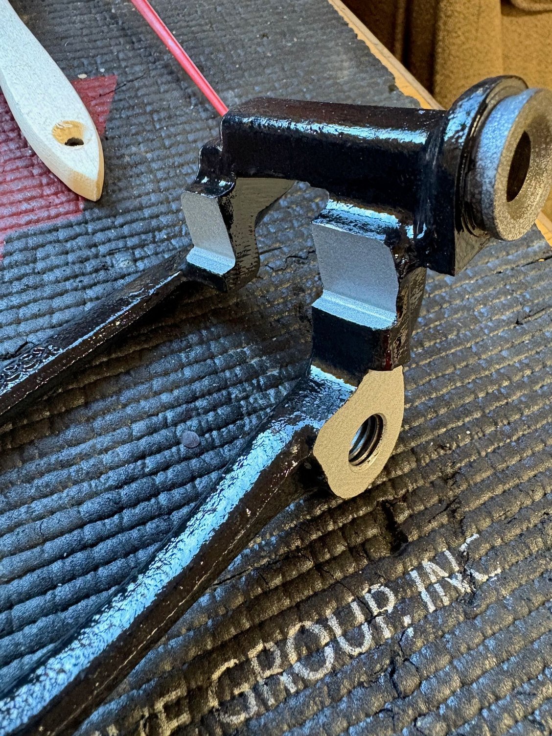

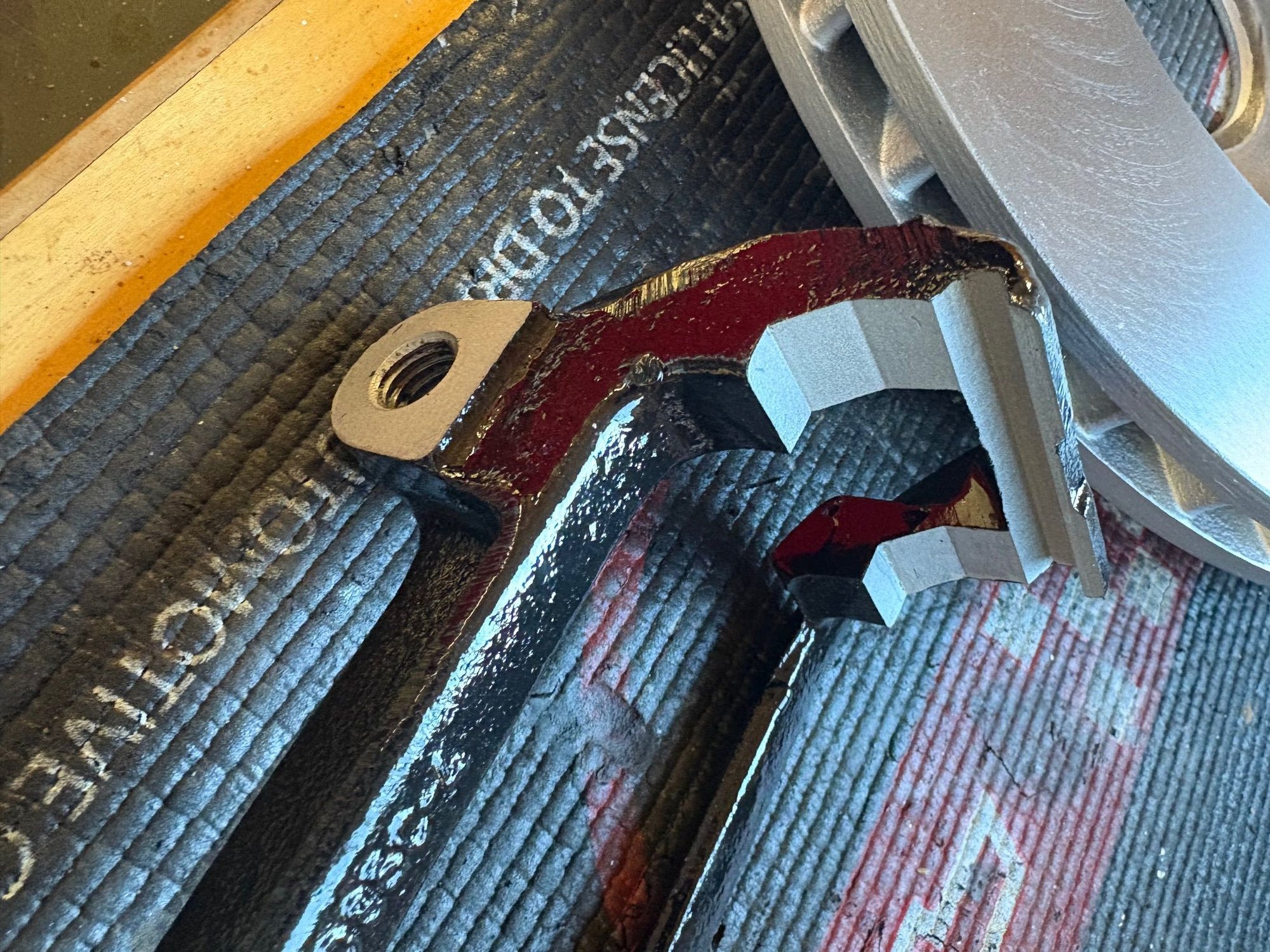

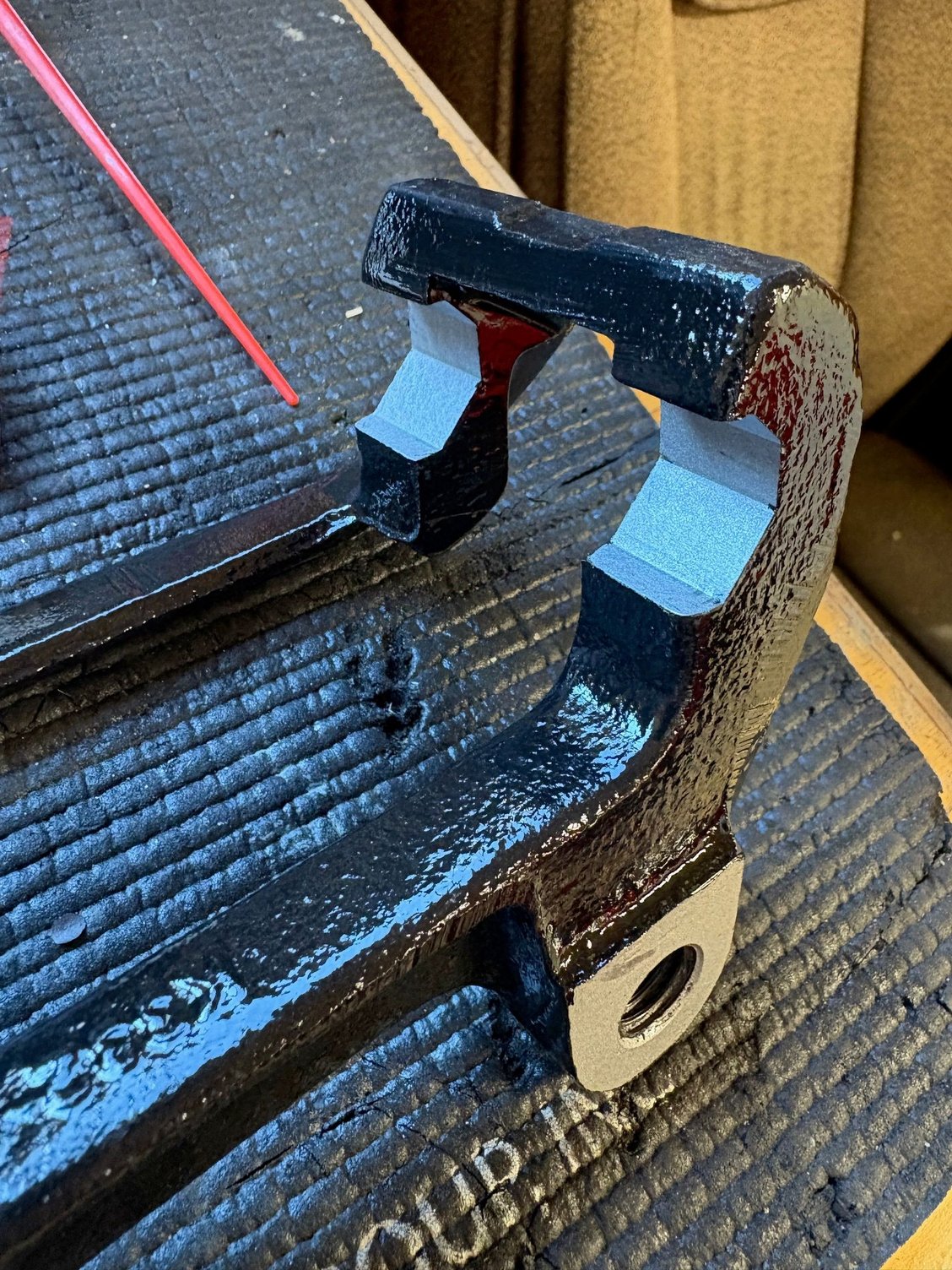

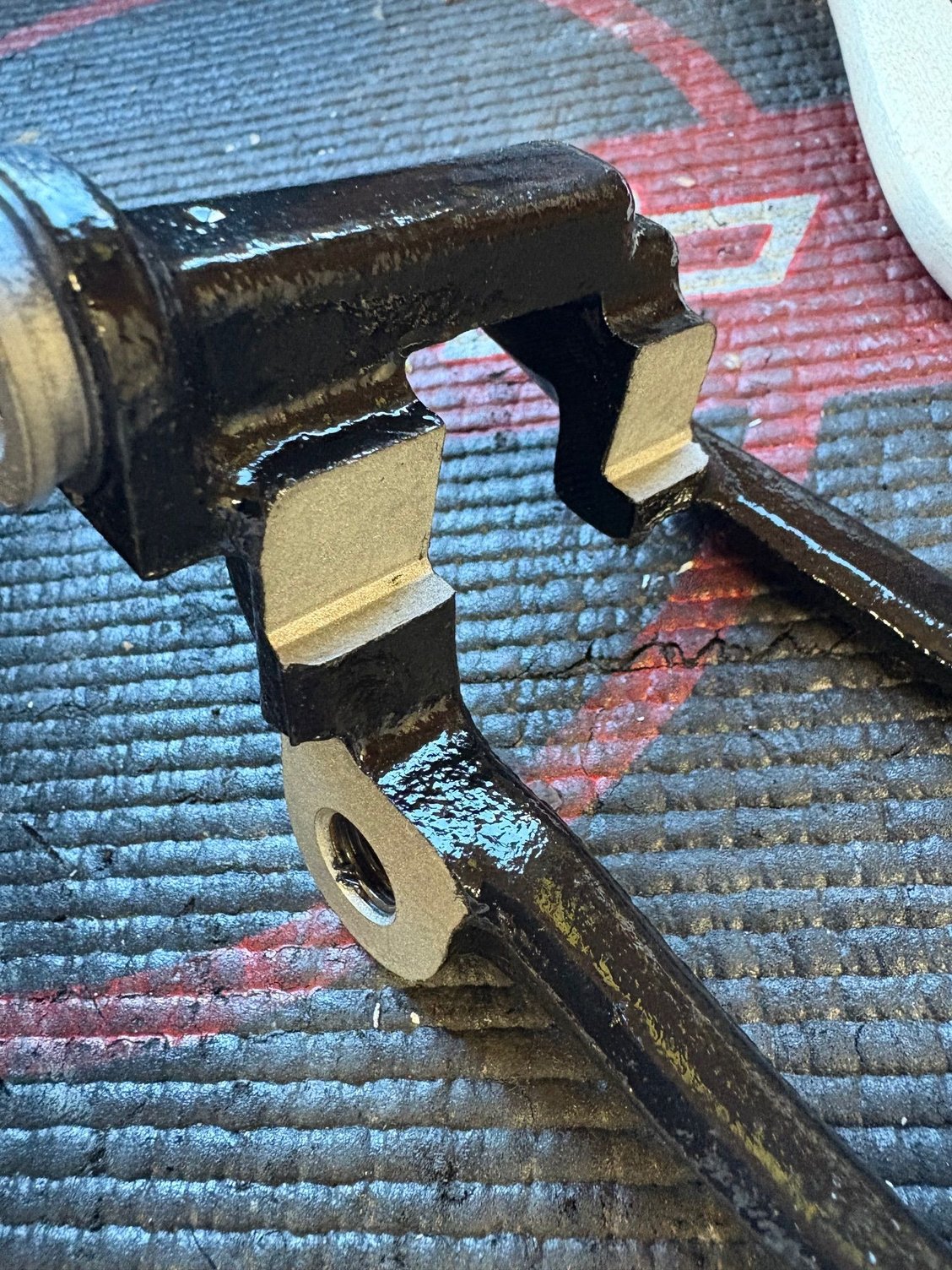

Had a little time to mess with the brackets. Used POR caliper paint. That is except with the slide areas that I hit with silver engine paint. Dan

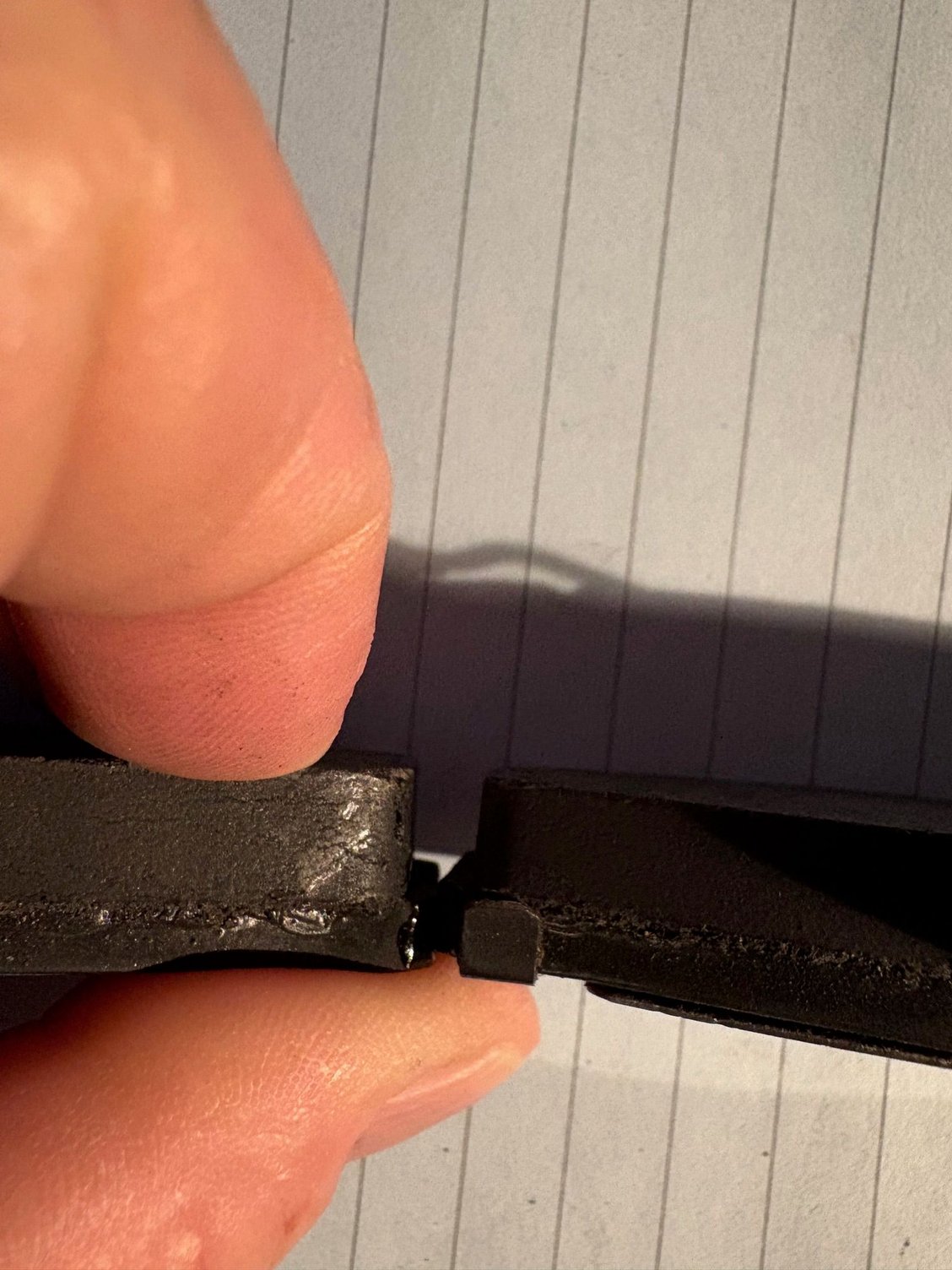

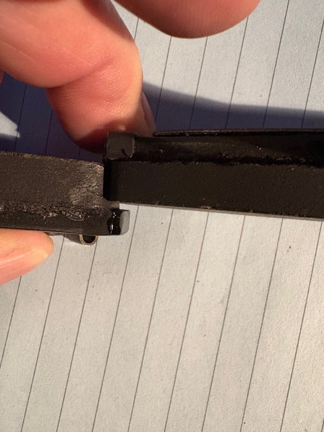

The different thickness of the pad material on the rear pads has a simple explanation. The spec for thickness for this pad is .535". The outside pad has a bonded sheet metal layer on the back that I showed in earlier photos. The pad material on the outside pad is thinner to make up for this sheet metal backing. The finish total thickness of both the inside and outside pad is the same. Dan
