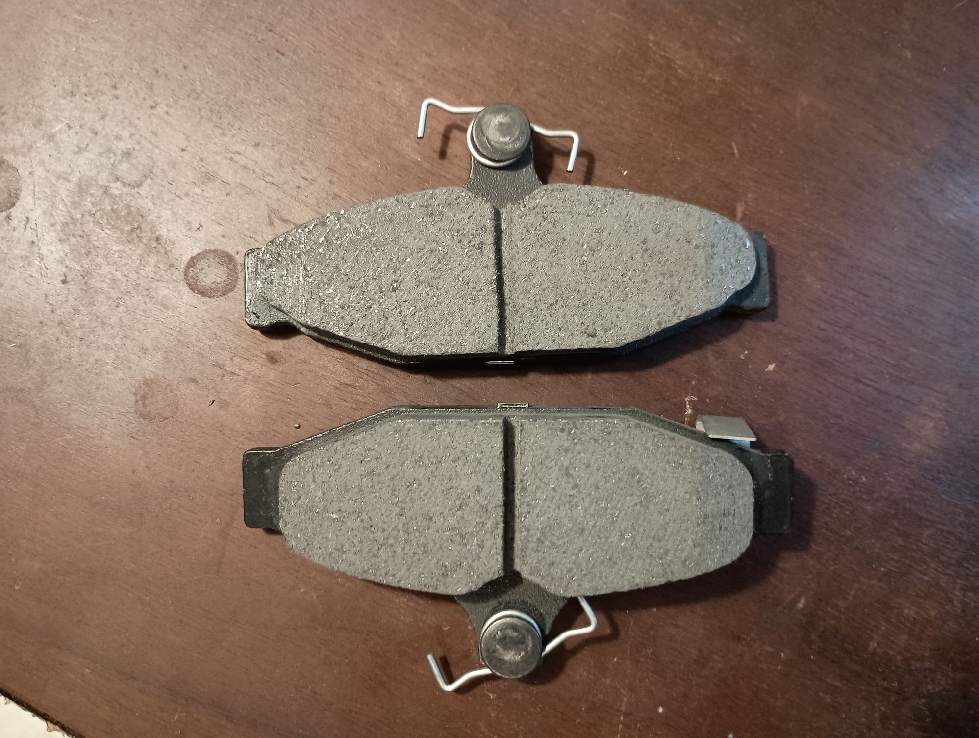

Since I had so much fun with my u-joints I decided to go through the brakes. On my 96 I had old (PO) PBR brand brake pads. On the rear the inside and outside pad are clearly different in size and shape. My new Carbotech rear pads are all the same exact size. The back side of the old PBR's are marked differently while the Carbotech's are all the same. Can anyone explain what is going on? Thanks!,

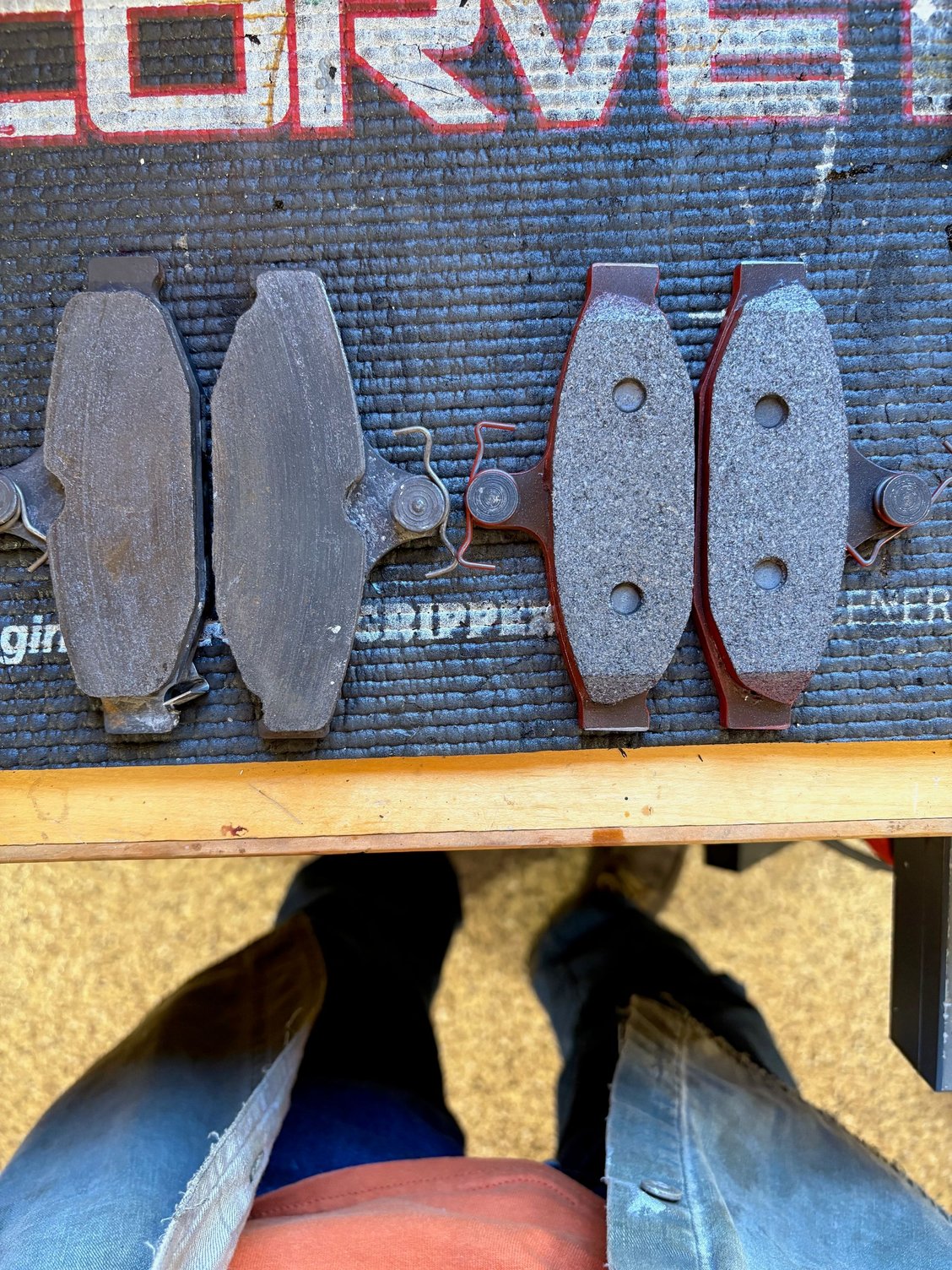

Let me ask a little less open ended question. Anyone that has done rear brake pads on a late model C4 were the inside and outside pad the same? Dan

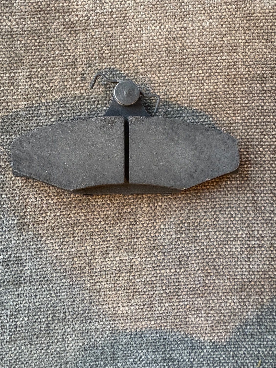

I've owned four different C4, and have never touched the rear pads on any of them. The 85 has 53xxx, and the ZR-1 had >45xxx miles and both retained their OEM pads with about 50% life remaining. The 92 has about 55xxx since the PO changed the pads, and they have about 30% life remaining. So no, I haven't had an opportunity to observe the rear pads on my C4s.
BUT. Anticipating that I would eventually need pads for the 92, months ago I purchased a set of Delco from rockauto. Your post intrigued me, so I went out to the shop and took a pic of a pair of the rears. I have no idea why the shape of the friction is different for the inner and outer, but the Delco replacements I have are the same shapes as the take-offs in your pic. I note that only one pad has a "squeaker" wear indicator, and I presume that that is the inner pad? Interesting. Cheers.
Out of the box Delco "Professional" 413 rear pad pair.

Yes, the wear indicator goes on the inside. The Carbotech's come without any wear indicator. Also, note in my picture of the Carbotech's that the rivet holes are spaced differently on each pad. I asked Carbotech about it and they said it would not make any difference. Not good for about the most expensive pads out there. Dan

I agree that differences in friction shape will not "make any difference" because the driver won't detect any differences in braking performance or characteristics because of friction shapes between pads and pad manufacturers. The rear brakes don't contribute much to overall braking anyway. The friction shape on the rear is a nothing-burger. Don't fret over it.
Regarding the rivet spacing on the Carbotechs: Are there two pads each with the different spacing? If = yes, and the rivets protrude on the backside, be sure that the rivets don't contact or interfere with the caliper casting on the outside or the piston on the inside. My guess is that the narrow spacing goes on the outside, and the wide spacing goes on the inside. Cheers.

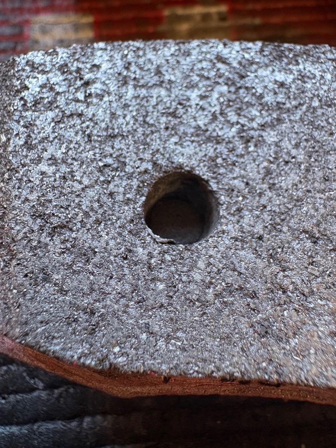

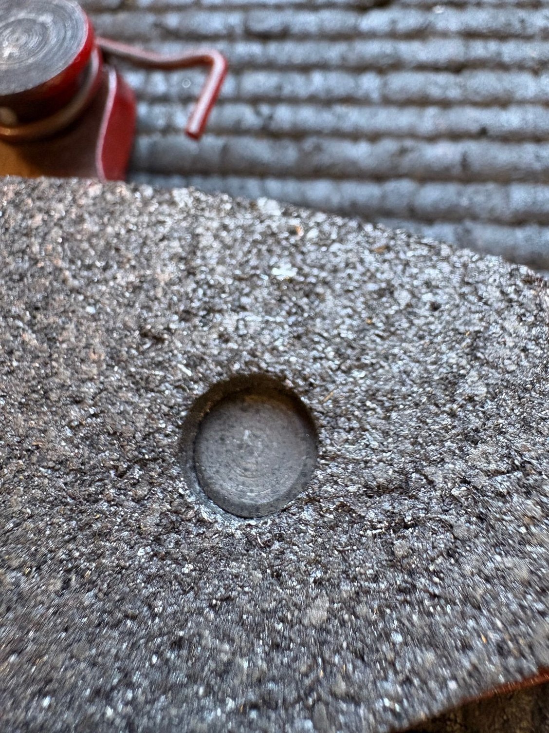

One more thing. While the front pad set has the rivet way down in a hole the rear set only has a little more than1/16" of pad wear before I am down to the rivet. This can't be right. Dan

Of the four pads 3 have narrow spacing and only one has the wide spacing. Carbotech said the plate must have shifted when being drilled but it would have to have shifted twice. I am waiting for Carbotech to get back about the rivets not being deep. Dan

It isn't. That's a QC issue. That pad should have been rejected at the first inspection station. For the price, it should have gone straight to the reject bin, not out the door.

The head tech man at Carbotech said the rivet is correct. He said it is the same rivet depth as the stock pads. I have never seen stock pads. Did they really have rivets and was the depth of the rivet really just 1/16"? I am returning all the Carbotech pads. I just checked and the Porterfield's do NOT use any rivets. Dan

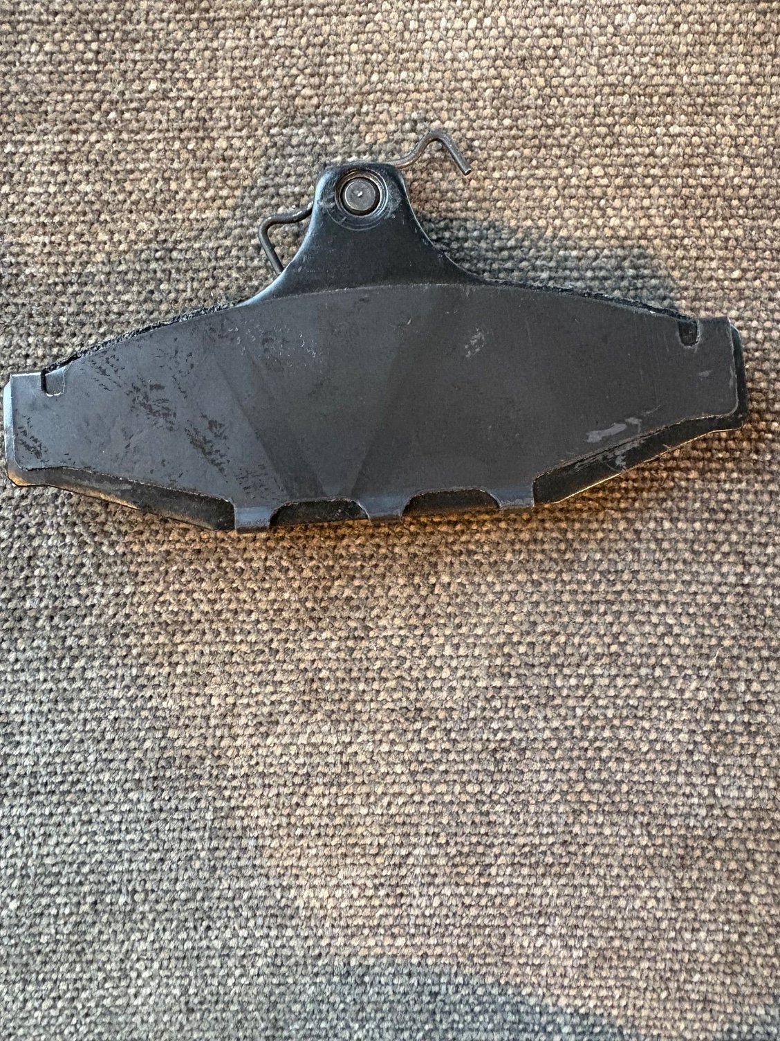

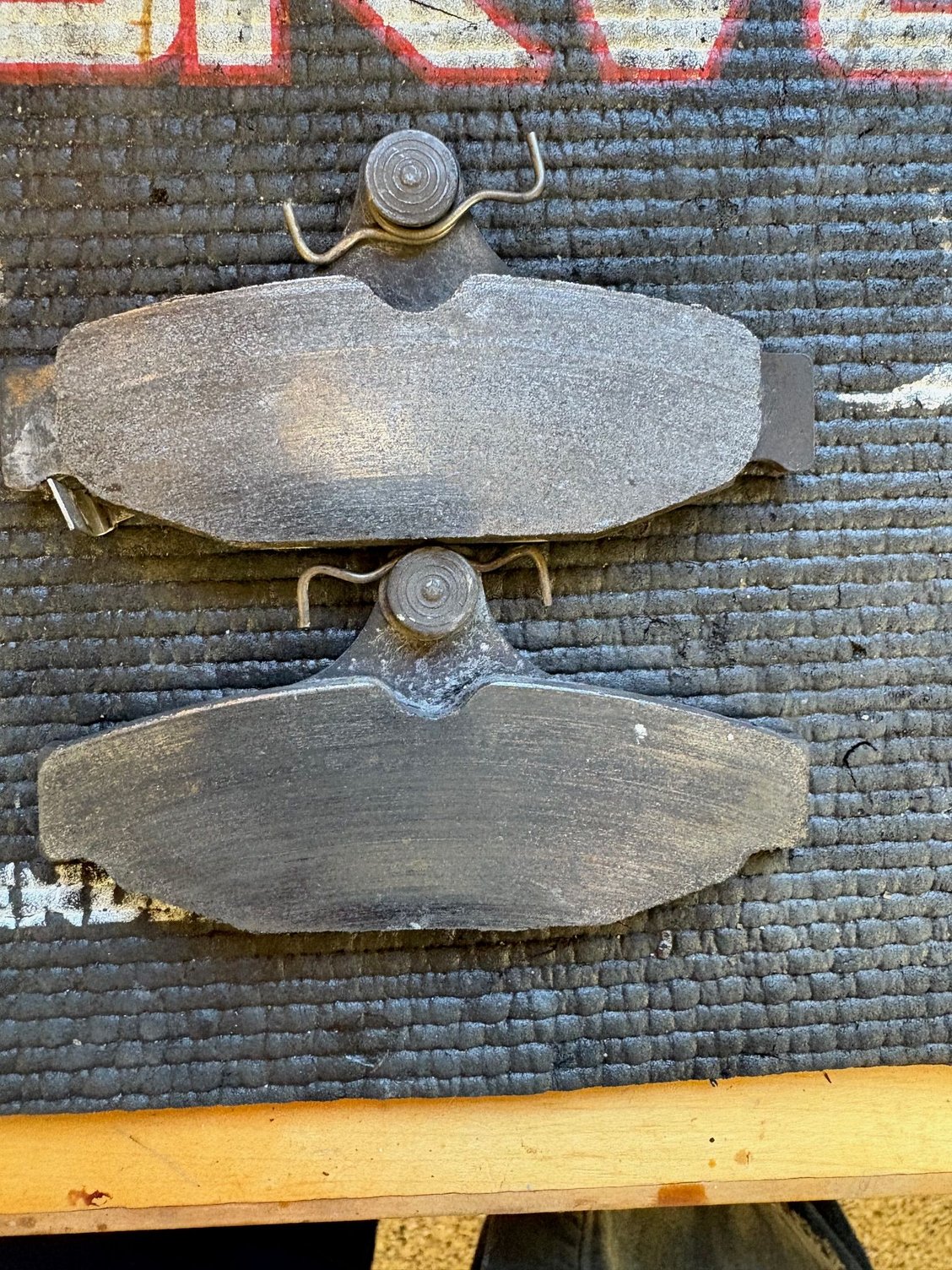

Well, I got my new Porterfield pads today. What a difference. Where the metal part of the pad is painted it looks like some kind of tough powdercoat, The Carbotechs are just painted red with a spray can getting overspray on the sides of the pad. It chipped up just during the shipping, Here is the front side of the front pad. It shows the wear indicator the Carbotech did not have one.
The back of the front pads have a ribbed rubber membrane covering most of the back side. The Carbotech was just metal. The wear indicator is securely mounted.
The front side of the rear pad.

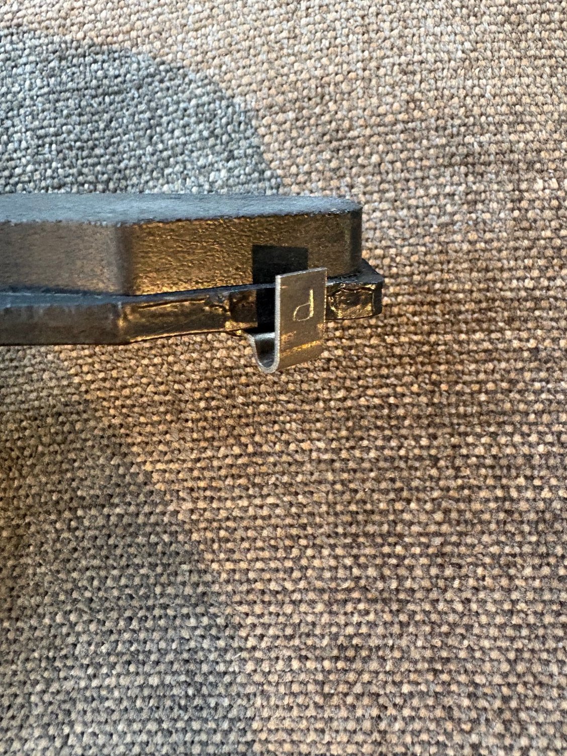

The rears also have a wear indicator that the Carbotech's did not.
The back of the rear outside pad has an extra sheet metal backing. I suspect for sound. The Carbotechs did not. The pad material on the inside pad is thicker to make up for the piece of sheet metal.
These seem like very good pads. And no rivets!! Carbotech claims that a rivet 1/16" deep on the rear pad is dictated by GM specifications. This is hard to understand as GM has not used rivets on stock pads since the 1960's. Like half a century ago. I find it hard to believe that GM would have a specification for rivet depth on aftermarket pads. Rivets were used on model A brake linings but I thought they were a thing of the past but I sure could be wrong. Thanks to IHBD for this suggestion. My Carbotech experience will cost me at least $150.00 as I have to pay shipping each way and also pay 20% restock fee. Oh well- Alls well that ends well. Thanks for reading. I forgot to mention these are $100.00 less than the Carbotechs. Dan

I'm pleased that you are pleased with the Porterfields. I didn't know about Porterfield until my friend did her research and found the recommendation for her exotic. I didn't take any pics prior to installation, but the A-M's pads had the same quality characteristics as you show and cite. I browsed through the Porterfield offerings and will probably try them on which ever personal car next needs pads. (Other than the 92 of course, as I already have them on the shelf.)
I've never seen a set of Carbotech until you posted your pics, but from your description of your Carbotechs, I won't consider them in the future. That rivet depth deal is just crappy QC, and their response is a fabricated excuse, not a bona-fide explanation.
You mention a difference in rear pad 'thickness' between the inner and outer pad. While scrutinizing the Delco's I posted pics of earlier, I noticed that the friction of the Delco inner pad was thicker, same as the Porterfields. Just for curiosity I looked up the rear pads for the 85 (84-87 C4) and they are a different P/N, but the shape of the backing and mounting is identical. I posit that the difference in OEM P/N is that the early P/N is for drum-style park brake, the later P/N is for the caliper-actuated park brake. Porterfield lists the same P/N for both C4 applications. << I'd consider this a nothing burger.
After you get them bedded and have driven it for awhile, please report back with your evaluation of the Porterfields. Are you also replacing the rotors, or re-using the existing?
