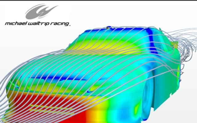

this is easy to answer as it’s a basic car aero discussion. Do you know why NASCAR had an opening at the base of the windshield for filling the airbox? It’s because that’s a high pressure area and also compared to under the hood. Meaning air would flow in reverse.

Anyway the cowl itself is perhaps producing a little bit of lift as the air acclerating over the hump increases negative pressure (not too bad a place to put a vent like some of the C3's have done), but it's the windshield intersection should be your focus, not the cowl itself. That area is not doing what you think it's doing. Take a look at a spoiler in the rear... air sees this change in angle the same as a windshield. What if you put a big vent at the base, would it increase downforce or decrease downforce? Is the air pressure high where the spoiler meets the decklid?

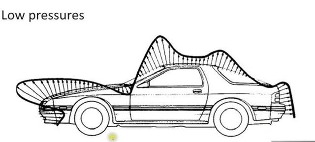

Yeah it’s a very interesting subject… with regard to placement of the vents… we haven’t even talked about how the vents in the rear would likely reduce the huge lift gradient on the top of the car.
think of it as high pressure on top compared to the bottom, means more downforce… low pressure up on top compared to the bottom means more lift.
If you put a huge cowl on the front, the leading edge transition, especially if it has a smooth scalloped shape, may provide an added high pressure area.
the top of the cowl, or the top of the hood, or the top of the roof, has a rounded area that really pumps a lot of lift or suction from the airflow. Placing a vent or air exhaust/extraction on any of these areas will usually reduce the lift… generally speaking. So you can design a cowl that adds pressure at the front, and exhausts pressure on top, and inducts pressure for the engine intake at the end, this can all be good.
at the back end of the hood or cowl, air pacs into the scallop at the windshield and creates high pressure that is probably just a fraction of the lift that the hood creates, but because it’s high, it’s a perfect place for induction, and poor place for extraction (the original idea presented).
