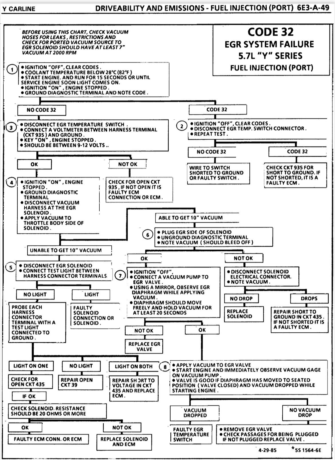

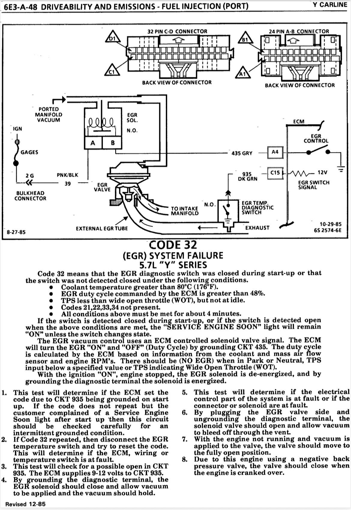

Thank you I will look at the TPS. I just ran diagnostics on her and code 32 was the only one being thrown. That's for the EGR, which is brand new, done at a shop.

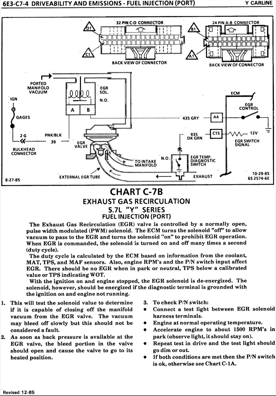

Code 32 could definitely be the problem.
There should be no EGR during idle, so if it is allowing exhaust gas in during idle, stalling is possible.
Here is some info from my 86, not sure what difference to 85.
To C4 warm Idle issue
