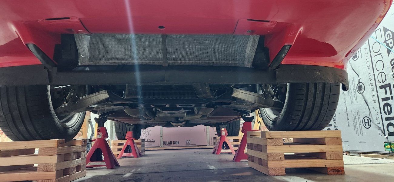

Take a picture of the air dam area and let us see what it looks like.
I installed fine mesh aluminum window screen to keep out all but the smallest debris. i pick off by hand the larger debris it stops and routinely vacuum out dust. Much of what plugs the condensor and radiator is the accumulation of dust and less than pinhead size rocks. My factory radiator bears such testimony.
I'd seen you post a different photo of how you did that but I couldn't tell much from it.
This is a much better photo and I can see what you did there in this one.
That'll certainly kep a lot of debris out, but I wonder if it'll also impede air flow, too. And likely to get just as clogged up.
It's something you'll have to look at once in a while, depending how often you drive it.
