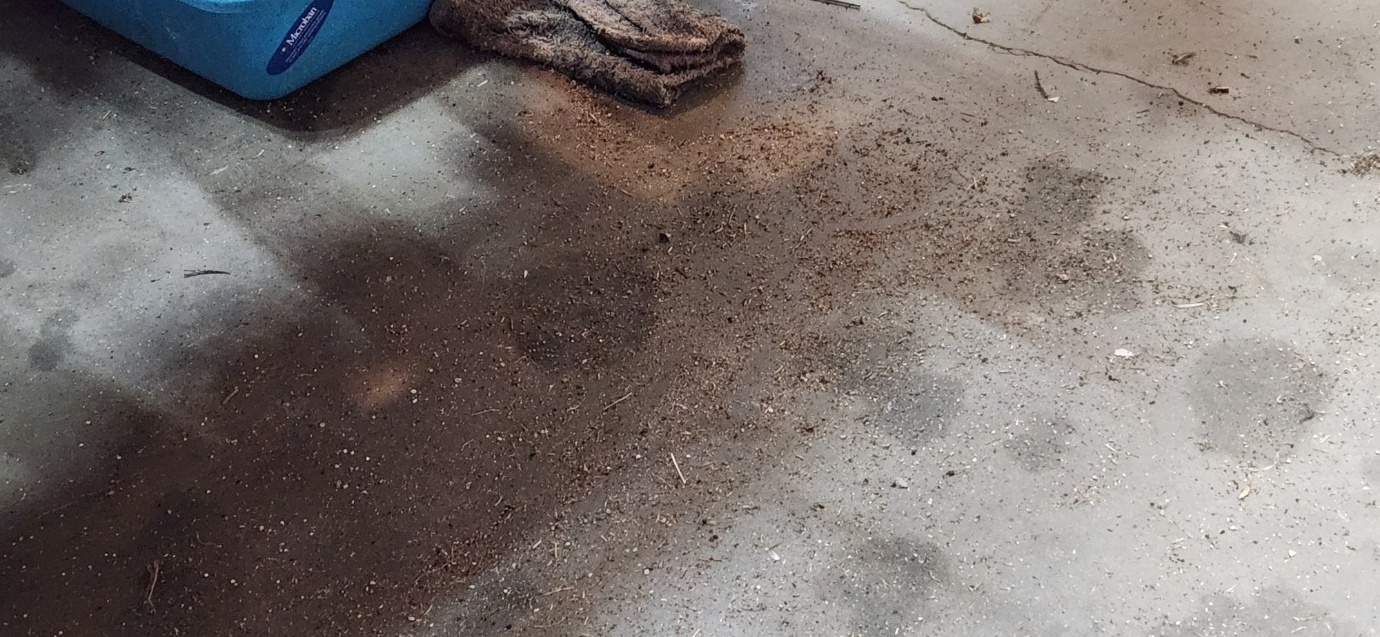

@llapine The method you employed will not remove debris packed between fins. The debris you see in pics is what compressed air with a long wand blew out. from my 94's radiator Even still, after the blow out, between 1/4 - 1/3 of radiator was so blocked that the sun could not shine through.
