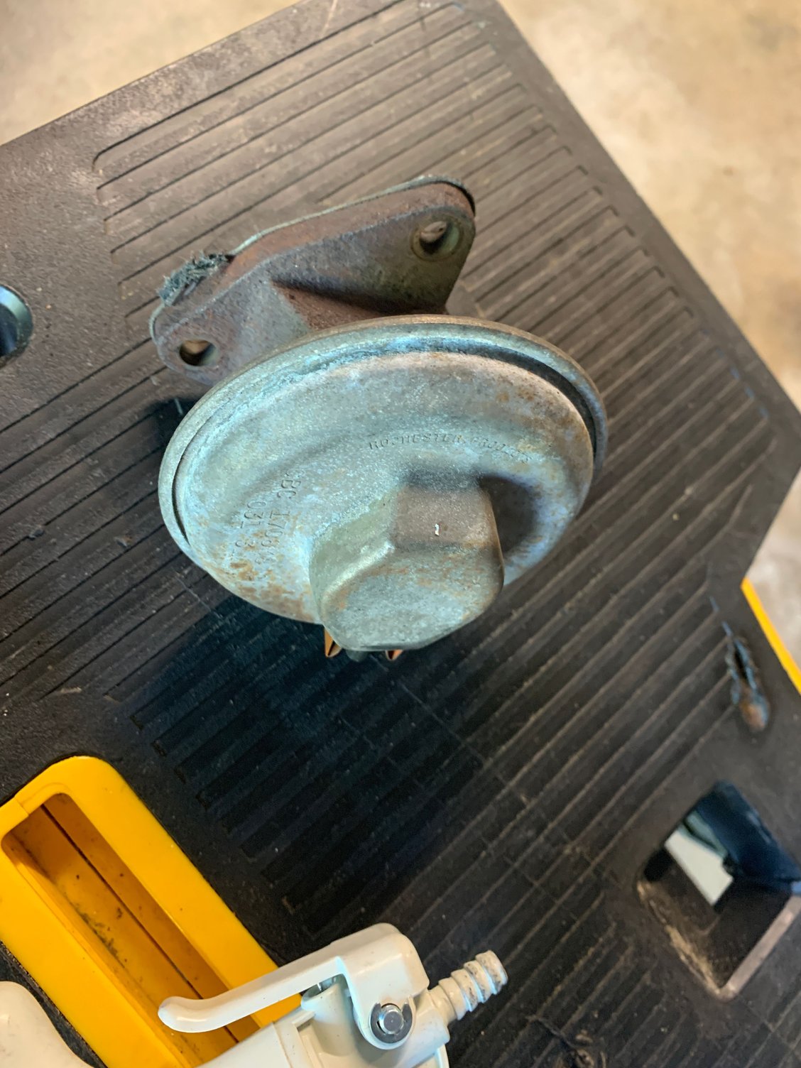

I kept the EGR valve on my '84 because it was easy to replace. My understanding is that it helps keep combustion chamber temps lower at partial throttle but stays closed at idle and WOT. It also keeps Nox levels lower if you are inclined to reduce smog levels in your neighborhood. It also keeps the original appearance if resale later on is important.
A new EGR valve and CTS sensor has worked wonders at keeping mine running well. I was having idle and throttle tip in issues that are now gone.
Another forum member confirmed this was the original valve from 1983 build date. I could barely move it by hand.

ive been considering that too, I appreciate that advice! And thats pretty sweet to have the original!
