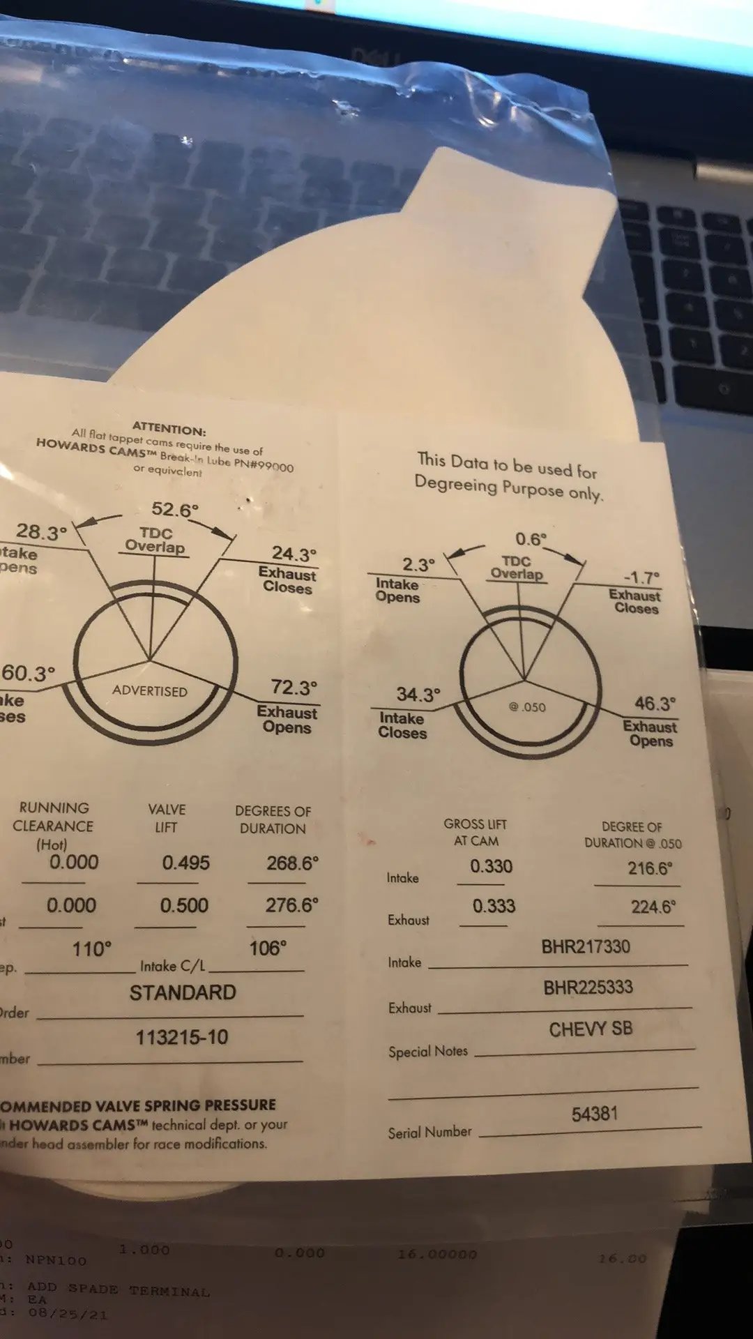

Any of the cams recommended to improve the TPI should give you an increase with the carburetor, while maintaining "street manners" or lower end torque. Many have recommended the Comp Cams 08-501-8, up to the 08-503-8. I've ordered a Howards 183215-10. I was torn between the -10 and the 183215-14.
I'm hoping the reputed torque boost of the TPI will cover any meaningful lower end loss. I went with the Howards grind as the factory gearing gives 65MPH at 1640 ish RPM.

Not really digging that Howards cam mentioned above (especially for a 2.59 gear car). With ~54 degrees of overlap: it will roughly have the low end behavior of a Comp 503 without the top end potential. At least it will sound cool.
Found this cam card:
Its actually a bit smaller than the advertised specs would imply. The earlier intake valve closing should help some.
