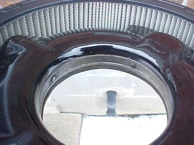

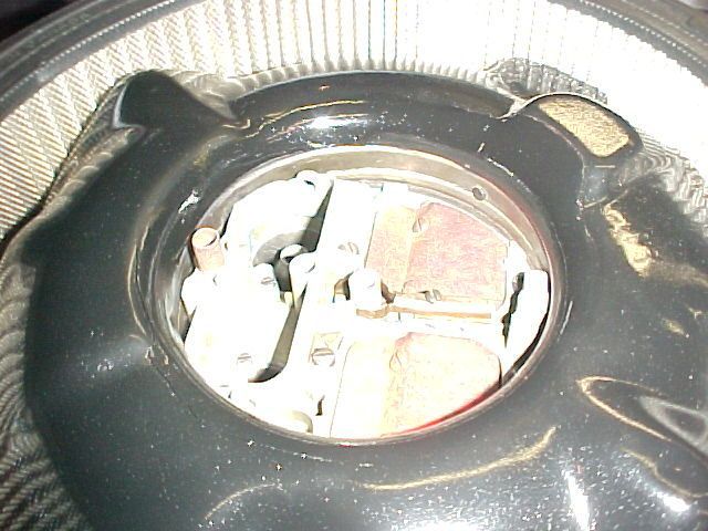

The only reason I can think of, is that his Holley's main body was replaced with a main body without a choke horn. Better air flow.
If it comes down to a new hood vs a main body change, something to think about. (Assuming you have a Holley carb)

....The only reason I can think of, is that his Holley's main body was replaced with a main body without a choke horn. Better air flow.
I was going to suggest this as well as a cleaner path into the intake. The downside is it will take some idling to warm up enough in the morning to drive the car.

I believe no power loss is from power gain due to the filter case straightening / directing air flow into the carb.
On my '59 to faciltate nice laminar ? air flow into the carb I run a 3/4" spacer attached to the GM hi-po air cleaner base and using "bondo" have made a nice radius on the air cleaner base going into the carb .

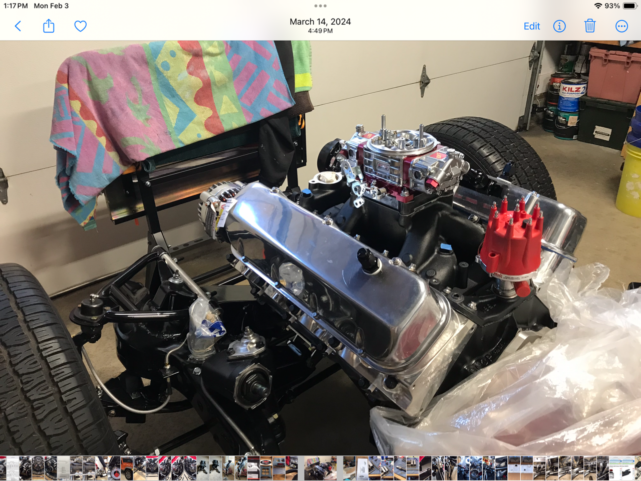

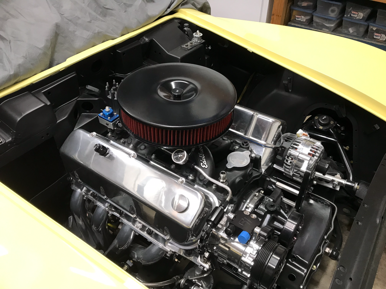

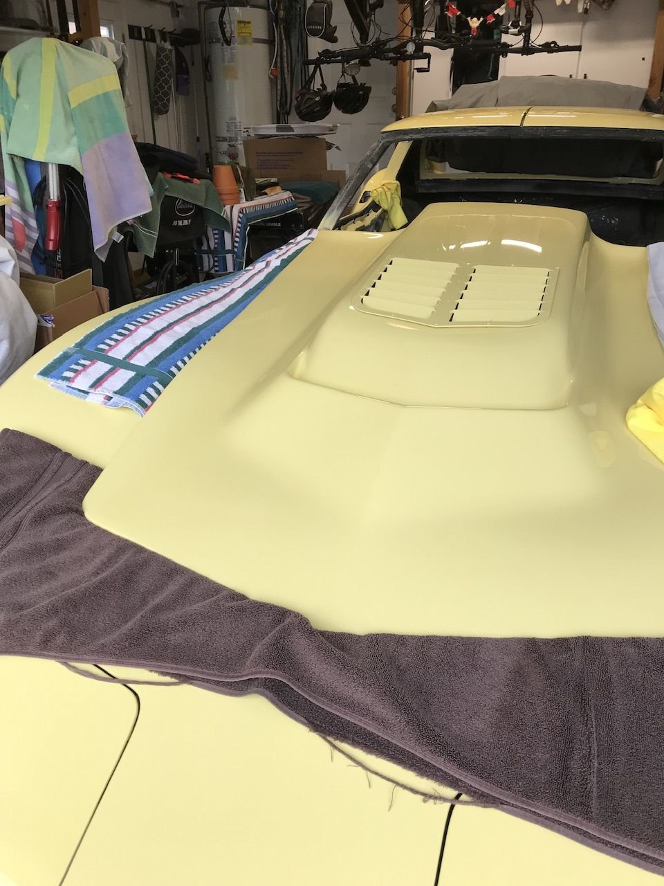

Here are some examples using pictures of my set up.
First, my mistake was to build my engine thinking that what I built would fit under my aftermarket L88 tall hood which is 1.5” taller than an oem L88 hood.
With the Air Gap, Quick Fuel 850cfm with no choke and manual secondaries, 1” carb spacer, 1.5” drop base filter, 3” element and domed lid, the hood would not close.
I have added a vent to the top of the hood that slightly reduces the clearance.
I first removed the 1” carb spacer and there was still contact between the air cleaner lid and the hood.
Secondly I swapped the domed air cleaner lid for a flat style lid, which now gives me approximately 3/4” clearance between the lid and hood with the hood in the closed position.
When I permanently install the hood, I will take an exact measurement of my clearance and if I can squeeze a taller filter in, I will, if not there are other lids designed with a slight dome that will possibly increase the space between the carb base and the air filter lid.
Then again I may do nothing because my engine is putting out more torque than I can ever use, and that little bit of loss won’t make any real difference.
I have solid motor mounts so my motor won’t have much if any movement under the hood, but you’ll need to leave some gap so the air cleaner doesn’t contact the hood.
Moral of this story, don’t build your engine thinking I can just replace or modify the hood and all will be good.
