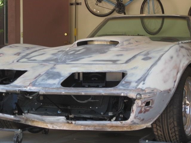

Perhaps a simple scoop glassed/glued on will do the job?
Old Feb 4, 2025 | 12:58 AM
caskiguy's Avatar
caskiguy
Joined: Nov 2016
Posts: 9,240
Likes: 943
From: Lake Tahoe, CA
Taijutsu may be thinking of this.
I may choose to go this route with a scoop fiberglassed in on my 70'.
Old Feb 4, 2025 | 09:30 AM
Taijutsu's Avatar
Taijutsu
Joined: Apr 2002
Posts: 1,736
Likes: 37
From: Stockton Ca
Perfect!
How much money and time?

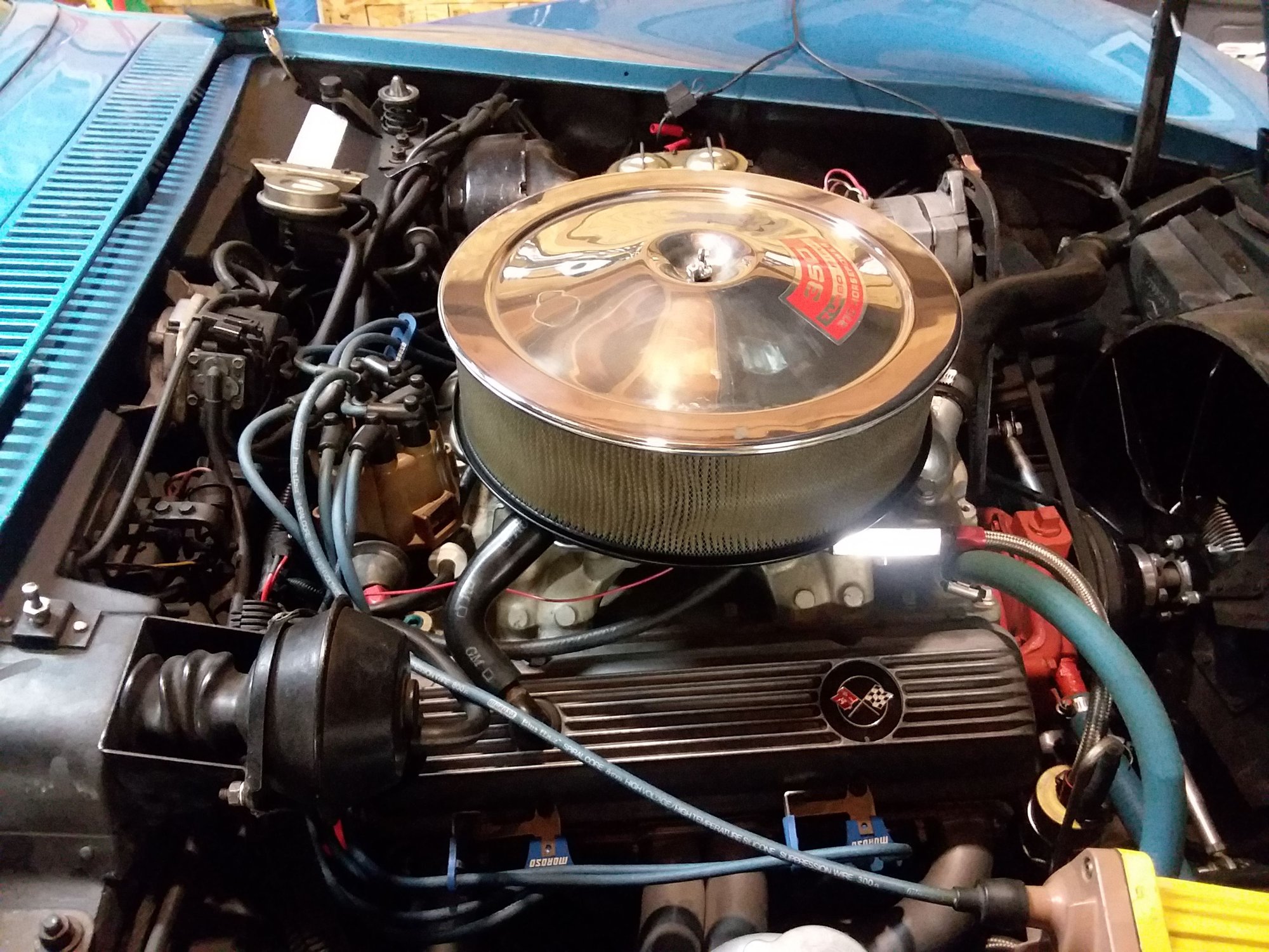

Factory drop base, RPM Air Gap, 1/2" spacer, 4" filter, L88 hood.
Hey Mel,
Is that lid, steel or aluminum?
Looks really nice!
Old Feb 4, 2025 | 02:03 PM
MelWff's Avatar
MelWff
Posts: 18,695
Likes: 2,572
Hey Mel,
Looks really nice!
Stock steel cover

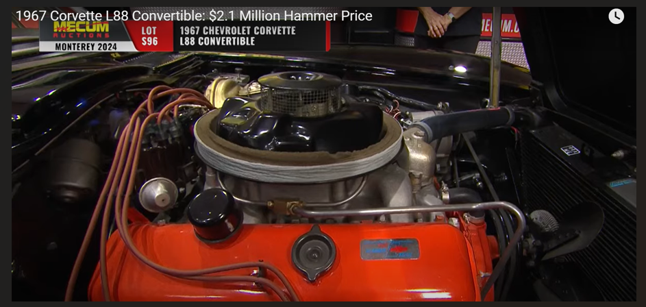

Pic of a $2.1M 1 of 20 1967 L88 with D.P. carb and crankcase  filter on valve cover, no pipe.
Engine Pic of a $2.1M 1 of 20 1967 L88 with D.P. carb and crankcase filter on valve cover, no pipe. No AIR pump. No vac can.
Same car with pre-emissions road draft tube on left side.
Same car with pre-emissions road draft tube on left side. No AIR pump either.
