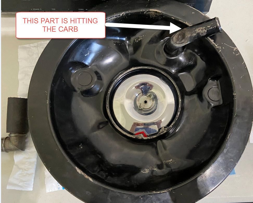

It is only the air pipe that is an issue.
The rest of the base is the same.
If you do not mind "messing" around with that a little bit, these two versions are in stock at ZIP.

Just found this.
Typical air pipe modification to fit a double pumper.
Cutting it and welding in a flat angled piece would be so much neater....just sayin'

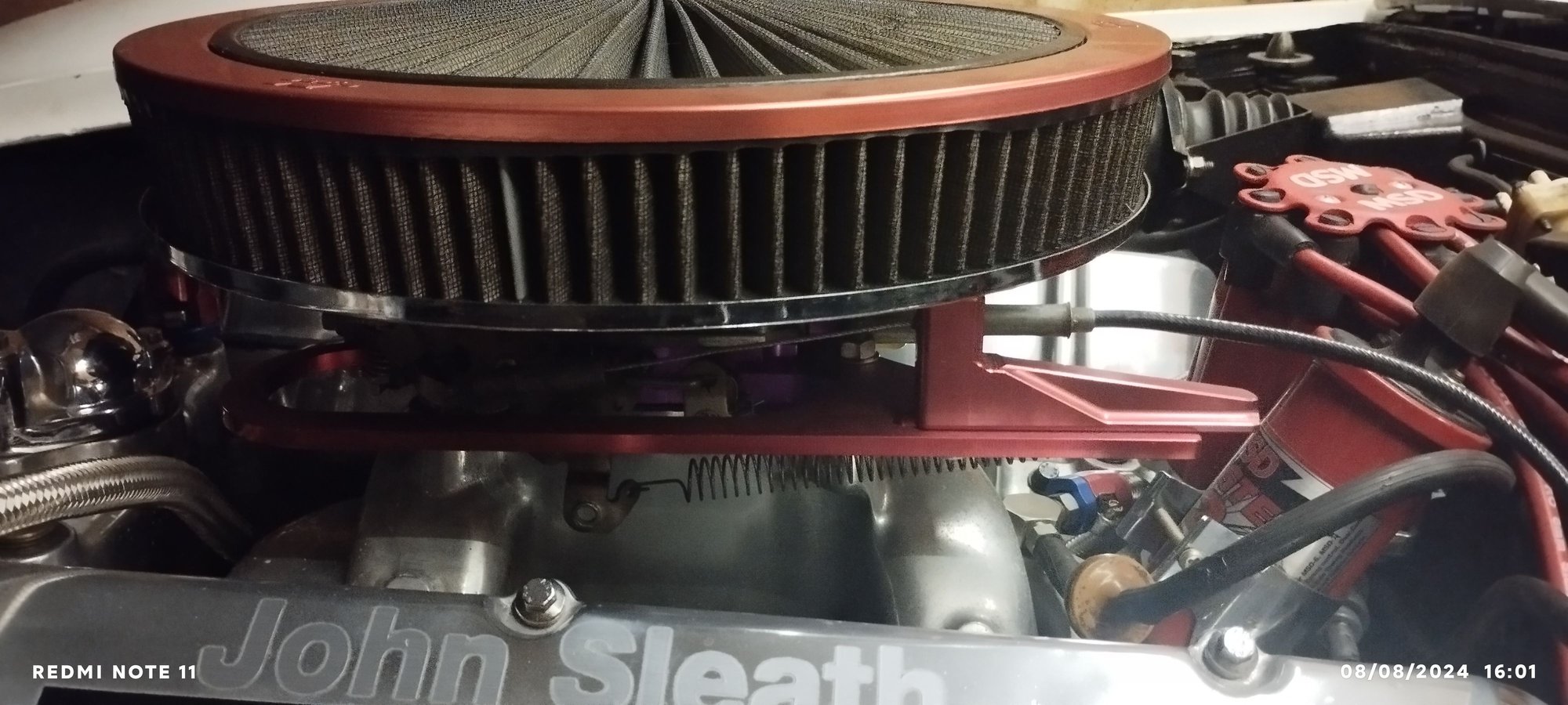

That's interesting Lars - when swapping over to the Air Gap inlet on my BB '68 due to difficulties with the stock gas pedal linkage/cable/carb bracketing I was forced to use an aftermarket 'billet' carb bracket with the generic Holley DP the installed. That meant changing the stock drop base filter (L36 engine) to a lower 'drop' aftermarket base (this still has a 'contoured' shape like the stock base.... just not so low). The issue then (and even with a repro L88 style hood) was that a stock 3" filter element and filter top were too tall to fit under the hood. I simply changed the filter to a 2" K & N Airstream filter 'top'. The L88 hood is open at the rear. Filter top to hood clearance is perhaps 1/4"/3/8" at the front and 3/4"/1" at the rear. The K & N filter certainly appears to be really unrestrictive........I presumed the losses from changing to a 2" vs stock 3" element would have more than compensated for when using the K & N 'top.....
but your comments re. the height of the stock 'domed' air filter top make me wonder about the efficiency of my installation?

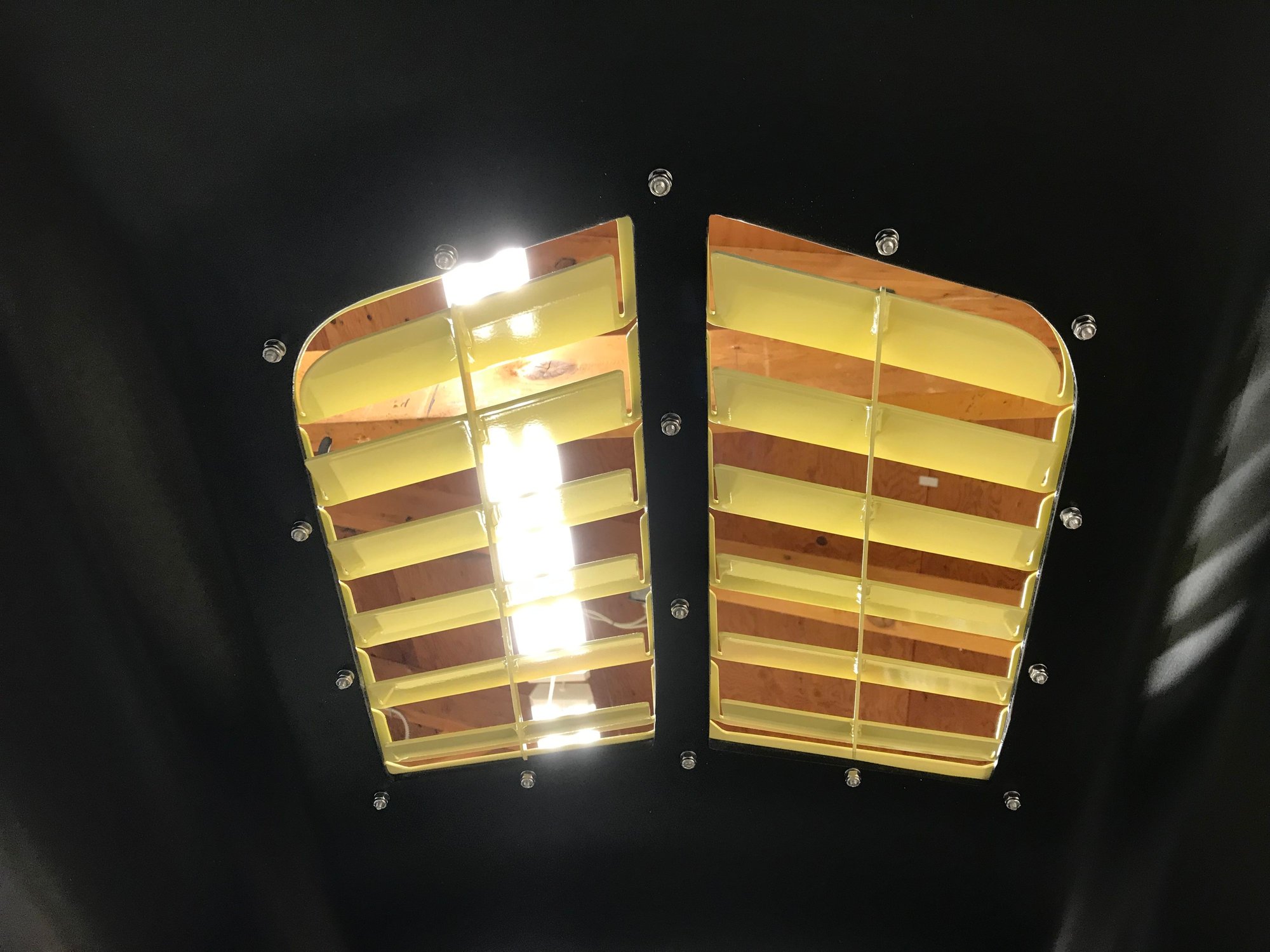

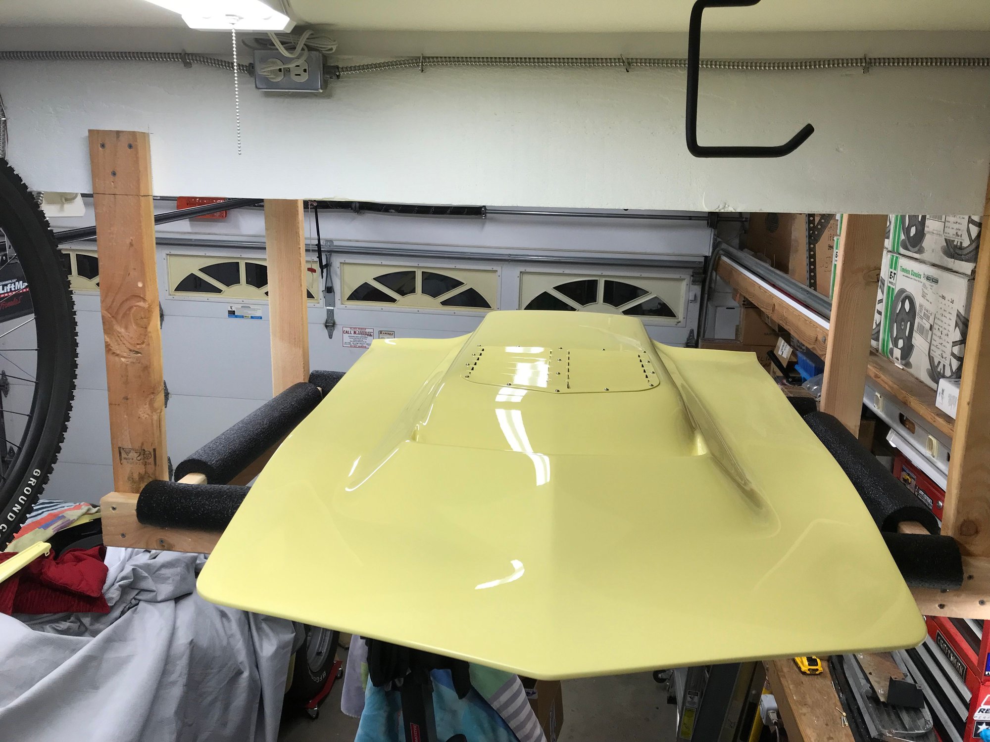

I have been using a complete factory L88 Hood and the Wedding Cake Assembly that was made to use with the L88 Hood for decades. The hood has an air box attached to the bottom of it and this has a hole directly over the carburetor. My 427 has a Edelbrock Performer RPM Air Gap intake with a Holley 850 on top of it. Using the foam seals for the wedding cake, the hood actually seals quite effectively. This is something that allows the pressurized air to come in from the base of the windshield and then it turns down and goes straight into the carburetor. There is not much as far as air filtration so I use the foam air filter and oil it like a lawn mower air filter. Then I put a K&N Filter "Cover" over the larger screen and that does a fairly good job. This keeps the moths, butterflies and firefly's out of the carburetor for the most part... While cruising the air going into the throttle body is very close to ambient temperature and this is critical to using a high compression engine year round.
The L88 hood does offer more room for tall intakes, but that is NOT what makes it such a great part to use. The reason they made that hood like it is was so they could get Cooler Air into the engine making it tolerate the high compression reducing or eliminating detonation. That makes this hood really special and very valuable for anybody running the 12.5-1 compression of an L88 engine. This hood helps the high compression L88 engine work on the streets and making it more drive-able and useful. I drive my 12.25-1 compression Corvette on the roads regularly and use 93 octane fuel with little to no problems. When my engine gets really hot I activate the water/methanol injection system and this pulls the temperatures down quickly (as the water/steam evaporates) and gives the engine 116 octane fuel.
All of this is possible because the of the cooler intake air getting down the throat of the carburetor and making power without detonating. This is one of the best cold air intakes used on a factory stock Corvette. Between the few air flow restrictions and the hungry engine, the sound of that engine opening up with all of the air being pulled from the hole on the back of the hood is awesome.
As far as the drop bases go I use the one with the breather "tube" sticking out. A "screen cap" goes over the hole and the breather pushes any waste air into the intake air flow so it will be burned. This breather tube is not a bad thing and looks great when used with the silver screen over the drop base.
Today I have a Holley Stealth Sniper EFI system on top of the Edelbrock Performer Air Gap Intake. It is tall but the hood with the air-box will close over the top even with the tall Stealth Sniper Throttle body. Next will be a multi-port intake and a dry throttle body using a Holley Terminator. This will make more room and make the engine even easier to live with.
The Drop Base that was designed for the Corvettes has the notch in it for aligning the Holley carburetor base. It did not work with my Edelbrock carburetors as it would not fit over the carburetor. The factory drop base fits over a Holley Dbl pumper or a Holley Vacuum Secondary and looks like they made it to just that. It worked well for my Holley Double Pumper as it will for a Vacuum secondary carburetor. Since I don't use vacuum secondaries I am not positive it will fit but knowing GM it most likely will.
I ran one of these for a while too and never noticed any issues because I dont race the car. In the engine masters showdown though they show that the air coming in from the top interferes with the air coing in from the sides and causes a lot of turbulence which in the end makes this filter perform worse than the cheapest no name chrome/paper 14 inch filters out there I now you dont want to hear this as I didnt either and used it for similiar reasons as you chose it but the testing was pretty conclusive. I have the misfortune of not checking my aces killshot throttle body for clearence till aftr I purchased and found I cant run any type of drop base which puts me in a quandry with my drop base cold air intake.
I 'hear' and understand what you are saying - the thought that originally went through my mind using the K & N Filter top was that it 'visually' would appear to flow more air than the 2" reduced height filter (that I had swapped-out from the stock 3"). Part of that logic was that even though the K & N filter top was quite close to the underside of the L88 style hood....with the K & N's relatively open filtering material it would improved 'breathing'. I did draw-up some plans to fabricate an air box to encapsulate the carb and draw cool air from the rear (bit didn't get around to it). I might look at an alternative to the 'billet' throttle bracket and re-use the stock OEM drop-base and re-gain the lost 1" height.

If you are going to go that much work why don't you buy the the air-box made for the original L88 hoods? My hood came with the air-box attached and it seals very tightly around the throttle body keeping the combustion air even cooler.
I have seen people that sell aftermarket L88 hoods selling the lower air-box part that you can attach yourself. It is already shaped to fit and it really works with the L88 hood which might make it the easiest option available. It is not that heavy or even big so it could be shipped to you in England.
When you have the wedding cake assembly on top of the drop base the carburetor has a small cover that goes over a round screened piece that keeps big stuff out of the carburetor. On my engine when the hood is closed that lid is almost touching the hood above it. This allows the air to enter the carburetor and turn downward in to the combustion process with great ease and a high flow rate. This system is very simple if you have the room to use it. I put a spare SB in my C3 while I spent almost a year re-building the 427. The L88 hood worked even with a SB as long as you made the parts fit by using spacers.
Air filtration using the complete L88 hood can be difficult. I have the large screen above in the hood like they used from the factory. I wish they made a nice K&N filter that would fit up there but it would be very hard to install and maintain. If you could filter the air as it comes into the hood opening, that would be great but restrictive. I use the K&N "outerwear", it is like a tightly woven fabric that goes around the outside of an air filter and keeps the stuff out of the carburetor. I have one in the hood around the (oiled) foam element and another for around the little round screen inside.
Currently I have a Holley Stealth Sniper EFI system on my C3 and it works okay with the L88 hood but it is tight. I am using the Edelbrock Performer RPM Air Gap intake on my 427 as well and it is just too tall for everyday usage as it touches the hood. I am planning on going to a single plane Holley Intake with a dry throttle body using a Holley Terminator EFI Controller. This will open the space up and make the intake system a bit shorter.
The Stealth Sniper does work well with the 427. I love how it looks like a carburetor and it could fool many IF it didn't say EFI on the sides. The Stealth Sniper sits on the engine like a carburetor where the Sniper has the throttle body turned 90*.
Cool air and cooler fuel will help any BB make lots more horsepower. I wish you the very best in your effort to make the Corvette even cooler than it was when new!
