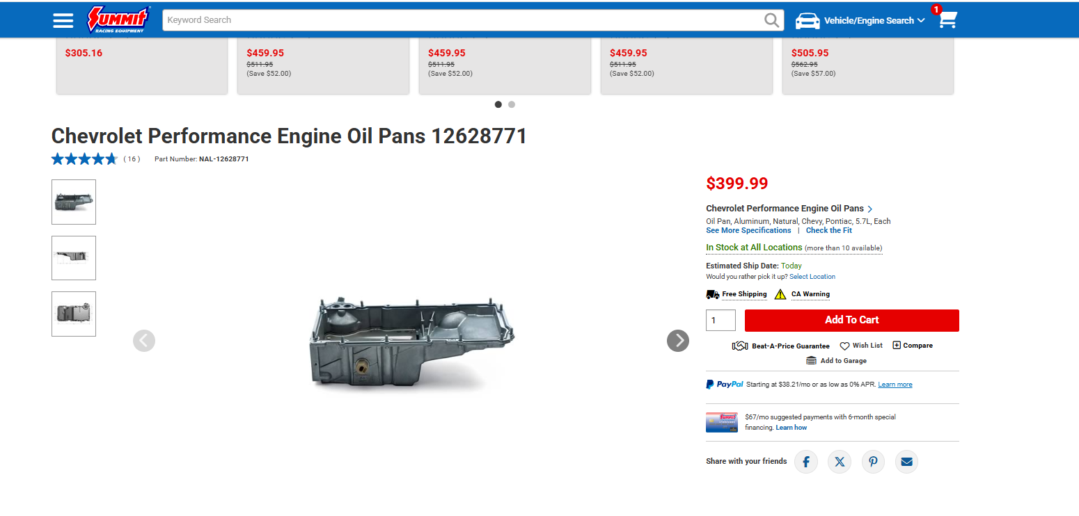

1998 through 2002 4th gen camaro oil pan. Also the 525 HP crate engine oil pans will work, assuming they are the correct casting number as the camaro pan.
