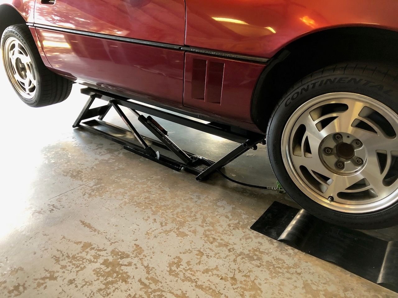

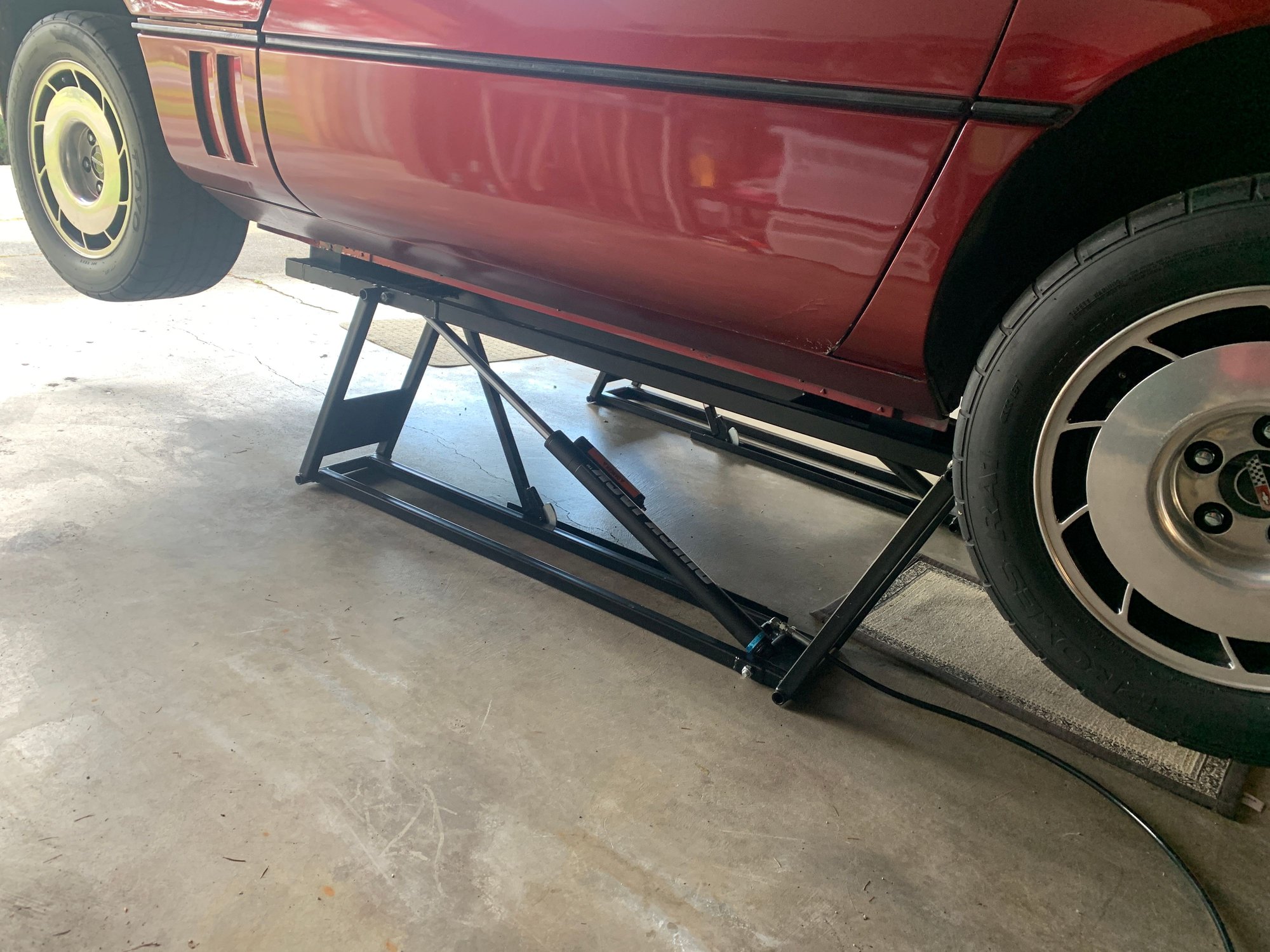

Originally Posted by BET VETTE
can that lift the almost fragile underside of the c4 safely
Yes, it lifts from the four jacking points. Dan

Which model is the one in the picture
6000TL. Dan
6000TL 6,000-lb. Portable Car Lift Standard Frame Most Popular Model | QuickJack

Are there any other items you need to operate that lift
You have to buy 3 or 4 quarts of ATF or hydraulic fluid. I am not at home and I don't remember the specs but it is easy to find and the type is in the owners manual. You need a 110 outlet. Dan

I agree. If you can afford them, QuickJacks are the way to go. Plenty of clearance for most underside jobs, safe.

What I like about my Quickjack 6000Tl is it goes a few inches higher than the older standard 5000 model. Also, you can take all 4 wheels off at once. I will say that at 74 I have lost some strength and reinstalling the wheels while the car is higher is harder. Next time I will lower it way down before reinstalling the wheels. Dan

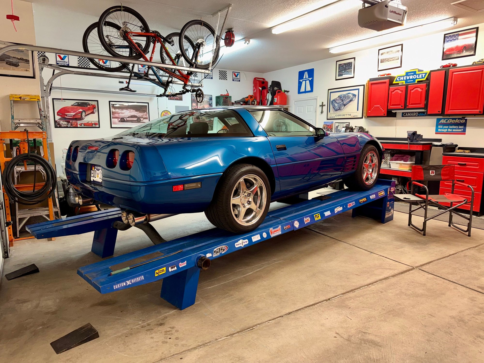

This is also an easy way,,,,

Nice looking car, and how do you like that kwik-lift?
