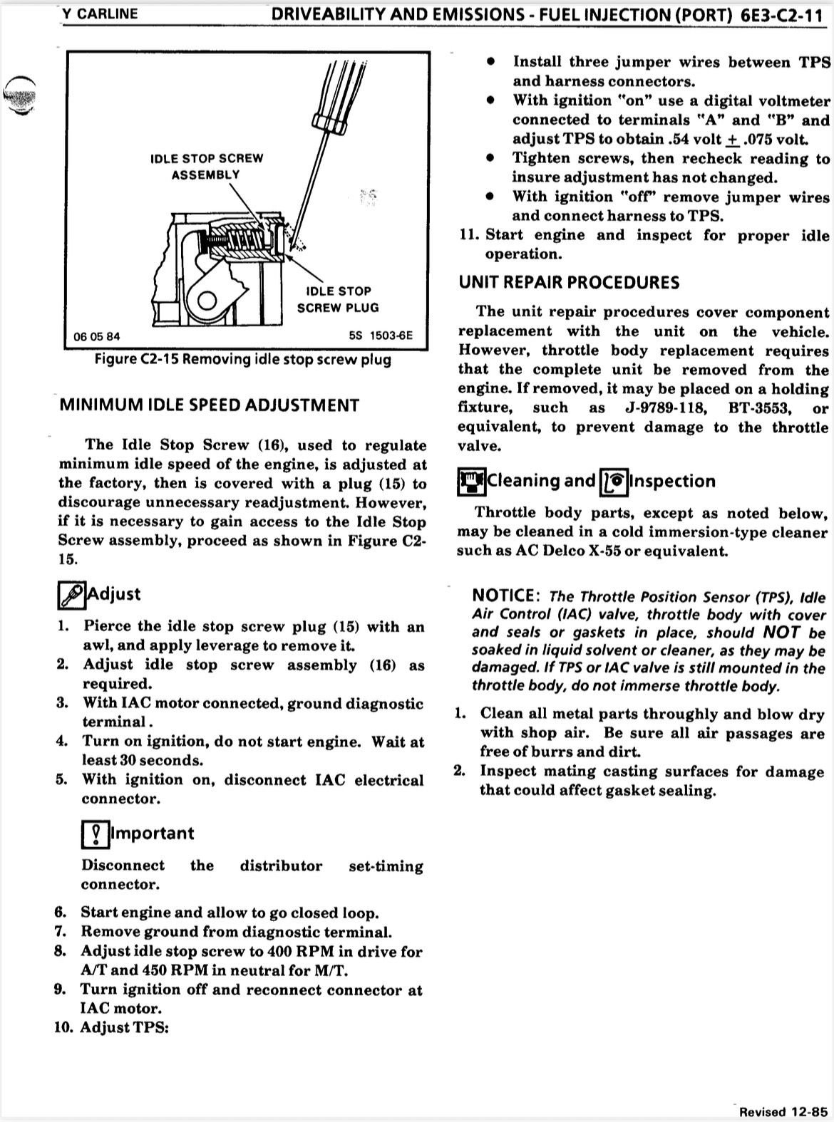

Possibly your minimum idle is set too low. You may want to check your timing and then reset minimum idle and reset TPS voltage.
