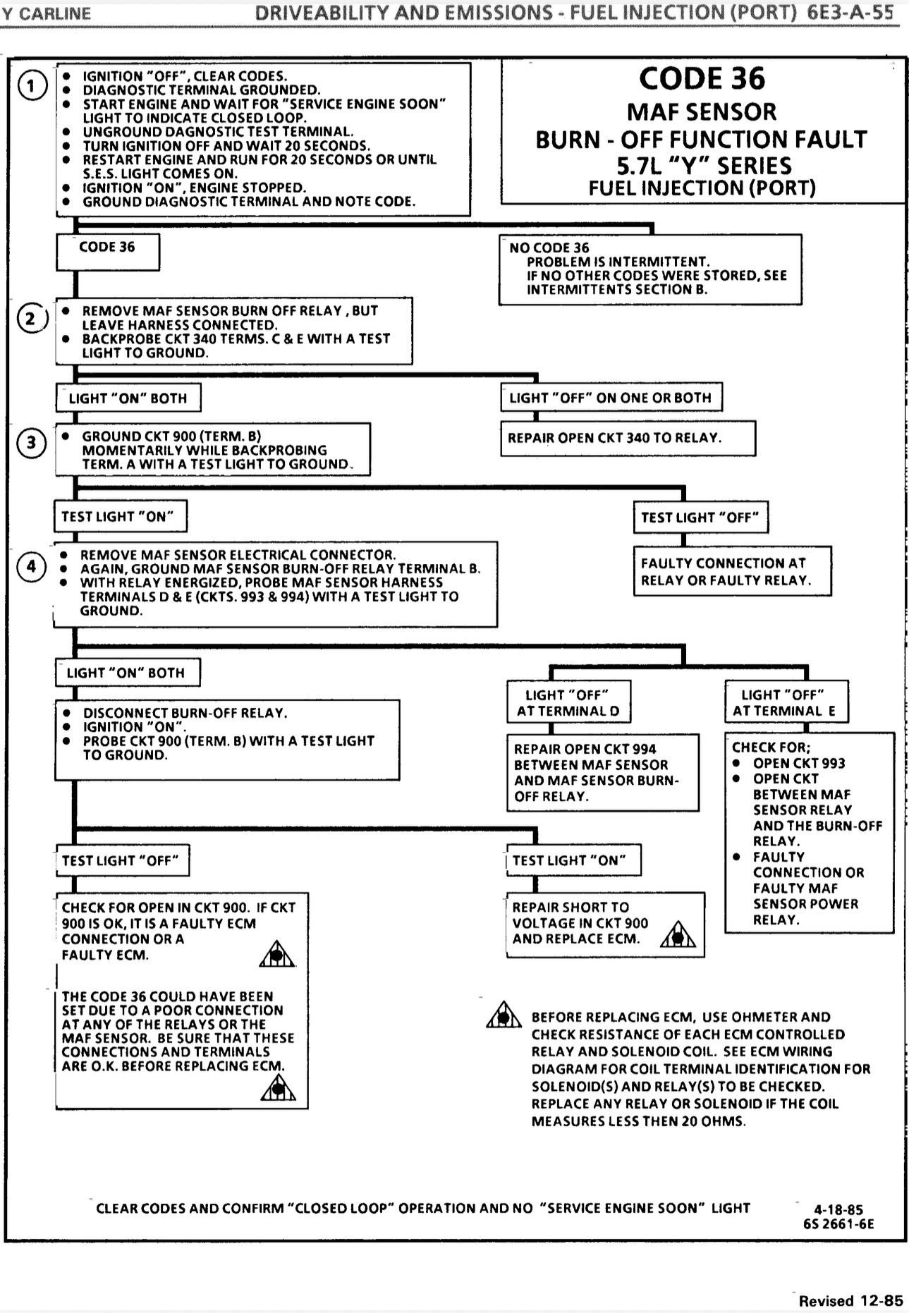

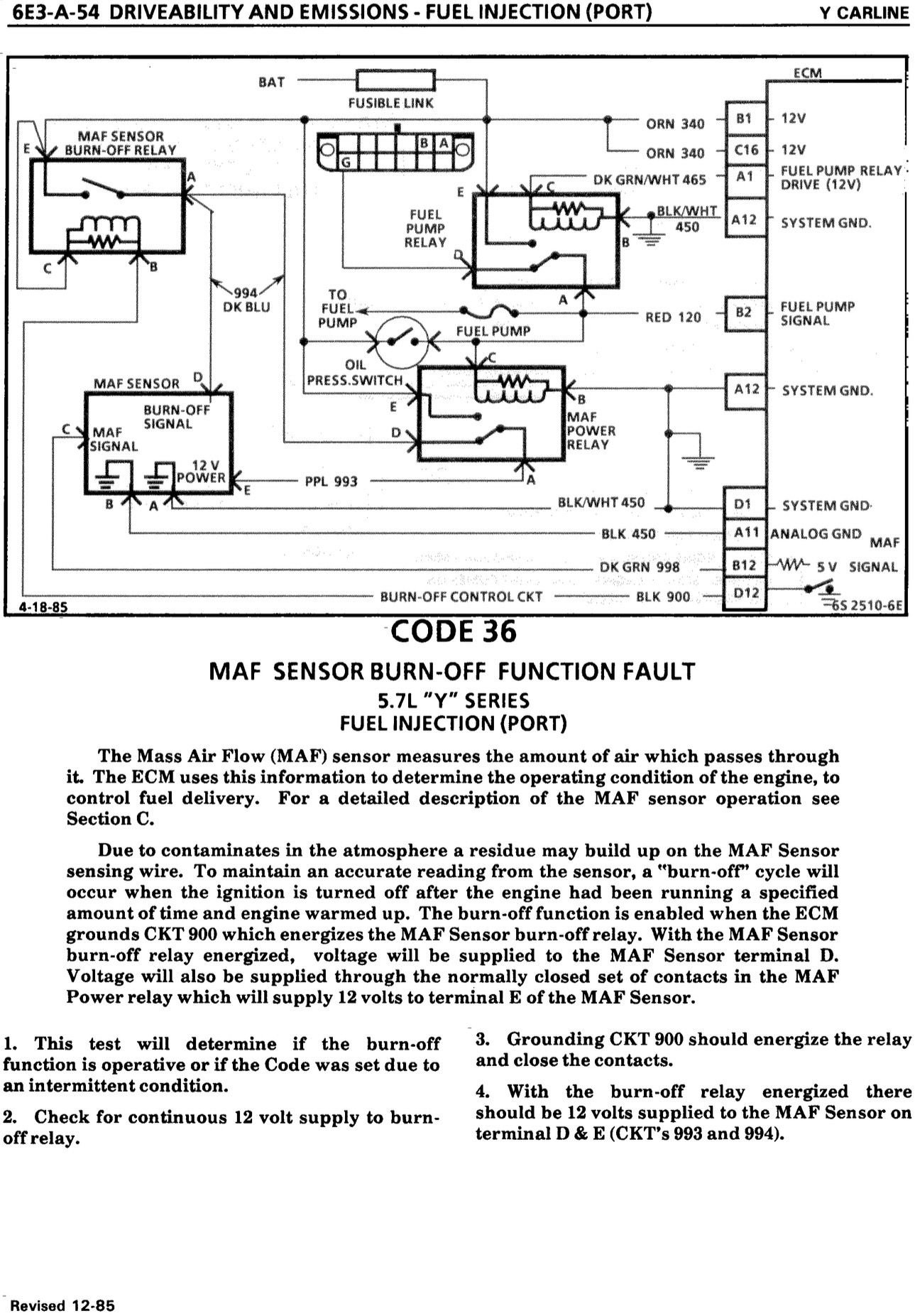

So I have the 36 SES on my 89. I replaced the burn off relay and still came back. Check the MAF sensor and looks great. Nothing on it looks clean. I don’t want to buy a new sensor just to throw parts at it. For the most part the car runs great, but bogs down when I floor it. Any suggestions?

click on picture for clear image

When code 36 (assuming this is same MAF Burn Circuit from my '87) is active, the ECM changes tune to non-dynamic. Not good.
All kinds of threads on the forum regarding addressing code 36, why it fails in the first place, why it clears when battery is disconnected and first run, etc. Search a bit.
I had similar and replaced my MAF with a modern with no burn circuit and hired a tuner to disable code 36. Been working great, though I have to remember to clean my MAF once a year.
