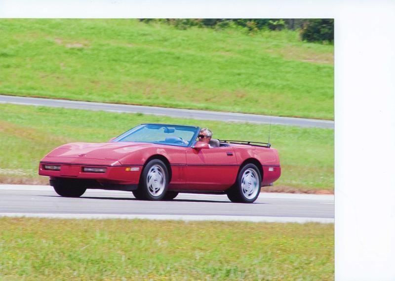

I dunno but 230k is darned commendable. Give that car a pat on the hood...

Original red paint, only second convertible top. Daily driver...except for right now.
