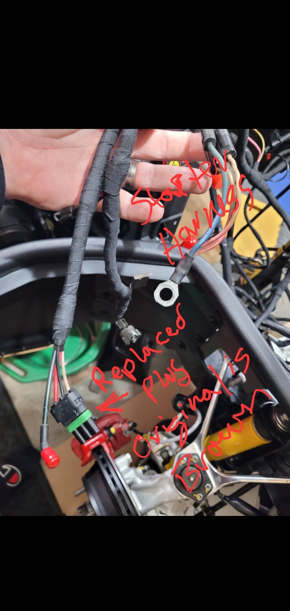

So I'm trying to make sure all my vacuum lines are routed to the correct spots and I found the vacuum line in the harness behind the distributor which I read was the main vacuum source but over at the heater control valve there is two more lines. One goes to the valve the other has a long hose routed over towards the brake booster. From the diagrams in the FSM it looks like that is the main vacuum source that goes to the 3 way check valve and if it is what is the one behind the Distributor?

I have most of the lines removed and disconnected from when I have the engine out but I was reading the other posts and my front port is plugged and everything feeds out the back. Main thing I’m wondering about is the line behind the distributor in the main harness.

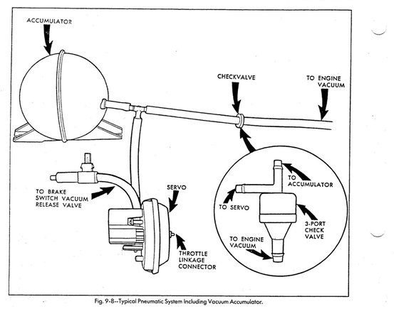

I have those diagrams but don’t mention the line behind the distributor. I thought it went to the 3 way check but not according to the picture.

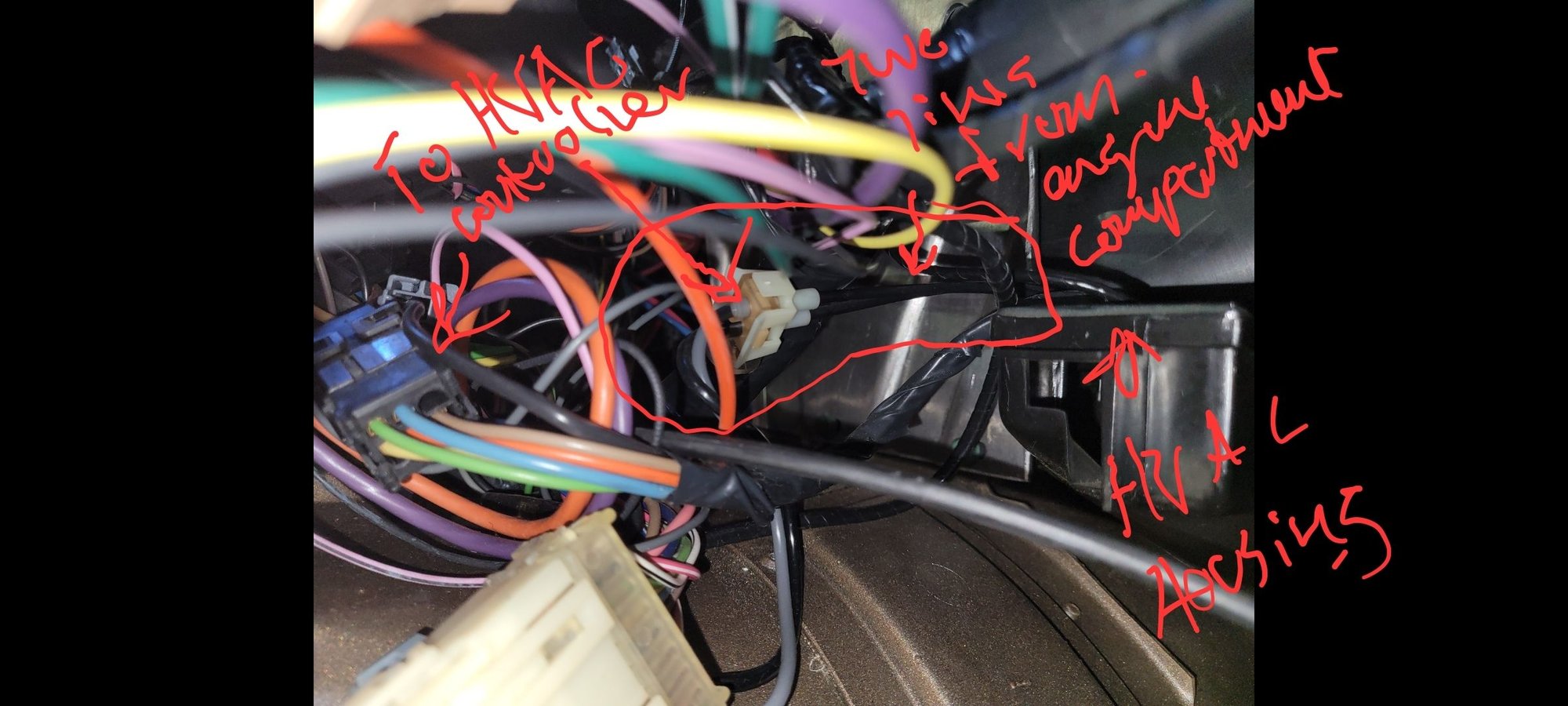

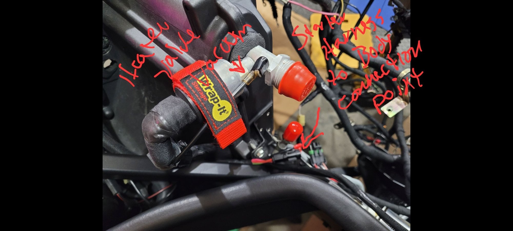

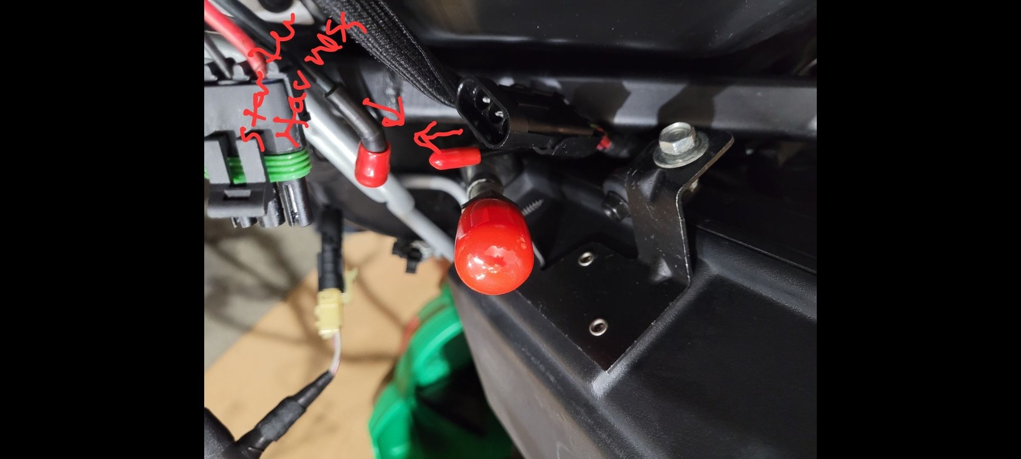

What vacuum source feeds that line? I have the two lines near the evaporator that seem to duck inside the wiring harness one goes to the water valve the other was conected to a hose routed towards the brake booster.

One diagram shows both lines on the pass. Side one to the heater valve and the other going to the vac tee. The other shows the ball and cruise getting the tee connections. Nothing mentioned about the hidden line behind the distributor. I assume some of those diagrams are not accurate. Need to find a intact 84’ and look at it.

The elbow from the hard plastic vacuum line in the harness behind/beside the distributor does plug into the 3-way check valve. The other end of the check valve plugs into the LH rear intake port...the side port on the check valve runs to a "tee" which feeds the cruise control and accumulator (vacuum ball)....Back to the "distributor vacuum line", it runs towards the passenger side, routing down by the starter and coming back up to the bottom of the evaporator housing...this is a connection point, from there it runs under the RH cowl brace and Back up to the top of the evaporator housing back towards the engine and enters the cabin with the wiring harness behind/above the RH valve cover...it then leads to HVAC controls. From the HVAC controller heading out, they're are 2 hard plastic vacuum lines...one leads to the elbow that plugs into the check valve by the distributor (described above), the other leads to heater core bypass valve and ends there....Clear as mud!? Hope this helps👍

So I think I have most of the vacuum lines sorted out except 1 which is a second line over near the evap. I started tracing it and found it loops but up into the harness with the other hvac lines going into the firewall. Just need to figure out where the end with the hose went. it's barbed on the end. I guess good news is I picked up another 84' that si not hacked up so I can trace with that but at a quick look I didn't see any second hose not in a harness.
