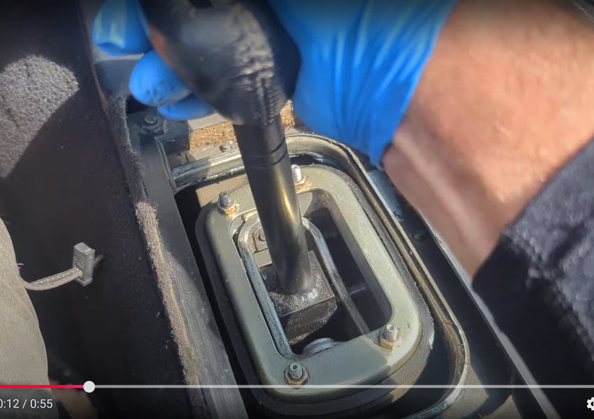

Checked clutch fluid. All good. Drives, rides and shifts smoothly. I have to pull hard with both hands to get the shifter over far enough to engage 1st or 2nd. I don't see a way to upload a video here. https://photos.app.goo.gl/CcCCvSpEk9w4w8837

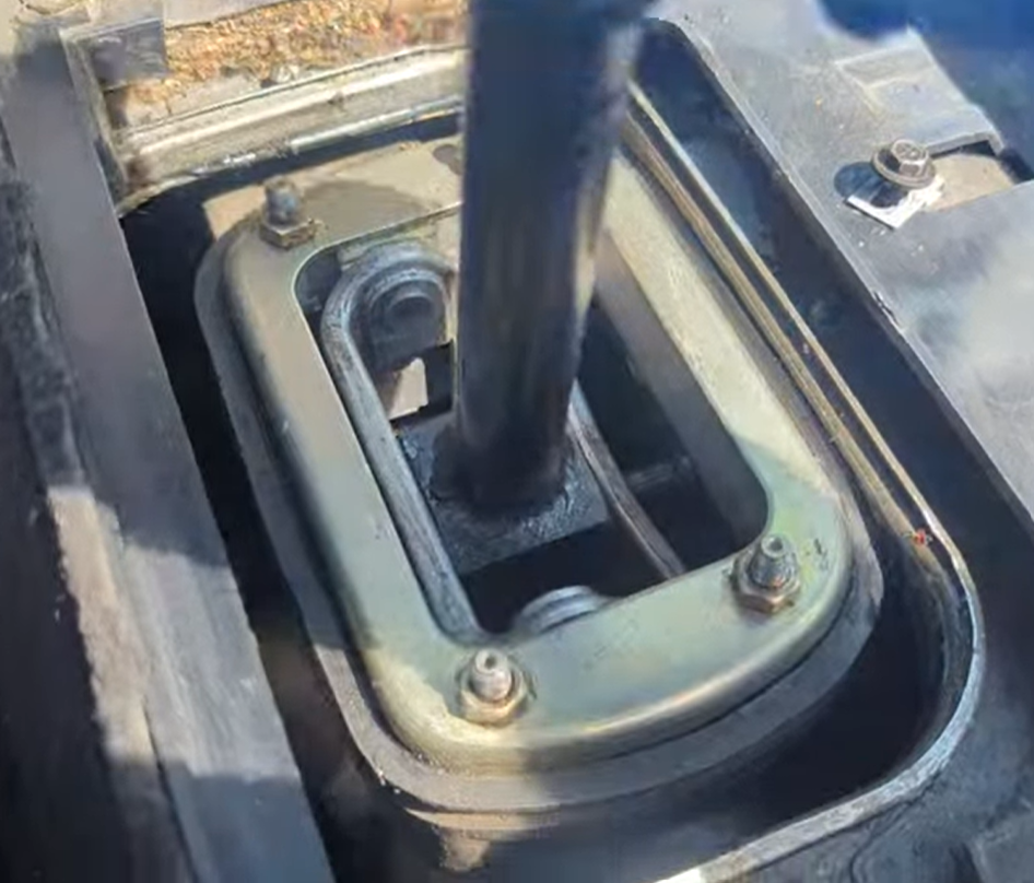

I'm hoping that someone can help with this issue. My car has been stored for almost a year now. I need some advice on where to start with this project. I have a small garage but no lift so I was thinking to raise the vehicle up about 2 feet on blocks and start removing the supporting cross members (convertible) and the exhaust system to get access to the clutch and transmission. I have basic tools and DIY mechanical skills. I'd love to do this myself and there are no local mechanics that I would trust in this tiny northern community. Thanks!
Old Jun 4, 2026 | 01:45 PM
2011KLR's Avatar
2011KLR
Joined: Sep 2022
Posts: 1,485
Likes: 395
From: Liberty, SC
If you can get it to shift into first, albeit with high force, I would say that the transmission internals are OK. The shifter/linkage are/is your problem.
Spitballing....
Is it at all possible something fell down into the shifter housing and has lodged itself so that it prevents you from easily all the way left to get it into that gate; something like a quarter or a toothpick or a bottlecap???
I also have the 4+3 so I don't know what or how all of the ZF shifter linkage sits in there.
Old Jun 4, 2026 | 01:51 PM
racingwiththewind's Avatar
racingwiththewind
Navigator
Joined: Aug 2021
Posts: 9
From: British Columbia
Thanks. It looks pretty clean in there
Old Jun 4, 2026 | 01:54 PM
2011KLR's Avatar
2011KLR
Joined: Sep 2022
Posts: 1,485
Likes: 395
From: Liberty, SC
I know that those ZFs had that CAGS stuff. I wonder if the lever/plate/thing that forces the 1-4 shift is broken and is preventing you from getting back to the 1-2 gate?
