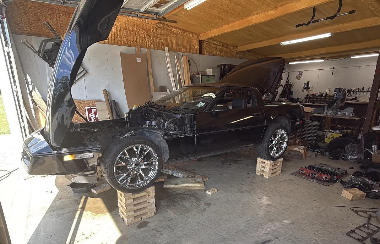

After weighing all the options to this issue, I decided to install an EFI system made by Aces EFI. I bought the Aces EFI Wild Card II system. It includes the intake, throttle body, sensors, injectors, harness, ecu, power distribution module (complicated fuse block), and more.
I'm going to document the work in this thread. Current state of things:

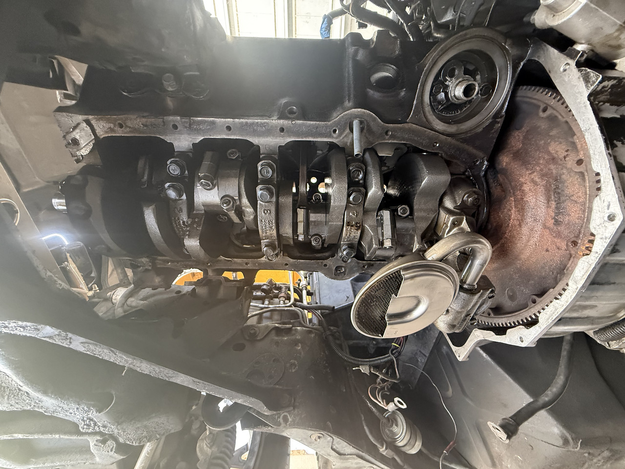

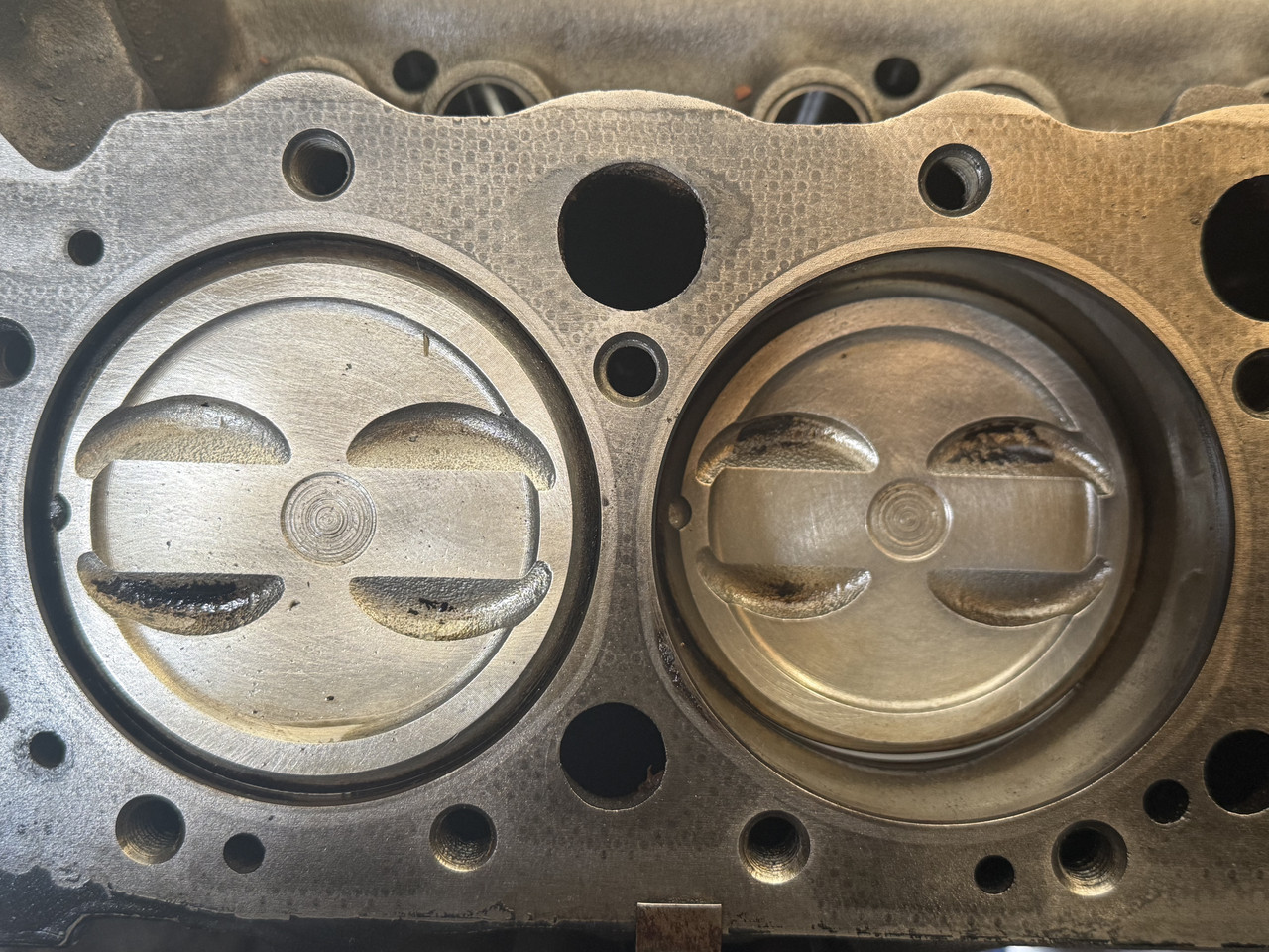

I've learned quite a bit as I take this thing apart. One thing I was surprised to learn was that the engine is a replacement. I had made all my plans, calculations, and purchases off the ASSumption that the motor was the original 1985 L98 with 9-1 compression, 5cc dish forged pistons, 2 bolt main caps. The motor is the targetmaster crate motor with 8-1 compression. The pistons have huge 16cc dishes in them. So, I've had to do some refiguring on the compression. More on that later.

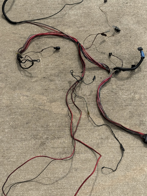

Current goal is to install the ECU, harness, and integrate parts of the old harness still required to run the vehicle.
