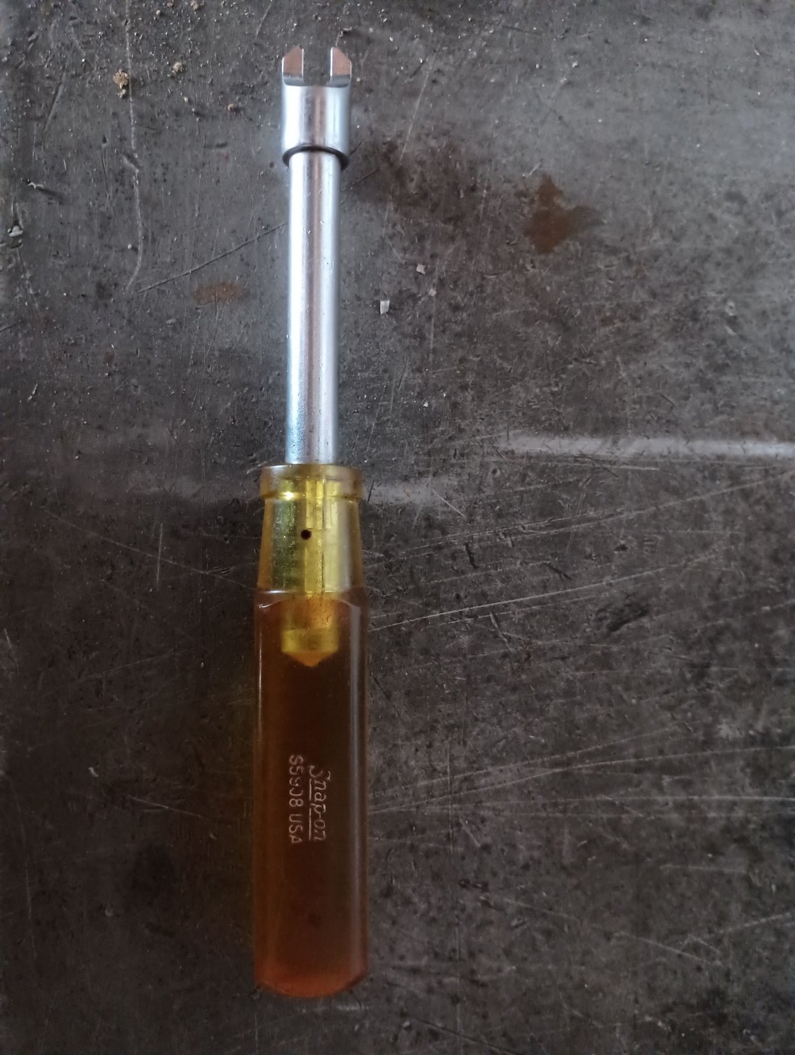

All that chatter regarding removing the dash pad, I see that you haven't removed it.
Originally Posted by Da Mail Man
If anyone has removed the switch, notice the nut, how did you unscrew that nut?...
With this?
Its a Snap-On. I last purchased any Snap-On when I was still at the dealership. I left in 1978, so this tool has been the roll-away for almost 50 years. Im sure I used it on my 85 when I replaced the switch in 2006.
It's a Snap-On. I last purchased any Snap-On when I was still at the dealership. I left in 1978, so this tool has been in the roll-away for over 50 years. I'm sure I used it on my 85 when I replaced the switch in 2006.

You stated:
"All that chatter regarding removing the dash pad, I see that you haven't removed it".
What do ya mean "still haven't"?....
As I stated, it is either raining or, a high threat of rain and, since I do not want to work out in the rain, of course no direct attempt has been made...
Looking at the pict that has been posed, this is "close" but, would not work because the length of the switch shaft would prevent the "posted" tool from engaging the nut..
I have to wait 'till all this lets up to re-attack the problem....
Has anyone else removed this nut holding the headlight nut in by different means absent that tool displayed?
With this?
You did time with VW I believe also. Correct? That tool(S5908) is actually I believe a VW/Porsche specialty tool. I've only ever seen VW/Porsche mentioned in the eBay for sale offers etc. There was also a MAC SC1 that was a socket driver attachment.

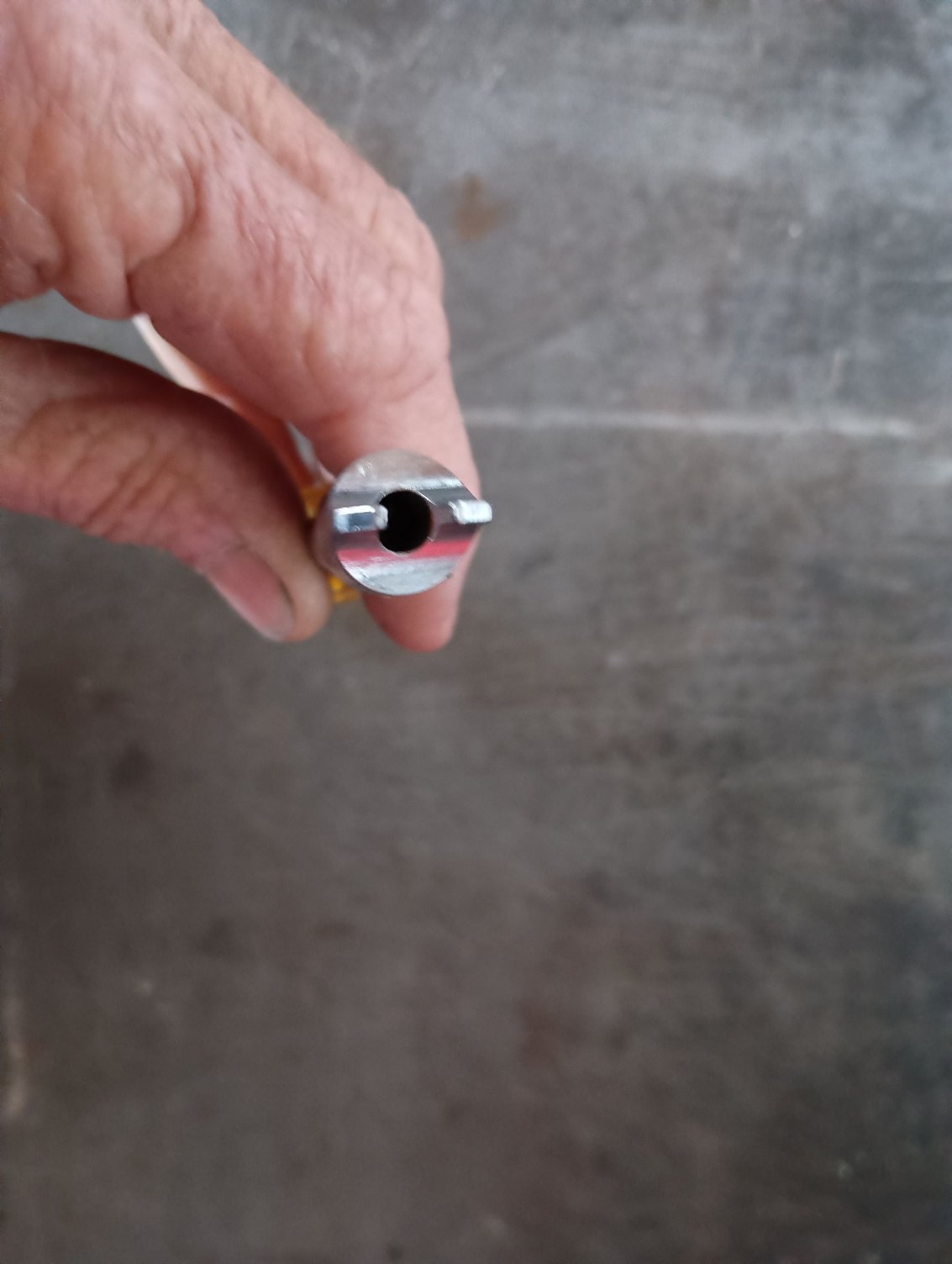

Looking at the pic the length of the switch shaft would prevent the "posted" tool from engaging the nut.
Look again. The shaft of the tool is hollow!
Oh?........It clearly looks like a typical socket where it (the depth) only goes just so deep....
There is no mention by you that the tool is hollow prior to you posting of the pictures!
