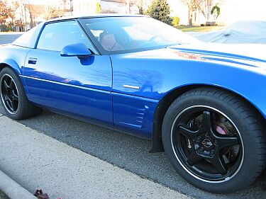

Was your Brembo kit a direct bolt-on, or did you have to cut the knuckle? Your wheels are ZR-1 offset 17"x9.5" five spokes, yes? Any regrets, or would you choose the same kit if you had it to do over again?

I have brembo's with my GS wheels.
