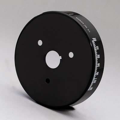

About the tape: I used it on a boat and it stayed on for about 2 weeks. I even washed the damper in acetone before I put the tape on.
With heat and oils in the engine compartment - they just don't stay on.
One possibility is to get a damper cover that's made of metal. See summit racing.
don't stay on.
A boat application (esp an enclosed one) would be a severe one
for a tape - humidity might affect bonding, too.
For automotive use, I've had and heard of good luck with tape.
As for the cover, a few reasons not to do this come to mind.
If a tape didn't hold up and I really wanted the marks, I'd
have my balancer degreed or replace it with one that was.
