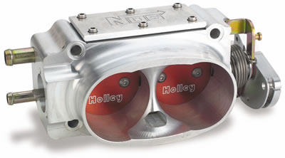

Bryan, yea, it's a stock unit that was bored by David K. He did a great job. Here's what I think I'm going to use when I install some AFR LT4 heads. It has built in NOS passages and is twin 58s. :thumbs:
