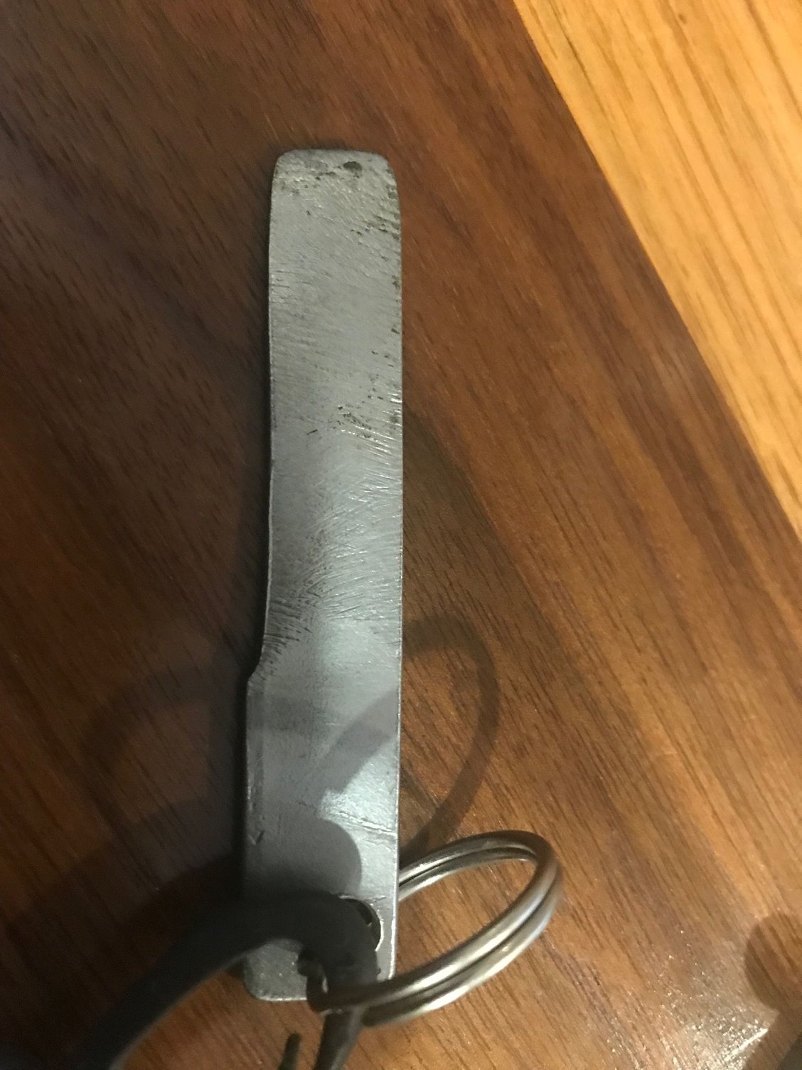

Scorp508 bought a used trans with the OEM tool used to align the shifter (he posted a picture if you want to search), but you can make a crude one. Use a flat piece of steel about .090" thick x .650" wide for at least 3" long. Bevel the end slightly, and you're in business.

It helps to have a pic to go with the description. You need a tool similar to this, that I made out of a piece of metal stock with a grinder. It was easy to make, using the dimensions mentioned above, and slides right into the slot at the base of the shifter. It helps if you disconnect the shift rods from the levers to start with, and then simply adjust each rod to the proper length. If your transmission is locked in any particular gear, use a pair of channel-locks on the shift levers to put them into the neutral or center position.
