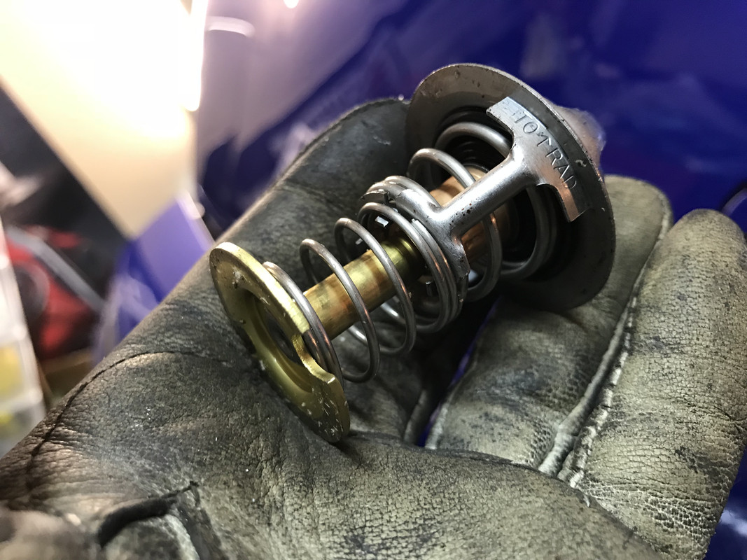

Thermostat appears oem. Still undecided which route to take with it as I’d like a 160 but will decide that shortly. Pic of the rad and a the new rad with my large tube light behind it. I think I’ve seen far worse but it’s pretty clogged up.
Oem

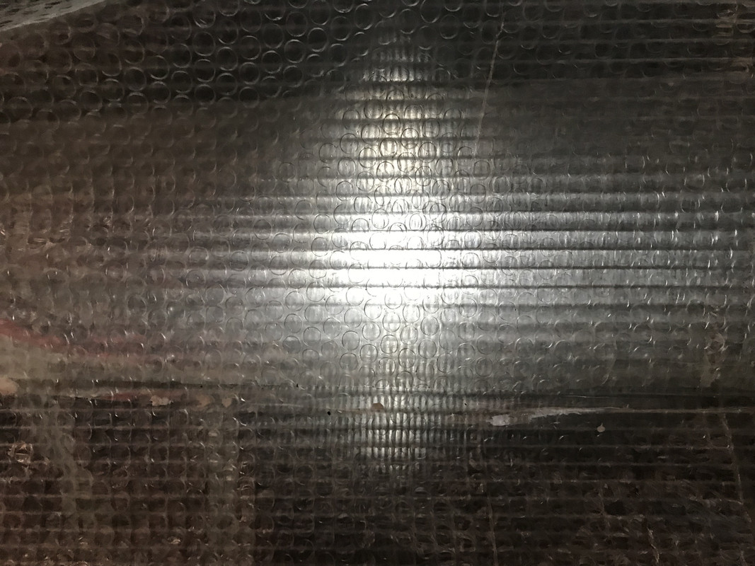

peak through the new one.. with bubble wrap still on. Didn’t want to pull it out just yet as I didn’t have time to put it in

New one shows how dirty the factory one is!

Absolutely no reason to run a colder thermo. Coolant temps will be what they will be. And u want to maintain an 80C+ temp since Closed Loop Learn is enabled at that temp and above.

Well I’ve given you the rationale for using the stock thermo, What tells u that 170 would be ideal? And I’m asking this not to open a can of worms but because others read this stuff and it helps to educate others.

poke a couple of holes in the stocker and be done
I've had some trouble with engines running too cool and it's not good at all
some of the aftermarket thermostats are a bit flakey and high priced.
I've gone down that rabbit hole and ended up with a 170 that works ok finally

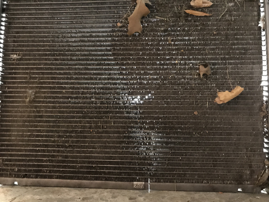

that stocker rad doesn't look too bad at all. Normally if driven quite a bit they can get quite crusty
with the thick ron davis rads run better fans as the cooling stack gets thicker, the stock fans don't have the pull needed to keep the car cool with the ac on
the big rad cools great once you get her movin

I’m using a Fluidyne on my ZR. I currently have a stock 180* thermo w two small holes drilled in it. Typical cruising temps are ~ 83-88C. Just fine to maintain ECM LEARN enabled. Sitting at idle and w both fans ON, I can keep temps in the low to mid 90s. W 4 holes in thermo, it was impossible to get engine to operating temps when ambient temps dropped much below 45F.

Listen to Dom, he knows what he’s talking about. You don’t want to go below a 170. It has been proven that a standard 180 stat with 2 holes at 1/8” helps with hot running in hot conditions. There is no performance improvement short cut with a colder stat on these engines. It’s simply a function of how the programming was designed by GM. As has been pointed out the performance actually gets worse if you go too cold. If you want better performance out of your existing setup a custom tune is the only option.

Here is what I have found regarding LT5 Stant Thermostats.
1. You want to run the engine at coolant Temperatures of 180 deg as the design requirement...……...Running cooler Thermostats only lowers coolant temperatures when running coolant below 180 deg F (which is too cold for the LT5 engine). Once the 180 deg Thermostat and 160 deg Thermostat are fully open at 180 deg, Coolant flow is the same through each Thermostat with equal cooling as directly dependent on coolant flow.
2. Drilling Holes in Thermostats offers minimal (non effective) additional Coolant Flow...….A 1/8 inch diameter hole in the flange will only offer additional flow area of .0123 square inches. Which one such hole will increase the total flow area by .016 or 1.6% (three 1/8 inch diameter holes would increase the flow area by 4.7%). This thinking does not address the change in coefficient of Discharge of such small holes. The Stants tested would be fully open with a flow area of approximately .785 square inches at 185 deg F.
3. The Stant Thermostat Opens a bit less with age......…...Marc suggests a 15% deterioration in Full opening area of the Thermostat over time as the Thermostat ages.
4. Lastly, The LT5 Water Pump Flow is proportional to Engine RPM. ......The LT5 Water Pump Flow rate is insufficient at RPMs less than 2,000 RPM for adequate Coolant flow at the higher Ambient Temperatures. Larger Aluminum Radiators DO compensate for inadequate Coolant Flow at low RPMs. Fans Turning on at 205 deg F do help considerably. And KEEP The Radiator, Oil Cooler, AC Condenser CLEAN.
Now compared to the normal aging of the thermostat of 15% over several years of use one would be much better off installing a NEW Stant Thermostat gaining 15% flow area as compared to drilling three 1/8 inch holes in an older Stant Thermostat only gaining 4.7% flow area.
See Post 120 - Thermostats, Fans, Radiators and Coolant Filling
I educated myself on this and believe item 2 above to be true. If anyone wants to buy a cooler thermostat let me know but I think they are a frisbee
put a better radiator and fans, or a nice clean stocker
more hp you run, plan on upgrading the cooling system a bit but the thermostat is not the place to look for hp
I found the LSV runs right around 174-184 on the highway, but still have some trouble with the lumpy cams and high compression staying cool with the ac on
