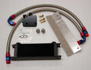

Okay, Looks like this may be an item I will need very soon. Water temps are very good at a max of 201 so far this year bur I have seen oil temps in the 242ish area and stay stable at 230-235. What system works well for the FI bunch................tell me what you know...Please
Oh and if you have pictures of where it mounts that would be great...............I have alot of STUFF on the car

I originally had a Ron Davis w/internal oil cooler but swapped it for a Dewitt without an internal oil cooler and a Setrab external oil cooler. The Setrab is mounted on the drivers side and vents into the wheel well. Water and oil temps are much lower.
Very Nice, what model did you use? Do you have any pictures of the mounting location? Damn turbos have a way of taking up a little room Thanks
If I remember correctly it's about 12"-13" by 7 1/2" . It's mounted on a standoff enclosure about 1" away from the wheel well liner. The well has a cutout the size of the cooler and is covered with a mesh to protect the cooler from rocks. I don't have a pic, but I will take one and post it. Taking the oil cooler out of the radiator makes a difference in engine cooling....you just have to fab up mounting brackets and extend the lines.

If I remember correctly it's about 12"-13" by 7 1/2" . It's mounted on a standoff enclosure about 1" away from the wheel well liner. The well has a cutout the size of the cooler and is covered with a mesh to ptotect the cooler from rocks. I don't have a pic, but I will take one and post it. Taking the oil cooler out of the radiator makes a difference in engine cooling....you just have to fab up mounting brackets and extend the lines.
Thanks for the info. That just might work in that location. If you get a chance to get me some pictures that would be great.
Now who knows about cut-offs (way to keep the oil from being to cold) is there a stat or something like that????

Call Campbell Automotive , they built a great one for me . Wish I had a pic I could take for you , but they took the car to the Powerrama car show this weekend . It's mounted between the intercooler and rad , pretty stealth , looks good.
