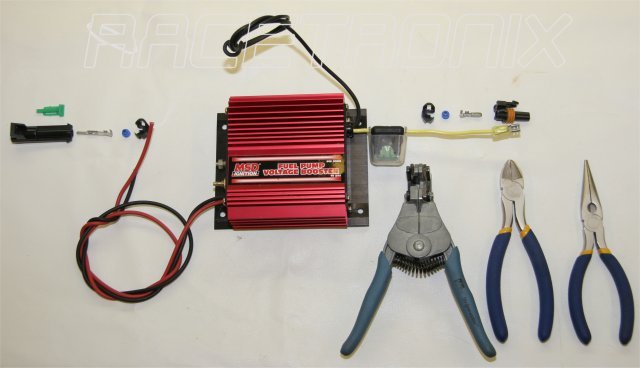

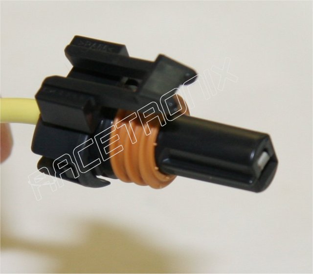

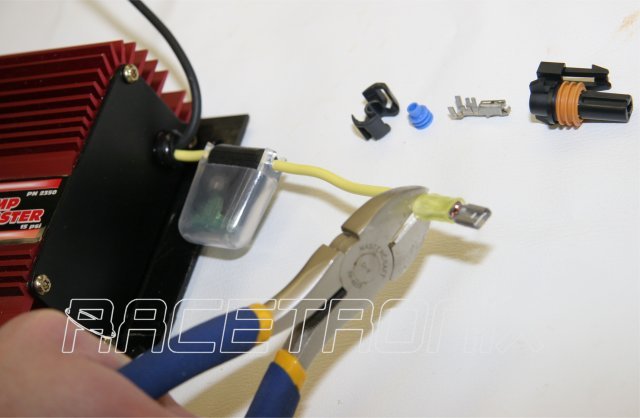

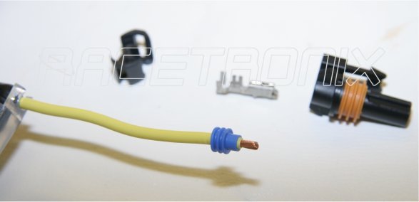

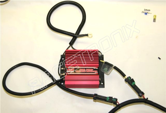

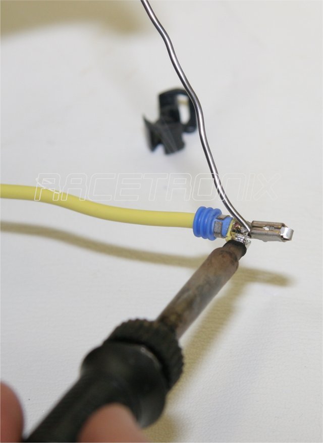

Where are you guys mounting your BAP's? Whether it is a KB or an MSD where are you putting them? The one I saw mounted was Cajundude's and it is in the driver side wheelwell behind the inner fender. I also have a racetronix pump with the hotwire harness, how do I tie the BAP into the wire harness and how do I put the weather-tite connector together for the BAP to the harness? Any help is appreciated. Thanks

We had a great thread on CF but as with most they seem to disapear...
The BAP is mounted in the driver's side rear wheel well just below the filler neck.

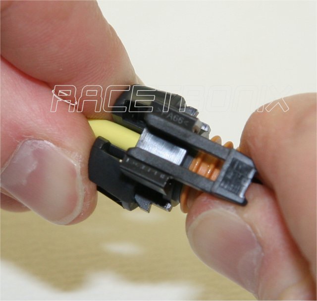

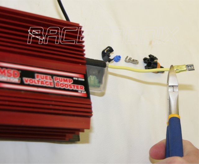

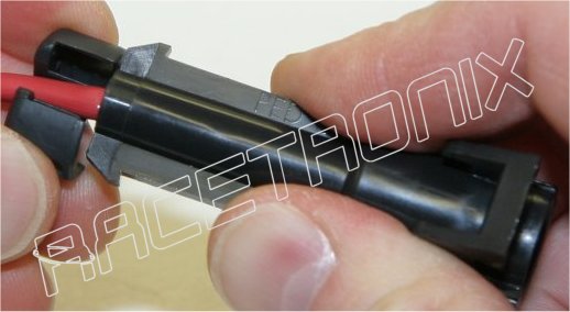

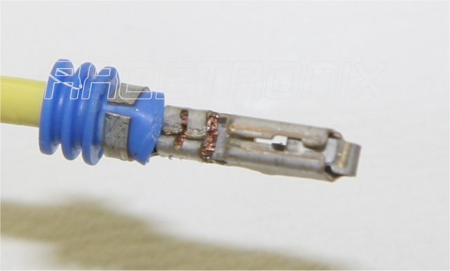

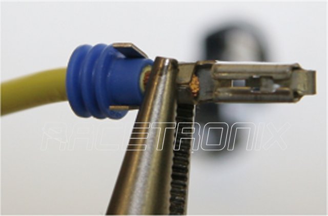

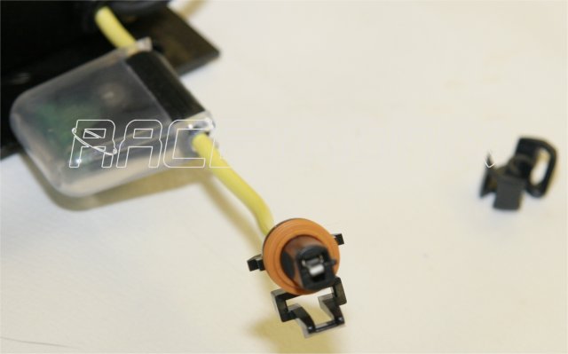

Here are some pics showing how to plug a BAP into the Racetronix harness. Our harness makes it very easy and more reliable.
