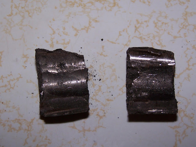

I ended up taking a grinder to mine last time. I cut it into small pieces and busted it out. Probably not the best way but NOTHING else worked.
not sure if this pic will work..

air grinder and a carbide bit, went 180 degrees apart, and cut just enough to get to the outside edge, than chisel n hammered and folded it in once it was cracked.
