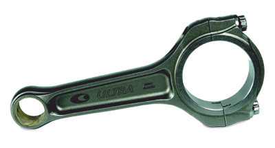

The Callies Ultra Billet I-beam is what I'm rolling with. I respect the hell out of the Oliver and respect this one more. It's one sexy rod.

Have you noticed on a couple of websites selling Callies Rods, that when you view their normal Compstar rod at circa $600, they show a picture of a rod very similar to that ?
Ive two sets of Compstars here, and they are just the normal H-beam that everywhere sells from egay to top vendors, for all engines
One example
http://hinsonsupercars.com/s-882-connecting-rods.aspx
Have Callies changed the design of the Compstar, or are the images just wrong ? Or is it simply a different rod ?
I'm looking to change/upgrade soon, and their Ultra billets look great, but you can see the confusion from above.
I'm also looking to de-stroke to reduce torque, as on road tyres, it just helps with traction, and will have virtually no effect at all on usable power.
I think the 4.0" stroke is just too much for these engines as the liners just dont support the piston well enough when they are around BDC.
IMO build it with a 4.0" LS2 bore which leaves plenty of strength and a stroke below 4.0". I'm hopefully going for 3.825" when I source a crank.
Howards Rods also look very similar and are keenly priced ?
http://www.summitracing.com/parts/HR...-LS1/?rtype=10
Edit...
Seems there is a Compstar H beam and I beam. Virginal Speed have them side by side on the website. The H's are around $590 and the I beam $900
Is the I-beam their Ultra Billet, or is that a totally different rod ?

There are two types to each rod. There is a regular H-beam rated at 750hp and a extreme duty H-beam rated a 1100hp. Then there is the two I-beams, the regular is rated at 650hp and the heavy duty rated at 1500hp. It is confusing but you need to know what to look for.
Actually it is anything over 4.00" stroke that you should stay away from if running N20 or FI on the LS1,2,3,6,7. Anything over a 4.00' stroke and the crown of the piston gets thinner. I will not have that problem with the LSX block since you can get such large cubes out of it and it is iron (482 ci max). I will still only be running a 4.00" stroke, 4.125" bore, and a 6.125" rod to get 427 cubes. Max stroke for the LSX block is 4.250" and max bore is 4.250" as well. Hope this helps.
