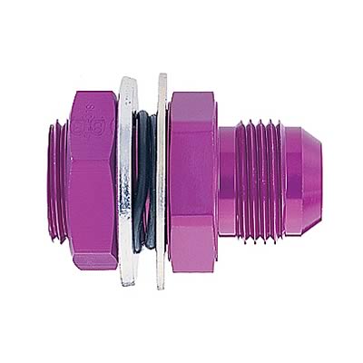

I don't know what the ecs kit is good to but would think a bulkhead and a big magnafuel pump would be the way to go. On E85. What injectors are you using?

LOL.....ok, I'll bite. Whats up with the bulkhead fitting ?? Are you saying "actual size" is what I need ?? LOL....
I was just saying build your own. I dont know if you will be able to find a drop in fuel system supporting the power you want on e85. Is your car 2003.5+? I think bosch has a 2000cc injector that works with e85. It is not CNG based. I bought 1000cc injectors incase I used E85, Now that I want to use them for it i find out that some people are having problems with them clogging.

Give us a call if you would like to discuss our fuel systems, naturally I'm biased, but I truly do feel our systems are the cleanest-simplest-straight forward fuel systems out there.
Easy to upgrade if you start on the first stage, and we have tons of track data with 8 cylinder EGT's so you do not have to figure out what you will need. Tell us what fuel your going to run and estimated HP, and we have a system for you that will not cavitate on hard stops like the bulk head fitting builds will do, tanks transfer correctly, no noisy fuel pumps buzzing all the time.
