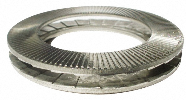

C5 Forced Induction/Nitrous C5 Corvette Turbochargers, Superchargers, Centrifugal, Twin Screw & Roots Blowers, Twin Turbo Kits, Intercoolers, Wet & Dry Nitrous Injection, Meth
First mod after blower?
Old Feb 26, 2014 | 09:40 PM
nutbuster's Avatar
nutbuster
Joined: May 2013
Posts: 111
Likes: 13
From: Dixon Il
You should do as many as you can possibly afford!! Because if your like me you always want more HP! I pieced my vette and it cost me twice as much. Anything you do from now on will require a new tune and at 300.00 to 600.00$ per tune that gets expensive quick. My first mod was the blower and I went with a pro charger p1sc, to small. at least go with a d1 that will give you a little room for more HP. If you haven't replaced the clutch yet you might as well do that because the stock one will not last! Soon it will stick to the floor on hard acceleration and after that it will just go out. Don't listen to the shmucks telling you that all you have is dirty fluid HAHA changing the fluid doesn't fix **** you have a weak pressure plate so go ahead and spring for a good clutch.
A complete exhaust will probably be the next step, then you will need to upgrade the fuel pump, bigger injectors, bigger blower cam, and a meth setup so you can tune for the most HP.. If your gonna do it do it right. After this you will be probably maxed out on your stock bottom end so you can expect to invest in a stronger bottom end. You are probably looking at 12 to 15K on the conservative side but you will have a mean setup if you can afford it. Just my opinion of course.
Old Feb 28, 2014 | 09:58 AM
PEETYZ's Avatar
PEETYZ
Joined: May 2007
Posts: 2,014
Likes: 48
From: Dayton Ohio
Originally Posted by Pekka_Perkeles
Locktite your cam bolts.
x1000
The blower puts extra strain and causes them to come loose. Manily on LS6 motors but still. Did a cam swap on mine when I added blower re torqued all to spec but forgot to locktite. Few days later I got the cam position sensor code and sure enough they were loose...hand tight likely 3 miles from complete destruction....
Red locktite
Old Feb 28, 2014 | 11:59 AM
Pekka_Perkeles's Avatar
Pekka_Perkeles
Joined: Oct 2005
Posts: 1,089
Likes: 82
From: Kauhava, Finland
Originally Posted by TraviZ06
What's the story behind this?
You should already know, if and only if you trust Internet forums.
In this case just look above.
Old Feb 28, 2014 | 12:53 PM
StingrayRebel's Avatar
StingrayRebel
Joined: Dec 2010
Posts: 10,367
Likes: 1,272
I would get a nice clutch and rebuild your torque tube and maybe upgrade your trans/diff or at least add a brace or new diff mount... my stock clutch gets roasted at 8psi so my next mod is a twin disc and tr6060 swap... then some good tires and then you can start adding more power mods since everything behind the motor will be able to handle it
Old Feb 28, 2014 | 03:14 PM
tlove32's Avatar
tlove32
Joined: Aug 2008
Posts: 3,451
Likes: 27
From: Bay Area CA
If I were you I'd do the following all at once - LT headers, meth, TUNE
Old Feb 28, 2014 | 05:24 PM
leo12's Avatar
leo12
Posts: 768
Likes: 25
From: Cape Cod
Default mod
everythinggggggggggggggggg
Old Feb 28, 2014 | 05:43 PM
JDS99's Avatar
JDS99
Joined: May 2011
Posts: 1,216
Likes: 56
From: Houston Texas
Originally Posted by PEETYZ
x1000
The blower puts extra strain and causes them to come loose. Manily on LS6 motors but still. Did a cam swap on mine when I added blower re torqued all to spec but forgot to locktite. Few days later I got the cam position sensor code and sure enough they were loose...hand tight likely 3 miles from complete destruction....
Red locktite
Originally Posted by Pekka_Perkeles
You should already know, if and only if you trust Internet forums.
In this case just look above.
Anyone ever used these?
Nordlock washers. Takes more torque to remove the the bolt then when installed. The angled flats between the washers causes the fastener to have to stretch further (climbing the angle) before releasing.
Old Mar 6, 2014 | 04:42 AM
randyfl's Avatar
randyfl
Joined: Sep 2012
Posts: 530
Likes: 164
From: Central East Florida
To the OP, Mr. Nutbuster is right on. Before you go all in on this, and once you start you will have no choice but to go all in. You may want to consider finding a car with mods you want in place. If had it go over I would leave my perfect car alone, and look for one with all the mods in place. Just my .02 cents
BTW, add a crank case evac system to the list of things you will need with that blower.
Old Mar 6, 2014 | 10:08 AM
a/c man's Avatar
a/c man
Joined: Jan 2009
Posts: 7,767
Likes: 19
From: East Texas
Originally Posted by randyfl
To the OP, Mr. Nutbuster is right on. Before you go all in on this, and once you start you will have no choice but to go all in. You may want to consider finding a car with mods you want in place. If had it go over I would leave my perfect car alone, and look for one with all the mods in place. Just my .02 cents
BTW, add a crank case evac system to the list of things you will need with that blower.
I will sell or trade my car
Old Mar 6, 2014 | 10:22 AM
4DRUSH's Avatar
4DRUSH
Joined: Feb 2004
Posts: 8,629
Likes: 16
From: York PA
Originally Posted by a/c man
I will sell or trade my car
Old Mar 6, 2014 | 01:57 PM
TraviZ06's Avatar
TraviZ06
Joined: Jan 2014
Posts: 161
From: Woodland Ca
Thanks for all the help. I think first order of business is to get supporting blower mods installed including fuel pump as soon as possible. I will buy a clutch second but not install it until the stock one starts showing symptoms.
What is a good link to a crankcase evac system for these c5's?
Old Mar 6, 2014 | 03:01 PM
5 Liter Eater's Avatar
5 Liter Eater
Joined: Aug 2002
Posts: 8,472
Likes: 38
From: Houston TX
St. Jude Donor '11
Best bang for the buck would be meth, coupled with more boost/timing IMO.
Old Mar 6, 2014 | 03:20 PM
  #33
breecher_7's Avatar
breecher_7
Joined: Feb 2009
Posts: 5,169
Likes: 199
From: Your Sister's Bedroom
Tires... Sticky Tires... Toyo R888's would be a good investment. Horepower does you no good if you cant put it to the ground. Smokin the tires gets really boring really fast.
All times are GMT -4. The time now is 11:07 AM.
