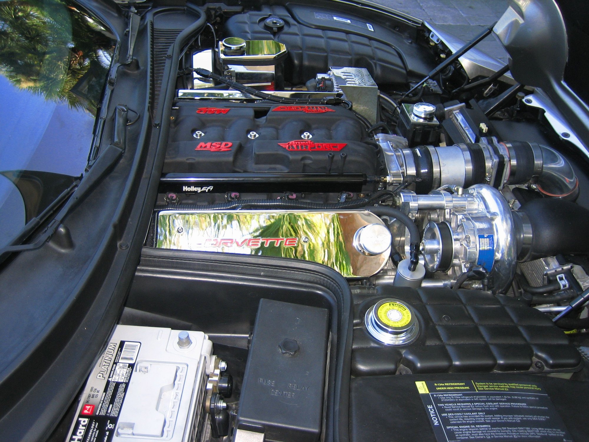

I thought you might enjoy a picture of my new MSD intake

Looks great RP any results on performance yet?

Is it sealed all the way around? Does it have better clamping than the FAST?
Old Jun 22, 2015 | 03:43 AM
road pilot's Avatar
road pilot
Joined: Feb 2007
Posts: 9,296
Likes: 1,531
From: Oviedo Florida
2016 C5 of Year Finalist
I don't know. The intake is sealed as good as the LS6 intake.

Any modification to the firewall?
Old Jun 22, 2015 | 08:44 PM
road pilot's Avatar
road pilot
Joined: Feb 2007
Posts: 9,296
Likes: 1,531
No.

Any issues with the install?

Issues.......
I guess I should put in a word about aftermarket parts first. When
you leave OEM territory you are headed toward modified and/or
custom. My vette is highly modified. That means it is NOT a cookie
cutter OEM vette. I will cut, burn,.drill or anything else to make
my idea work. That said..................
I have a LS1 engine (C5) I have been told that the C6 version of the
intake is easier to install.
Now the intake--The cowl had to be filed down. I have a blower and
the TB (LS2) had to be turned around because it was hitting the
bracket. I had to order special O-rings for the injectors. The fuel
rails (Holley) were to high and the stands has to be ground down.
The LS2 harness had to be extended because of the new TB
position. MSD sent the wrong SS bolts so I had to get longer one's.
Because of the TB relocation the Power steer reservoir had to
be repositioned forward of it's original position.
So.. now it looks good and I picked some hp what else would
you want????

Interestingly enough I have most of that done already (required for LS2 TB/intake with C5 A&A bracket).
Does anyone have proof of the substantial gain over the LS2 intake? $900 would be a lot to spend for 50 hp but I've spent more for less before. Might be a good solution in a max effort setup.

I paid a little over 8 for mine--new. Yea it's the LS2 TB on a C5 the
C6 tb clears the A&A bracket. In the fall I will know how much hp gain.
Tuner was impressed with my vette at full bore, but it was a fast car
before MSD +. I have paid less than a $100 and a lot more than
800 for 50 hp. Power cost's coin, we are not talking stick on bling.

Im reworking an LS7 version right now
So OP.....this is there cathedral or LS3 version? Or is it an LS7 cause I wasn't sure the other two were available yet

I bought the intake that would fit a LS1 engine. Part #MSD-2702
I guess you would call it a LS2 intake.

Interesting....actually more an LS1/LS2/LS6 intake.....all of which are cathedral ports
Very curious how this manifold will do against the gold standard.....LOL
I think this version was released ahead of schedule or at least the schedule I read about (they were initially targeting the fall I believe on the cathedral release).
Good stuff.....will have to get my hands on one of those as well!
