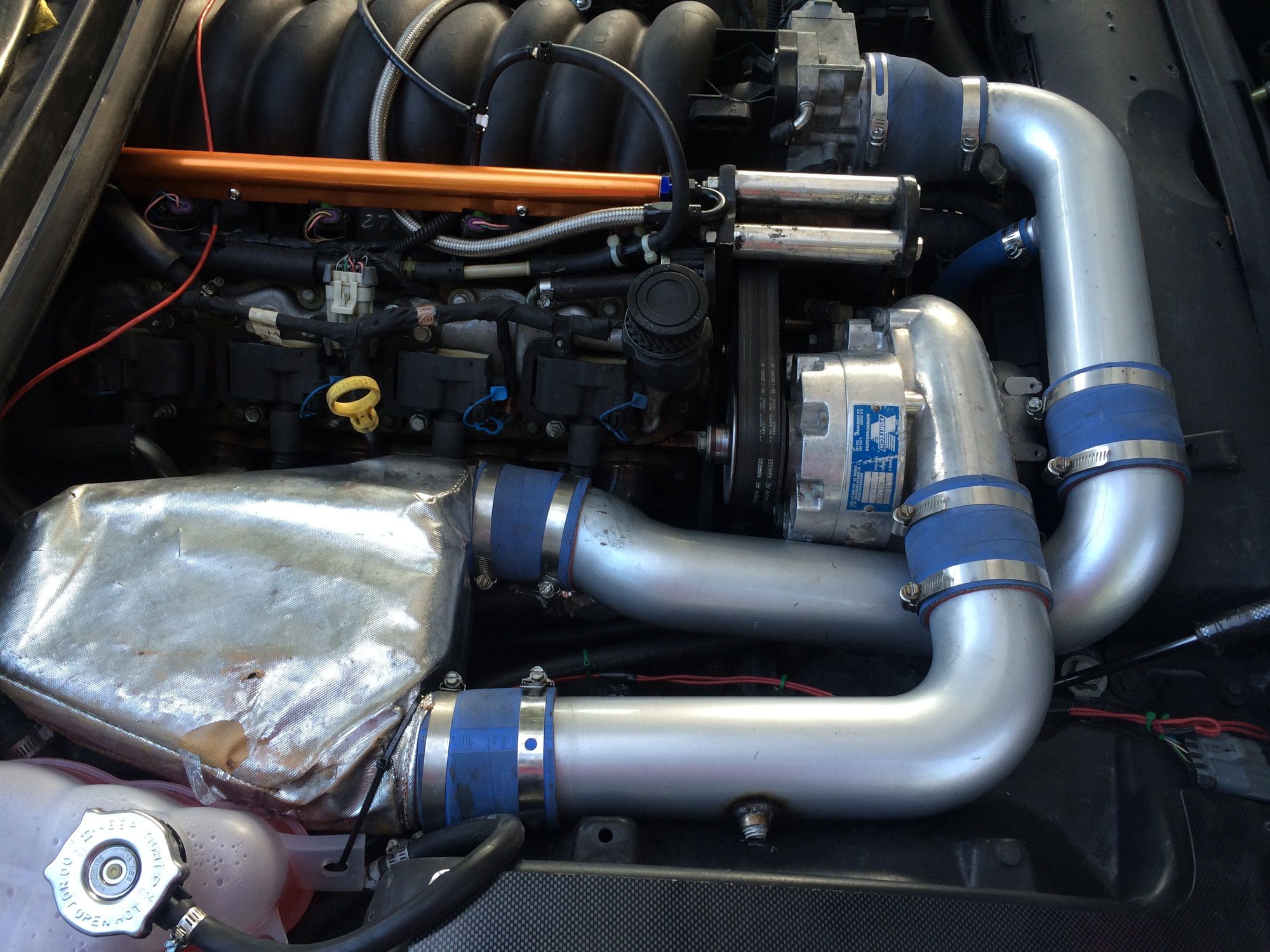

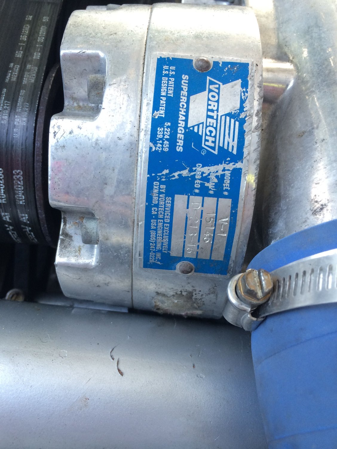

I had issues of fuel rails hitting SC brackets. Had to grind it down. But my main question. Is. Not sure I like the water to air intercooler. What would it take to swap to air to air. And free up the engine bay? I had new belts put on the car last week after I bought it. And now when I get on the car hard. The belts scream. Isn't the belt tensioner automatic? Or is there a adjustment?

i have a w/a intercooler on my turbo car. its great, gives you better cooling on the street, because the water is slow to heat up. when racing however, it not so great, as there usually is a lot of waiting and then the intercooler heats up from the engine. i sure would keep that baby provided there is a big enough rad cooling it.
