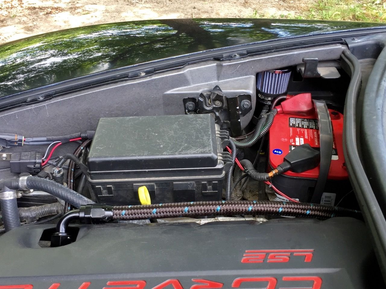

I mounted mine behind the battery. You can mount the universal mount back there. I used an oil cap AN adapter for the "dirty" side, then ran an AN 6 hose to the connection after the TB on the intake manifold for the vacuum source. You also need a clean air source for the crank case.. I ran a hose from the valley cover port to the air filter so that it can get clean air in that way.
I have some pictures around here somewhere.. I'll try to find them in a bit

(C6 but you get the idea)
