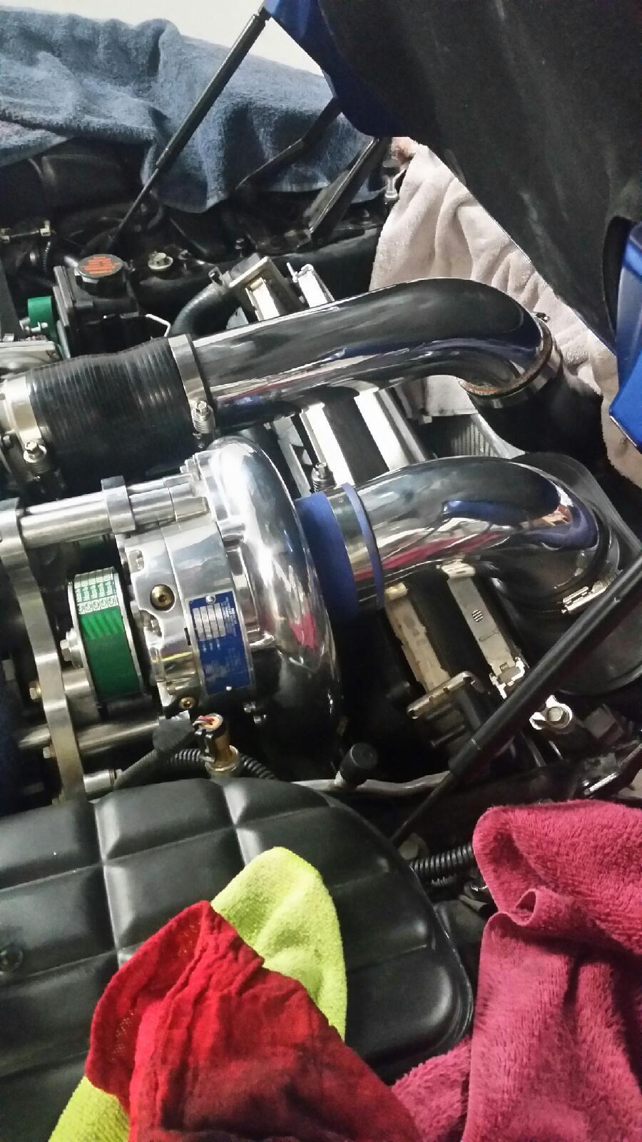

New best after v-3 install,wana thank Bret for all his help on the tune,well worth the money,thanks for being patient Bret. Now I have a new worry,the stock bottom end Ill post up the specs later,gotta get back to work.

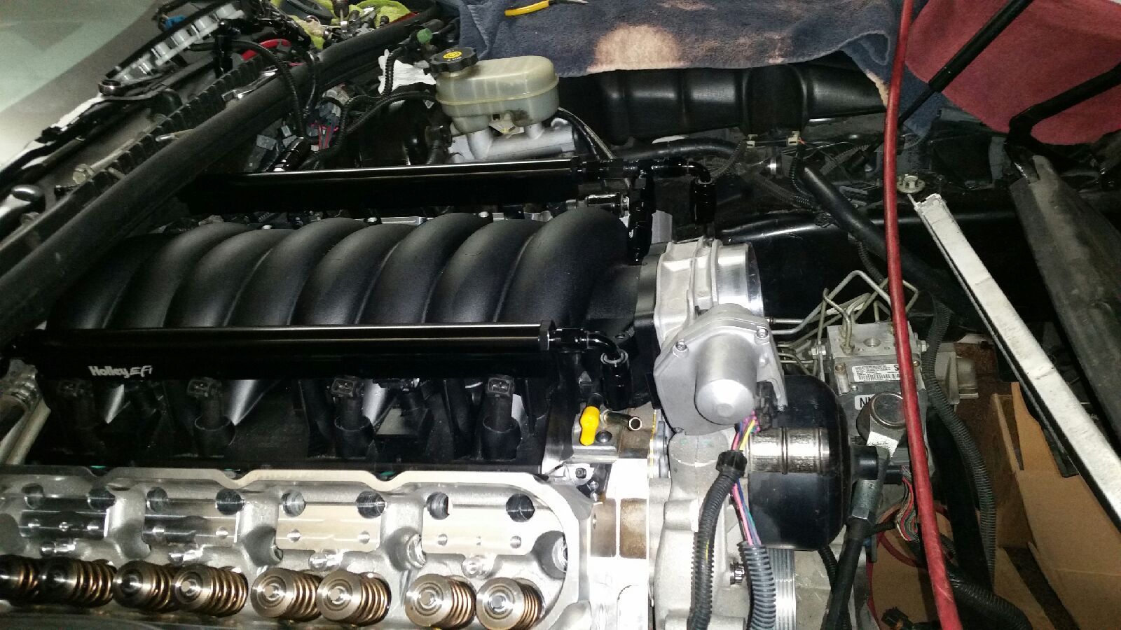

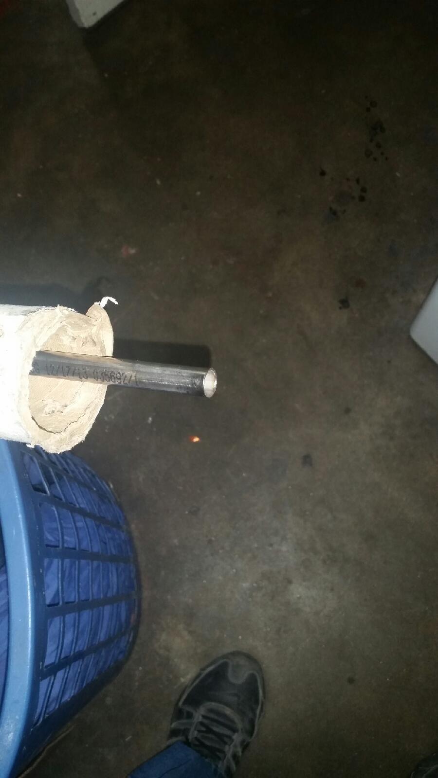

Ok my car is an 02 Z06 with 6700 miles,my old set up was heads (stock ported) and cam, lsx intake with 42lbs inj a decent tune,exhaust was lg 1 7/8 headers with2.5 pipes. Hp to the rear was @520. Here's a quick write up of all I did, had tons of picks I wanted to post,I broke my phone and was only able to retrieve a few,algz06 can vouch for me though lol.
Stock bottom end
New set up is V-3 head unit with 8rib pulleys that came from algz06.
Heads-Mast 253 ls3 small bore
pac racing springs,crower shaft mounted roller rockers stock lift.
ls9 head gaskets.
Intake-Ls3
throttle body-ls2
Holley fuel rails
ls3 injectors 127lbs with ls1 connections,which left about 1/2 in clearance between fuel rails and fire wall.
Fuel-E-85
aux 750magna fuel pump
east coast fuel block
1/2 stainless steal fuel line,covered in Hi temp insulation.
Fore fuel filter
Fore fuel regulator
Exhaust-Kooks 2in pri and 3in all the way back,Ghl mufflers.
cam- Ed Curtis custom grind, matched to the sc and heads 650 lift on
115
Double roller timing chain and hi volume oil pump.
Tune- By Mr.Bret

Nice !! Is it a YSI ?
No,its's a v-3

How many pounds boost? Did you use Meth?

its a V-3 T-Trim with a 8"/3.125" pulley combo no direct drive. kinda sad since it only did 637 rwhp on my car. bret obviously likes Juan better. LOL
no meth. it use to make around 15 on my setup, not sure on this one.

Im only making 11psi
