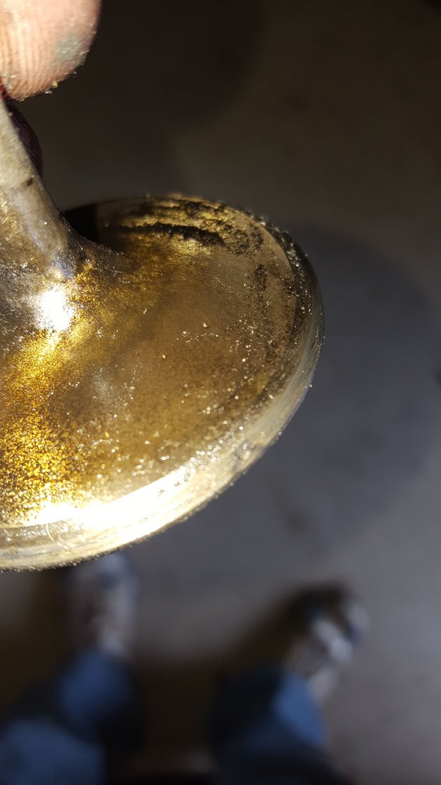

Old Jun 5, 2016 | 04:07 PM
DRIVER456's Avatar
DRIVER456
Joined: Jun 2005
Posts: 3,088
Likes: 61
From: NY- 2013 Corvette Challenge Champion-2013 Index Combo Champion 2015 CC/MM Champion
St. Jude Donor '07
Burnt valve
Old Jun 5, 2016 | 04:30 PM
stevieturbo's Avatar
stevieturbo
Joined: Jul 2004
Posts: 2,844
Likes: 144
From: Northern Ireland
pic isnt very clear, is there actually a section damaged ?
And did you ever do a compression test ?
