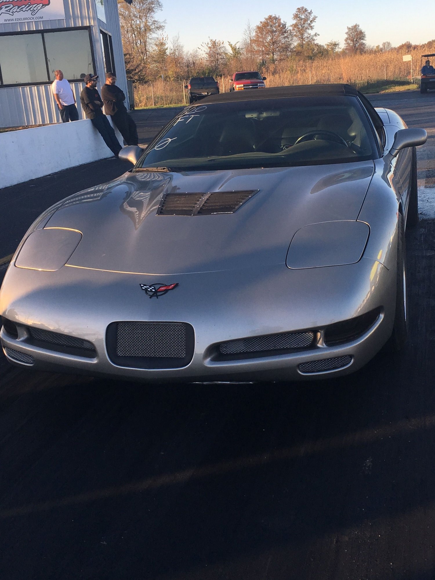

I have tried everything to keep my 2002 Z06 cool! New dewitt radiator, twin fans, override for secondary fan, scoops beneath the radiator, 160 thermostat, put hoodscoops into the hood to let excess heat thru the top, put two extra aux coolers down by the disc brake ducts, still runs hot. Am about ready to pull the rest of my hair out?? Of course it is an LSX 427 with F1X pro charger making over 1000 RWHP! Cant use the AC in traffic! So much for a daily driver?

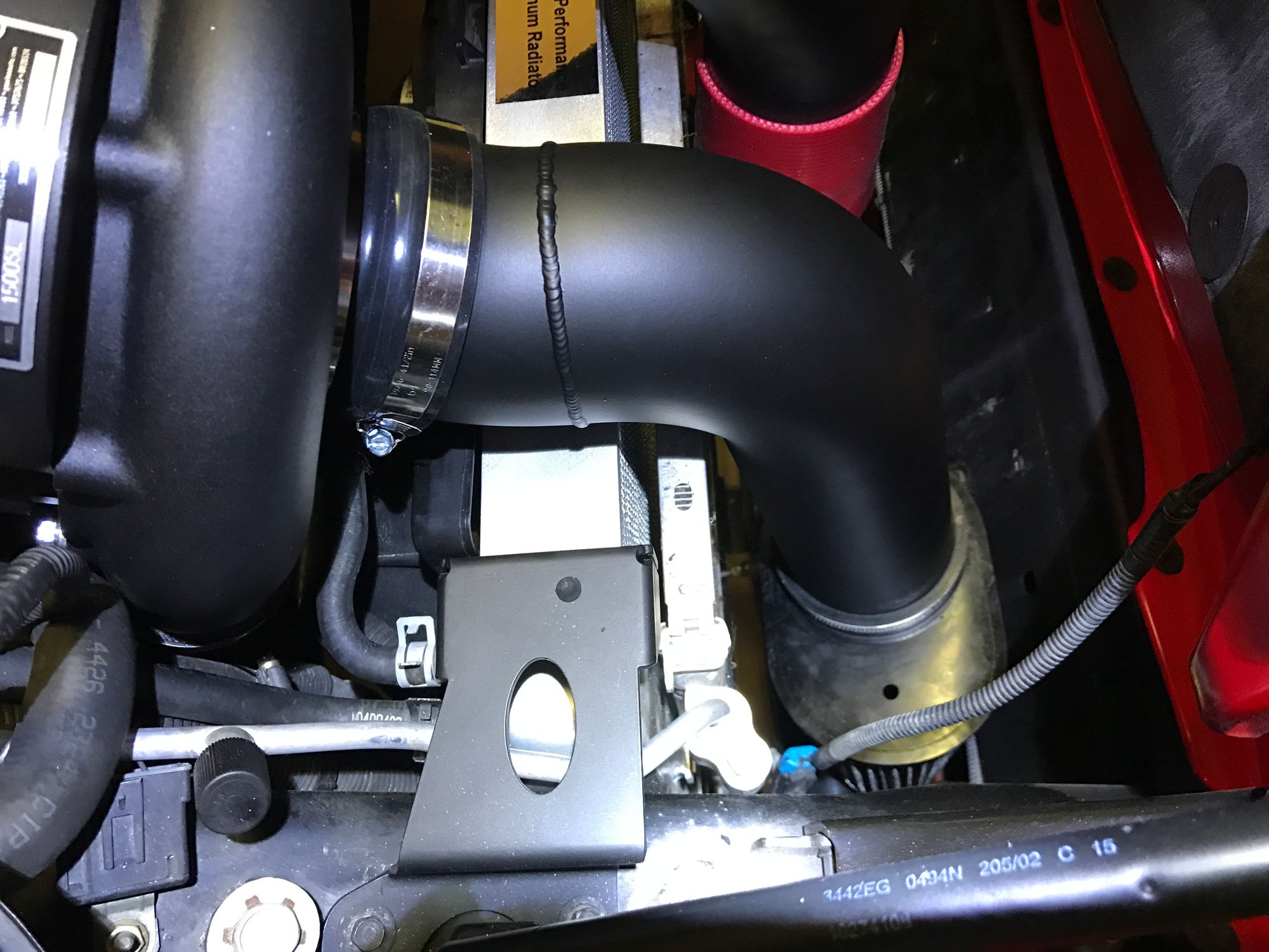

Why are none of you guys running a top shroud? Without a top shroud, air is not "forced" through the radiator. It can just bypass over the top of the radiator.
I built my own out of aluminum sheet from lowes/home depot. Its not perfect, but im not overheating either.

On my setups, I've found the opposite in the summer in Houston. Just more puzzling to me. I've seen hundreds of setups , some almost identical. Motor, blower, pulley, fuel, tuner and some just run hotter.
