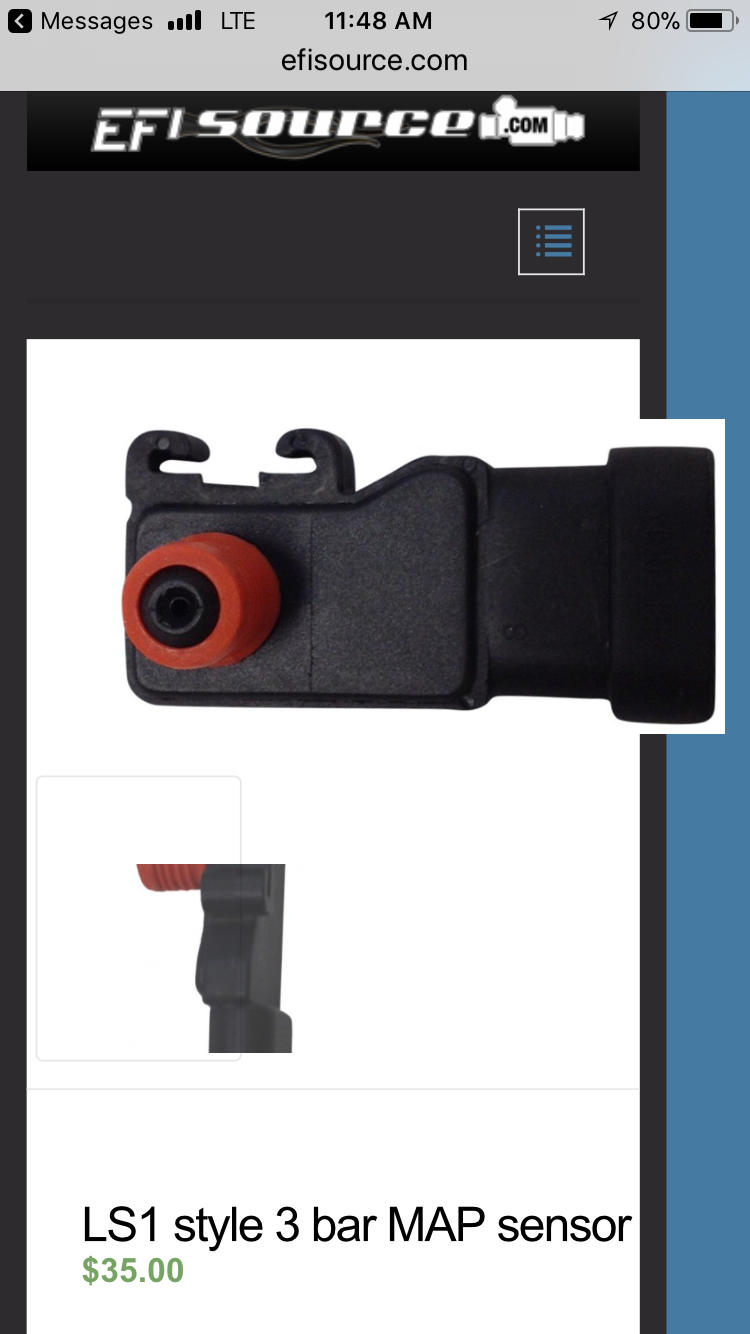

is there a 2.5 bar map sensor out there, with a hose barb that fits our plug? alternatively a 3 bar, although im worried about resolution.
im running a 2 bar now, and behaviour above 2.2 bar is stretched out.

I used that 3 bar map sensor and an adapter harness from Casper’s electronics. Plug and play.

I got a 2.5 sensor from DSX tuning a few years back. Looks like they still make them

My tuner likes this MAP. It’s 3 bar also.

You could use a ZR1 3 bar map.

so there is this:
https://www.facebook.com/DSX.Tuning/photos/a.574903862521598.124731.574889342523050/574903865854931/?type=3&theater
and this:
http://www.dpecorvettes.com/gpage4.html
i just wonder if the is a hose nipple under the red rubber piece.
apparently there is a cobalt/gm 2.5 bar that includes the iat sensor as well.
edit: i also found this, but you would have to get creative to fit a hose to it. does anybody use it?
https://www.briantooleyracing.com/ch...-12592525.html
ok. it seems this is the zr1 sensor, summit and other places list it as 3 bar? can anybody confirm if it 2.5 bar or not?

I use the DSX 2.5 bar and it’s worked great. Also important to have the right data for whatever you use, which Dave supplies. I suppose the others do to but don’t know.

i use the dsteck 2.5 one and it works great. I actually lost mine originally when moving before could install and ordered another one, then found the first one afterward. If you want my old one it's brand new still and i'll give it to you for half price.
