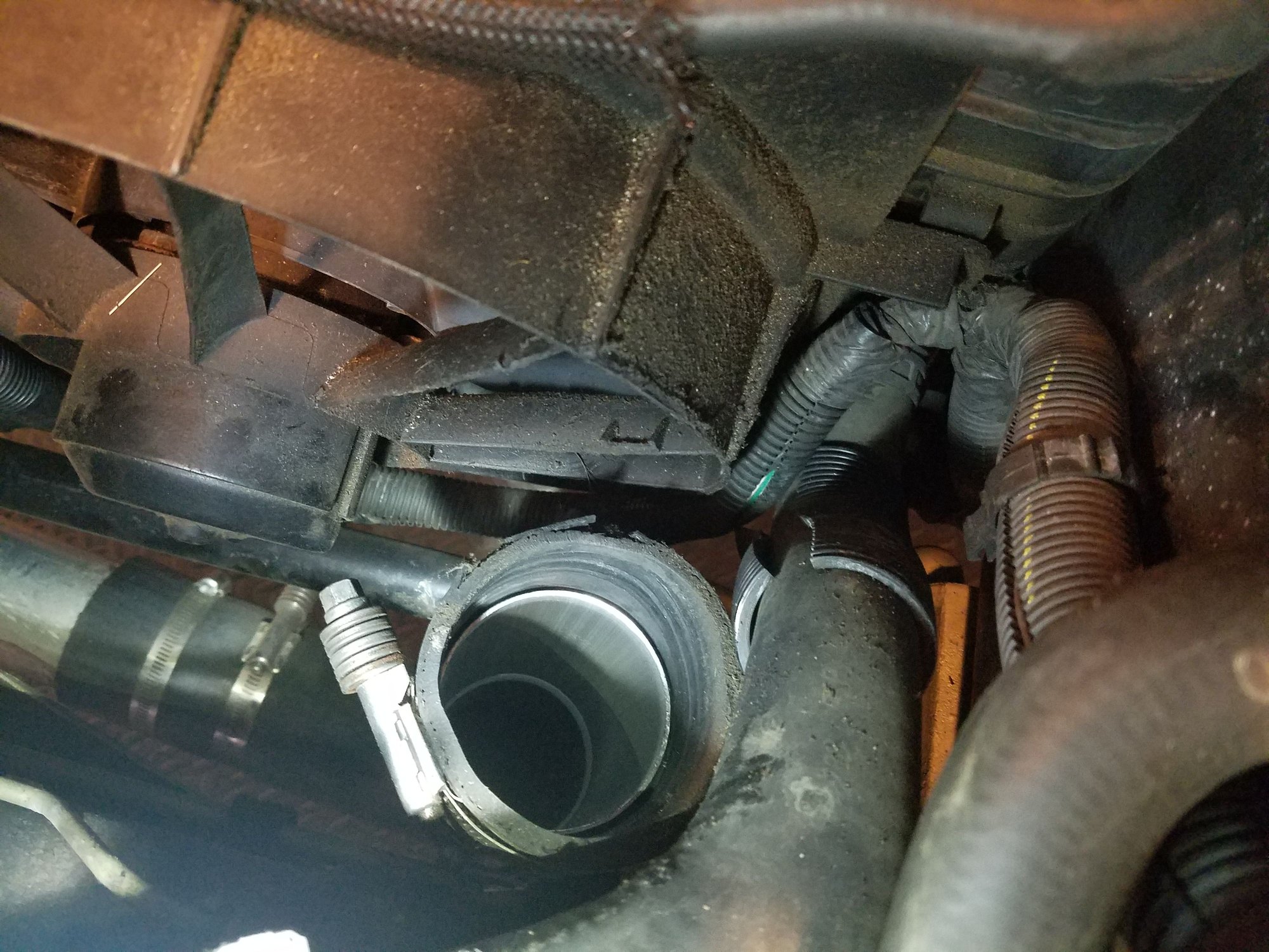

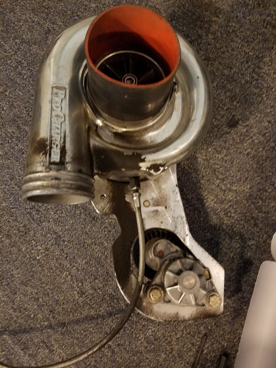

I've been puttering around doing a bunch of side projects on and off for a week - spent a few days in the ER for my mom, who had a heart attack - so I only just got to pull the head unit and bracket last night with intent of replacing idler and tensioner pulleys which had begun to squeal.
I thought they had begun chewing on the belt. And to be fair one side of the belt appeared rubbed. Laser aligning pulleys showed that everything was within spec. No significant variance.
Yet there seemed to be a lot of rubber powder being blown around under the head unit.
The source was the rubber sleeve over the outlet pipe. It has been rubbing against the radiator fan shroud and was close to wearing through at the blower.
My best guess right now is to go in and sand/clearance the shroud in this area so it is less sharp. I am also wondering what can be done to stand the radiator and condenser up to the front a bit more instead of the lazy lean towards the blower.
I'm definitely open to suggestions.
You can see the tear and the powder accumulation.
Blow pattern of the rubber powder as the tube was consumed.

Shouldn't be any issue replacing it with some paxton tubing should it? A bit thinner.
I have a bunch of other sizes of theirs, just not 3" so I'll have to order.

You can just shave down that fan shroud plastic with a sharp utility knife. I clearanced it quite a bit for one of the intercooler pipes on my turbo car.

does your engine move a lot, factory mounts?... I'm pretty sure mine touches ever so slightly in the same area but it hasn't worn in the slightest bit since the car has been boosted

With the A&A install, the radiator, condenser and fan assembly all lean back without anything holding them in place at the top. I believe the fan assembly leans into the charge pipe coming off the head unit and that radiator probably shifts more than the engine, which remains on factory mounts. I do have the rear on a pfadt trans mount and an ecs brace.
I won't be back to the shop until the weekend, at which point I probably will clearance the fan shroud healthily.
