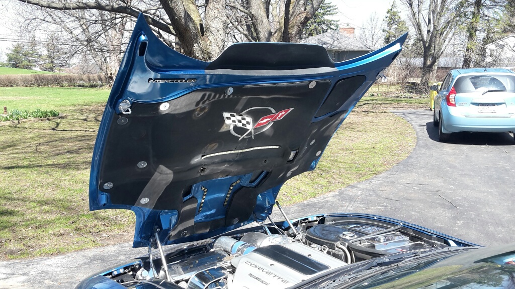

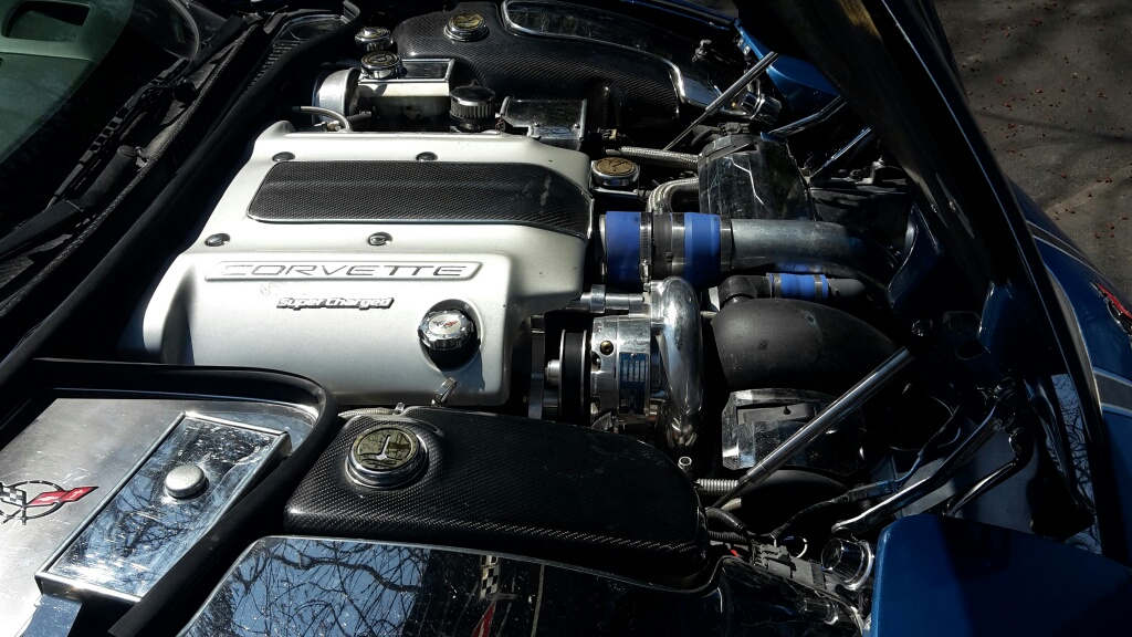

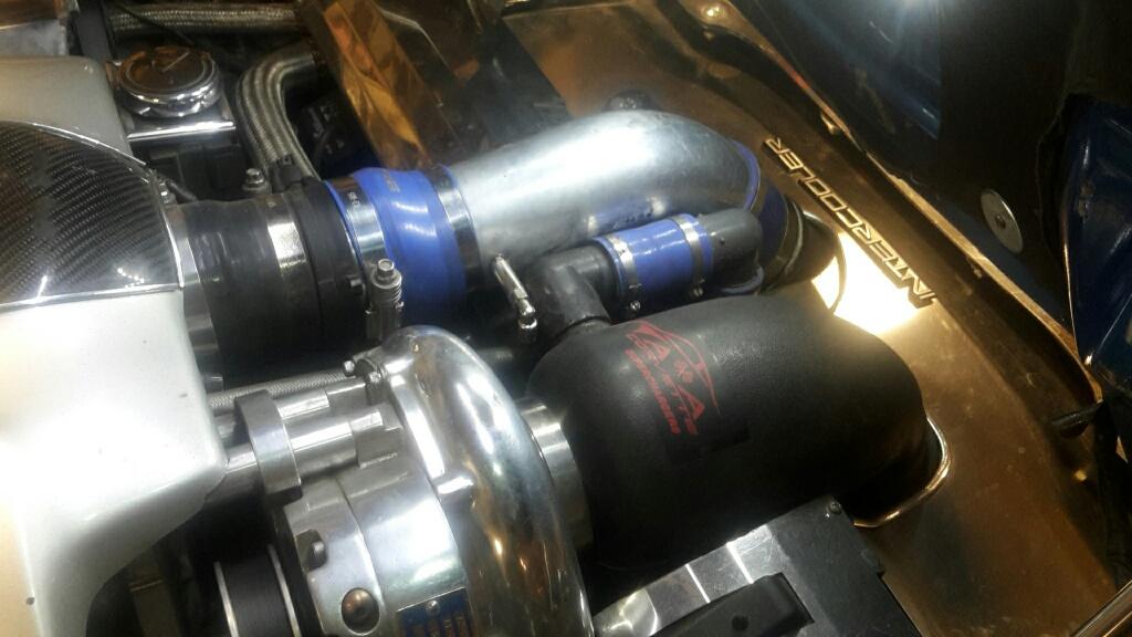

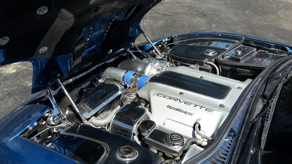

My stock 2002 vert engine except for shorties with 8 psi boost A&A kit dyoed 537 rwhp and 483 ft/lb of torque.
That was before the long tubes and smaller pulley.
The long tubes with the 3.6 dropped the boost to 6 and the 3.4 pulley brought it back up to 8 psi.
I put a McLeod RXT dual disc clutch as the stock one the pedal sat on the floor for a minute
after WOT blasts which got worse after the long tubes and the flywheel was blue in places.

No I'm not but they were closer to Buffalo than ECS and were a forum vendor at the time.
I put the kit on 2 months after I bought the car.
I don't know their names but the tune is great even not in boost.
Feels like a bike.
I relocated the rad back to the stock location by redoing the cradle.
I also recirculated the BOV into the intake to get rid of the tshing noise I hated.

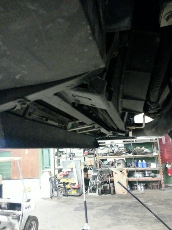

Do the rad cradle mod by moving the perches down
and get an extra inch of ground clearance.
ECS Trans brace.
I had some wheel hop.
Also added a trans mount.
Also

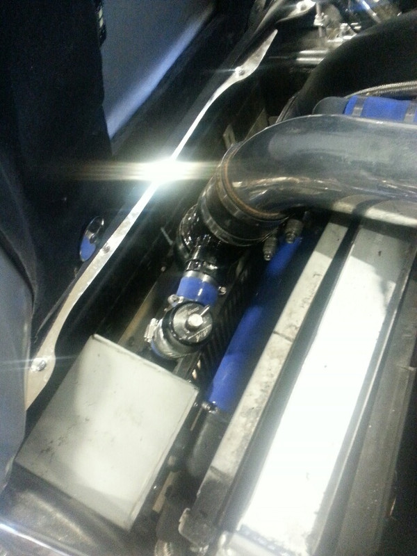

I recirculated the BOV into the intake because I couldn't stand the constant tshing noise on every shift
Shift tsh, shift tsh
Now it's just a little chirp I only hear occasionally.
ACP Advanced Cooling Products 2" Rad $250.00
Added distance for more time to dissipate the air charge.
Made my own T fitting from white ABS plumbing painted black which is thick and fine after 5 years not soft or deteriorated despite the heat.

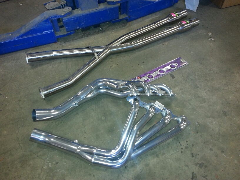

Add headers
These are Melrose but ebay has Monzos
for 250.00
