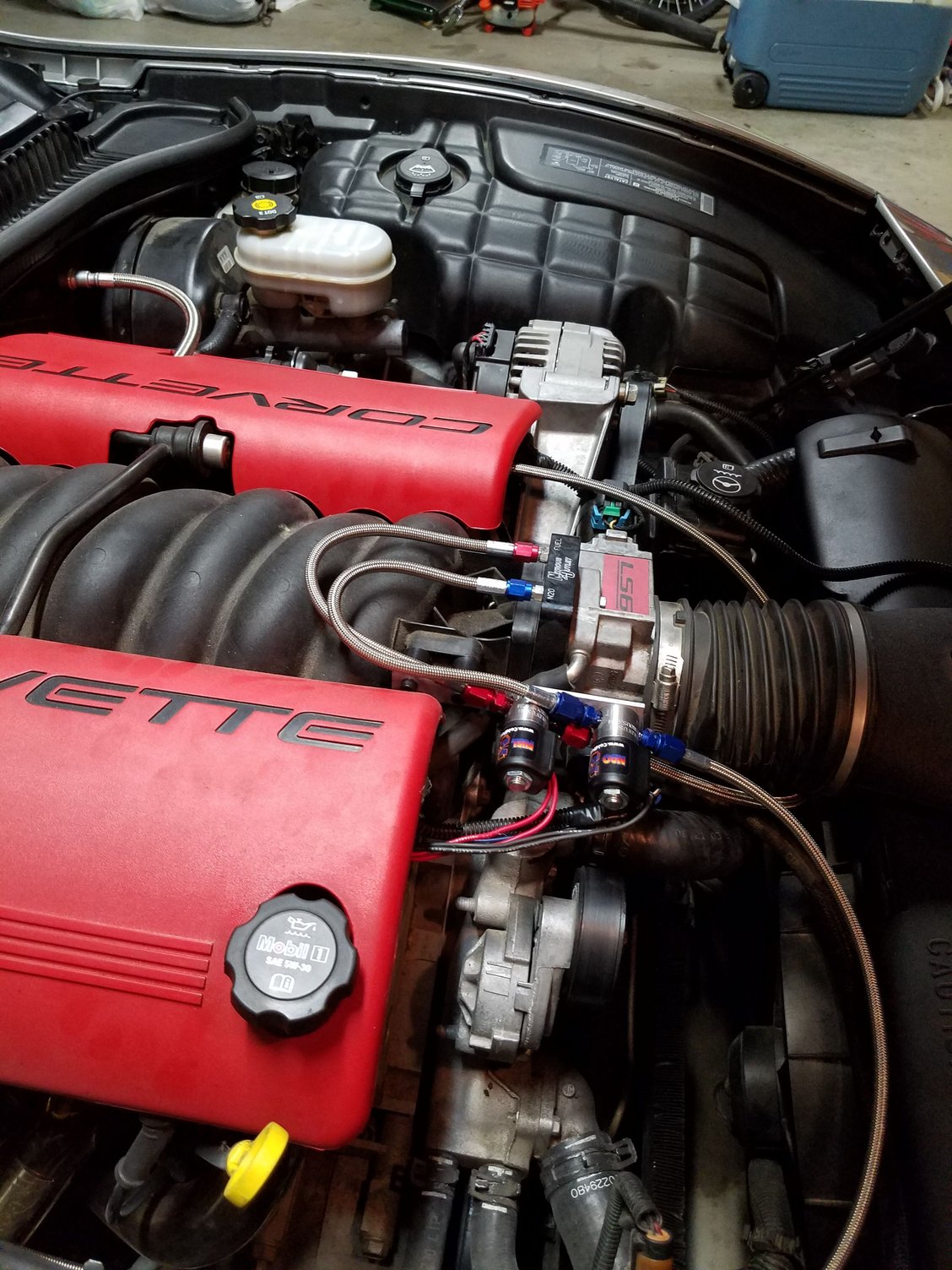

I have my system(78mm Plate system) all plumbed up and what not, but the fuel rail covers are not able to fit now. I have my solenoids at the front of the motor and have the hoses routed under the throttle body from side to side.
I would like to get the FRCs to fit to cover up the wiring and what not in the engine bay. How does everyone have their solenoids mounted?
I saw the passenger head mount for the solenoids, but I don't think the fuel rail hose will be long enough to go from the driver side of the motor to the passenger side for the fuel solenoid.

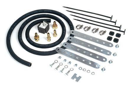

I made some brackets that attach to the fuel rails. With the provided lines. they just seem to fit here. Otherwise you'll probably need to make some custom lines.

I like the way that looks. Do you have any diagrams of the brackets? Did you make any other sets?

It's not fancy but does the job. Made with those universal mounting brackets like you get with a trans cooler.

i didnt like the fact that i couldnt have the covers either....here is what i did with my cheapie noids !
