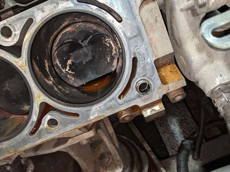

Engine is torn down to address a leaky head. Looks like bolts weren't torqued right. Coolant was leaking out of the front dowel pin. Planning on sticking LS9 head gaskets in with some ARP bolts. I would use studs, but I already have these bolts in my garage. Also looks like the 243's I have are ported. Tracking down an ls6 intake to run now.

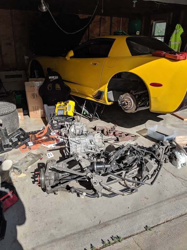

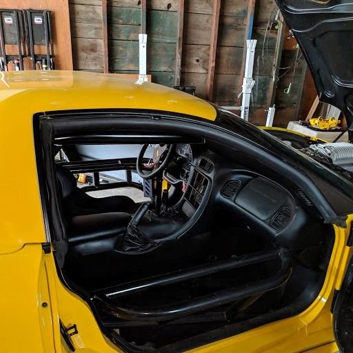

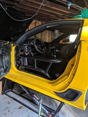

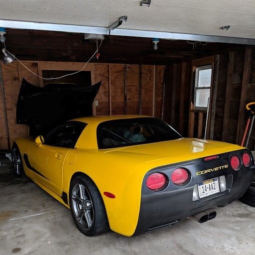

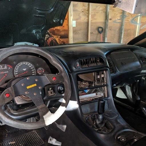

Some additional pictures of my car. I've had it for a year. Building it to be an all-around race car. Road-race, standing mile, quarter mile, etc. Lots of progress to be made. Planning to re-assemble and run naturally aspirated for an undefined amount of time. Transmission is shot so I have a c6z rear end ready to go in the car.
