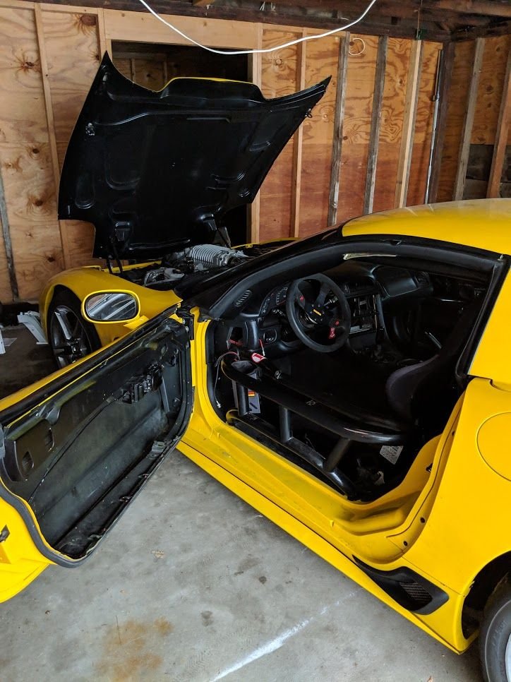

Hello all, long time lurker looking to get in the game. I've got a track rat I just pulled a maggie off (came with the car). Engine was built for boost by Lingenfelter many years ago. From the serial # on the block Lingenfelter stated the engine is still 347cu, but it has a stroker crankshaft. Assuming they wanted a slimmer cylinder bore. I'm a little concerned about picking a random cam for boost if my piston movement will be different than stock. Is this a valid concern?
I think the simplest method of achieving my numbers will be on a centrifugal blower on e85. I plan on converting to flex fuel (have a p59 pcm). Does anyone have recommendations on a setup to be simple and reliable? The turbo kits and builds i've seen are awesome, but fairly complex. I'm considering an aftermarket ecu, and would go for the new holley terminator x if its well received.

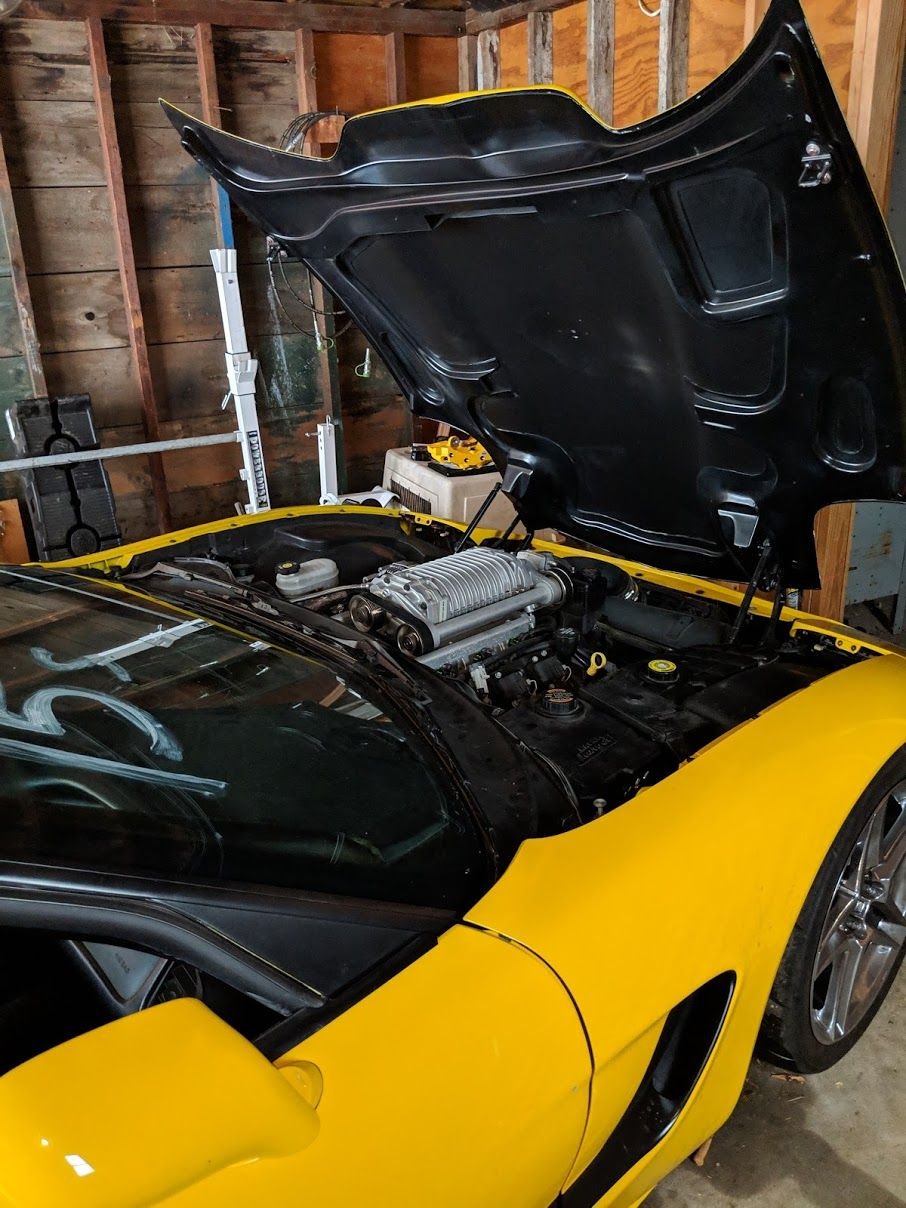

looks like a 112 in the pics, which would take a LOT more effort and $$ to get to 700whp than using a TVS2300.
Correct. It is a 112. Not worth the effort and its already sold.
