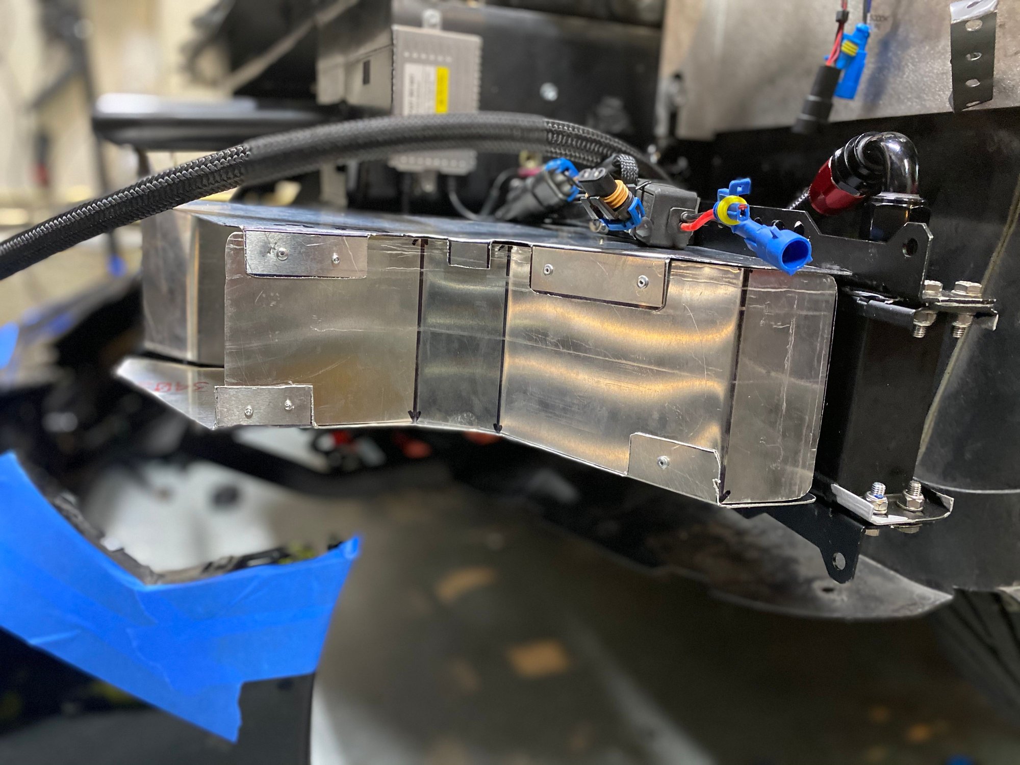

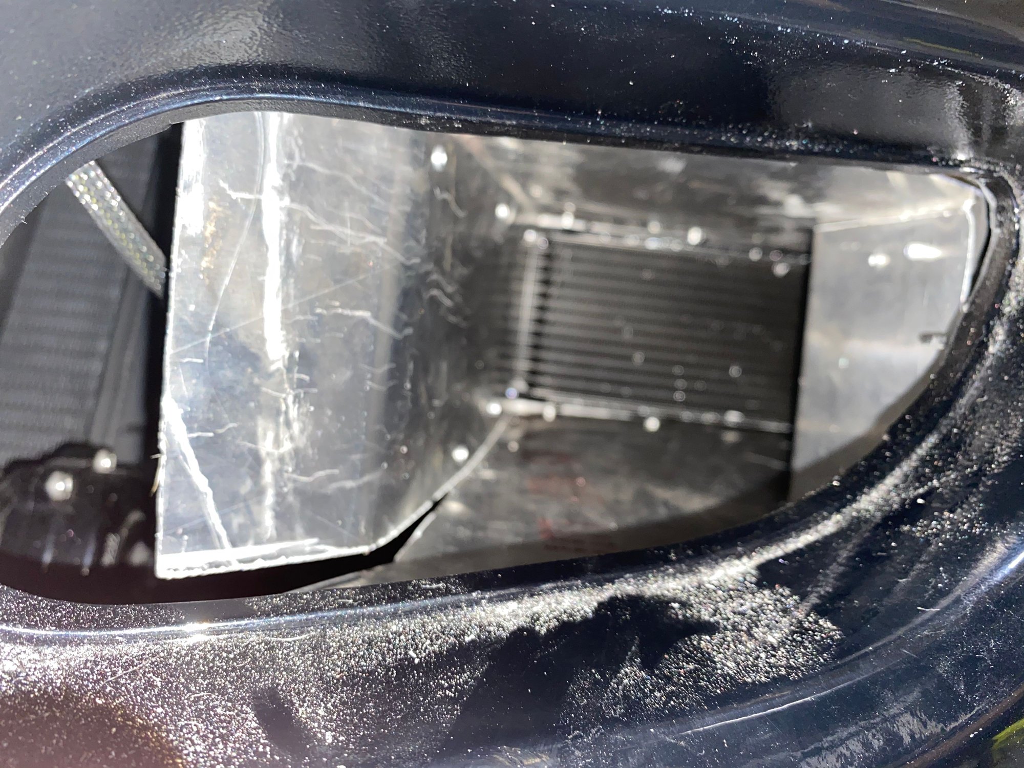

Setrab series 6, 13 row core that I built a mount and duct for. I’ve since welded and sealed the entire duct to the bumper and cooler. I’ also using the improved racing 200* thermostat on the oil pan so it won’t overcool the oil. It’s not the largest core but I’m interested to see if it will help keep oil temps down and therefore reduce the load on the coolant.
I used some foam core craft board to make templates then traced it all onto the aluminum sheet. Cut, bend, rivet and weld and it fits great.
Disregard the exhaust strap, I used that to hold things in place temporarily.

you inspire me my man. I have my tranny cooler partially overlapping the intecooler (new inter heater feature, no bueno), and I have a nice oil cooler lying around.
I want to move the tranny cooler and oil cooler into the corners up front and duct it in. I'm an old model airplane guy so I use the german thin ply. Easy to cut and fiberglass into the duct shape needed.
You've got made skills with the tin, and I might have to give that a try as it looks very slick. Hoping to get the temps down on bigger boost which is a challenge the E85 I know will help

I still have my foam core templates somewhere if you want to use them as a starting point.
