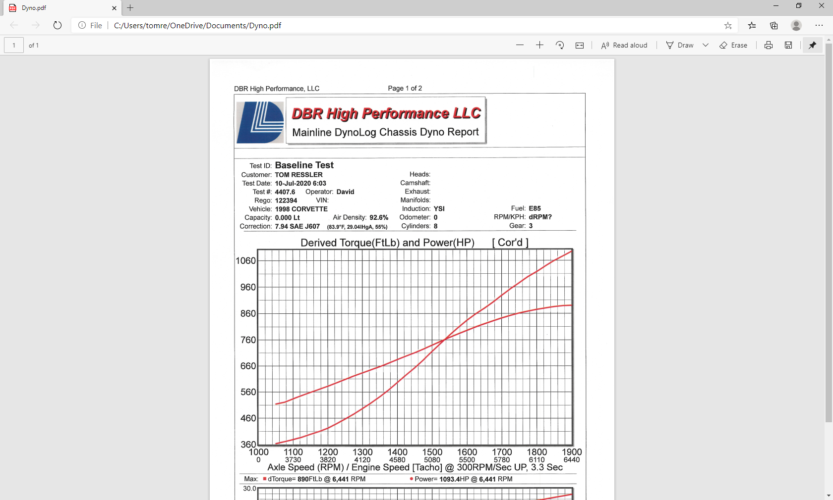

I made 1100 rwhp on 120# Bosch injectors, Aeromotive 3.5 variable speed pump with Fore return style regulator. 70% duty cycle with base fuel pressure of 55#.
With e85?! That seems rather impossible to have such a low DC on 120# Injectors.
Well it was only 1093.4 but I claimed 1100. And yes it is on E85 with 120# injectors. I went back and looked at the log and it was 75% duty cycle.

Are you sure you have 120 injectors or do you use ALOT watermeth? I have 1008hp and duty cycle was near 70% with Bosch 220.
They are 1200cc, using 55 pounds of base pressure with a boost referenced return style regulator.
