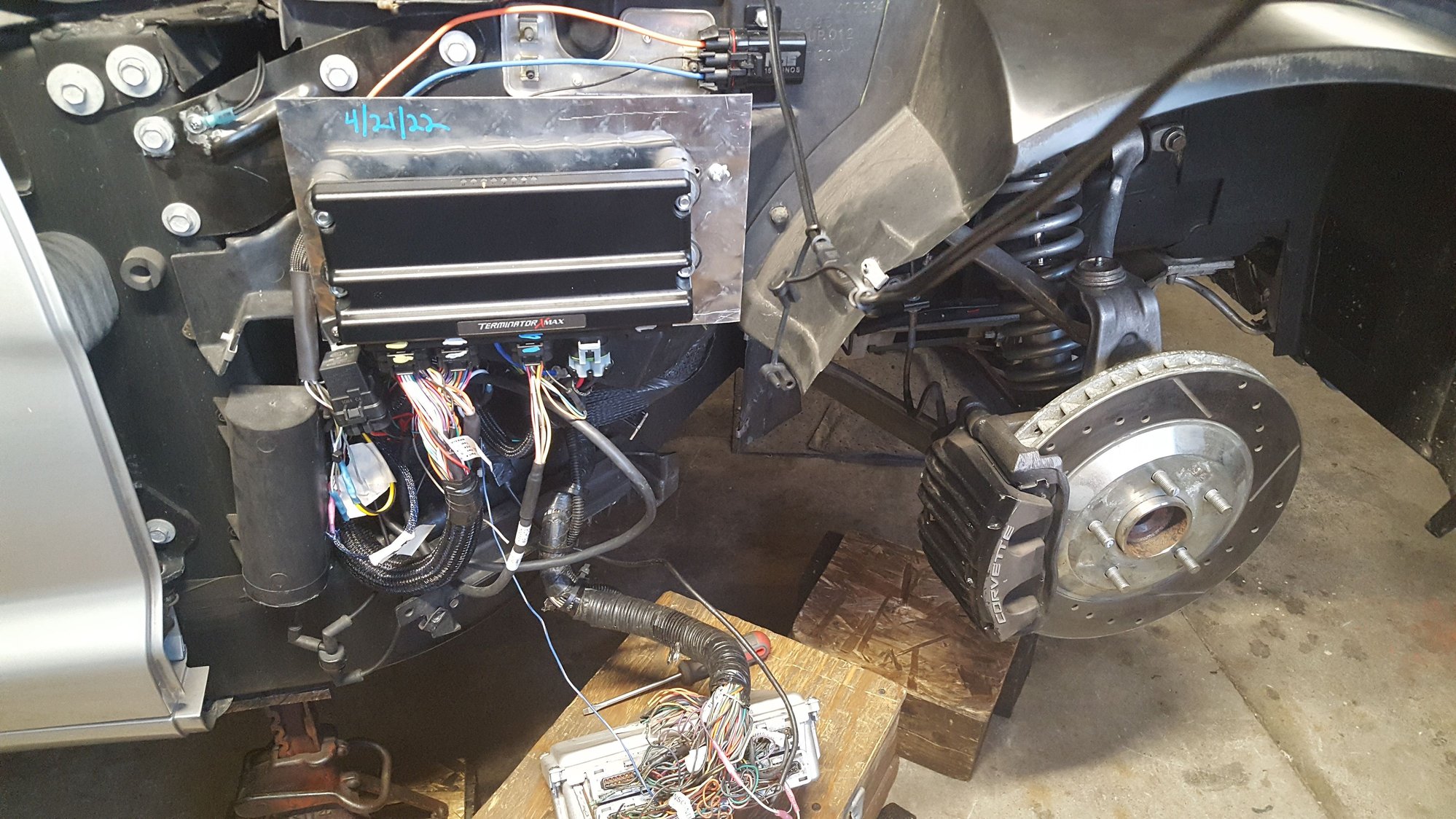

Got any pics of where you mounted the ecu?
Old Apr 29, 2022 | 09:35 AM
DRIVER456's Avatar
DRIVER456
Joined: Jun 2005
Posts: 3,088
Likes: 61
From: NY- 2013 Corvette Challenge Champion-2013 Index Combo Champion 2015 CC/MM Champion
St. Jude Donor '07
Passenger side fender well For some reason picture won't load,But you have to take fender off,And you'll have to make a bracket.I'll try getting picture
