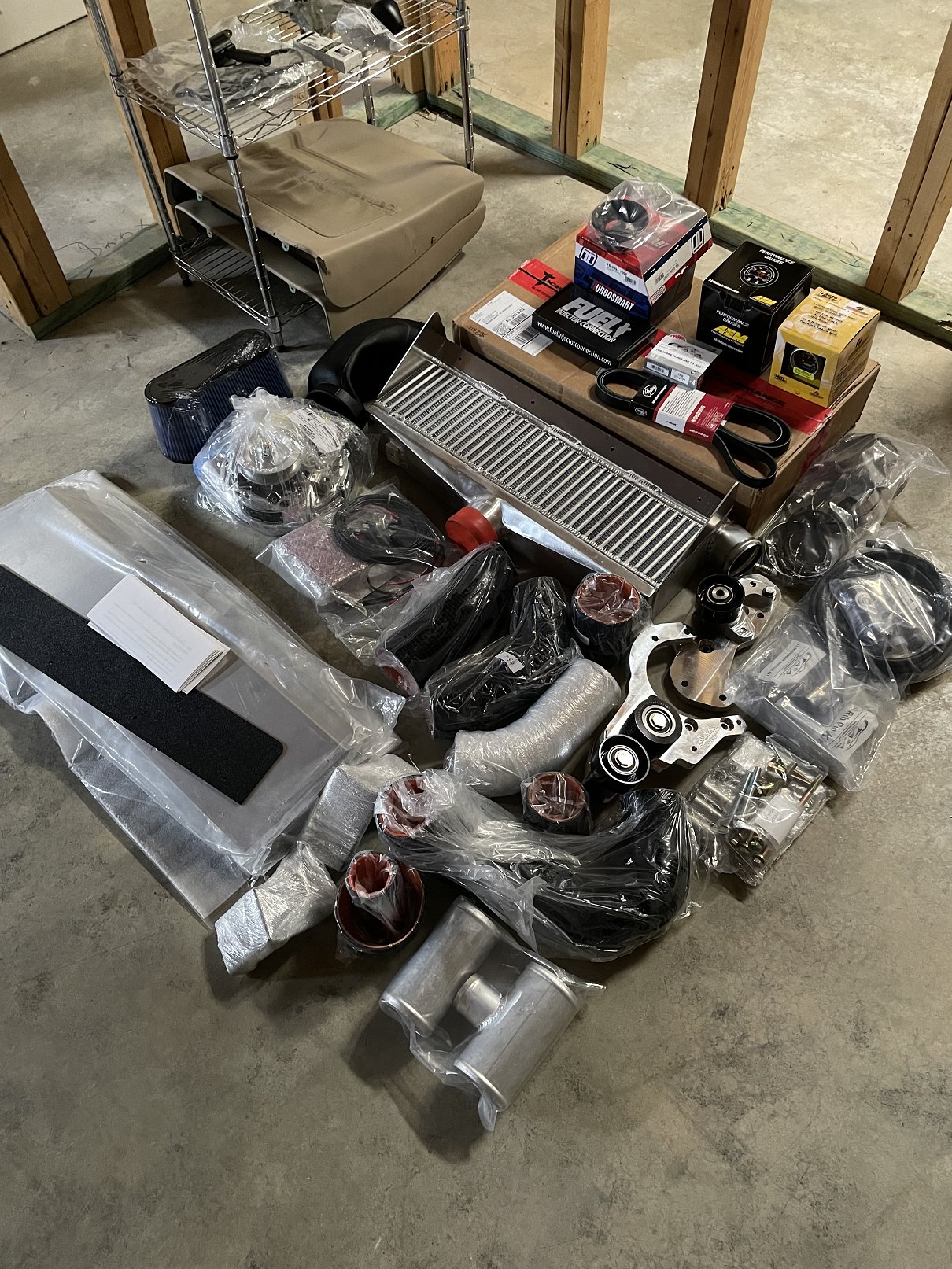

Hey guys, I have a 20k mile 2004 Z06 that is mostly stock. It currently has Borla stingers, short shifter, C6 Z51 brakes, lowered on stock bolts and 18/19" SP500s.
I recently purchased an AA kit along with other pieces and wondered if I could get some feedback regarding supporting mods. I've been searching the forums for the last several weeks...
I don't have specific rwhp goals, but would like to be a little over 600 in the end. I don't want or need a dyno queen. This car is more of a weekend driver, but does get driven. Never been to the track in this car and probably will keep it 100% street driven. Rarely launch hard on the street, but do enjoy punching it from a roll.
Here is my list:
AA V3 Ti with 3.6" pulley
80# injectors
52mm BOV
NGK TR6 plugs
KB BAP
AA fuel system - single or dual?
Alky meth injection
Stock heads
Stock bottom end
Tick stage 2 blower cam (227/243 | .625”/.615” | LSA116+6)
Straub trunion kit
Hardened pushrods (stock length, 7.400?)
Dual valve springs - any recommendations?
Aftermarket rocker arms or keep stock?
ATI stock sized balancer
Crank pinning kit / new GM bolt
Katech C5R timing chain
C6 PS pulley
Melling high pressure oil pump
Dewitts radiator
SPAL fans
Stock thermostat?
LG pro long tubes 1 3/4" with catless X
(Keep Borla stingers)
ECS diff brace
Aftermarket clutch (haven't decided which brand)
Would like to hear your thoughts or suggestions! Thanks.

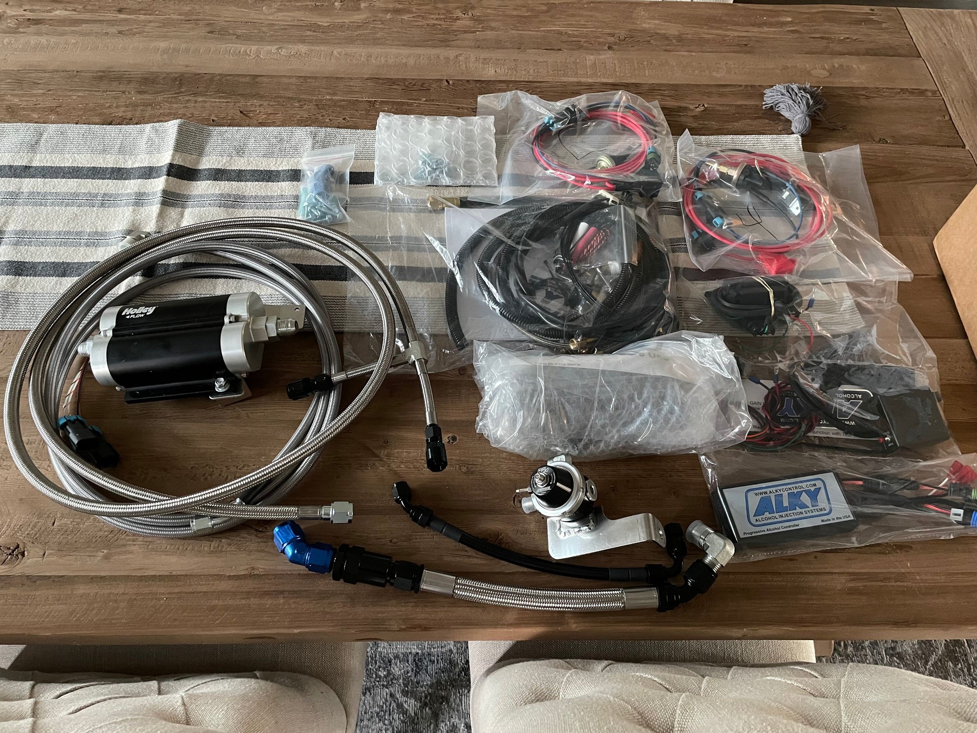

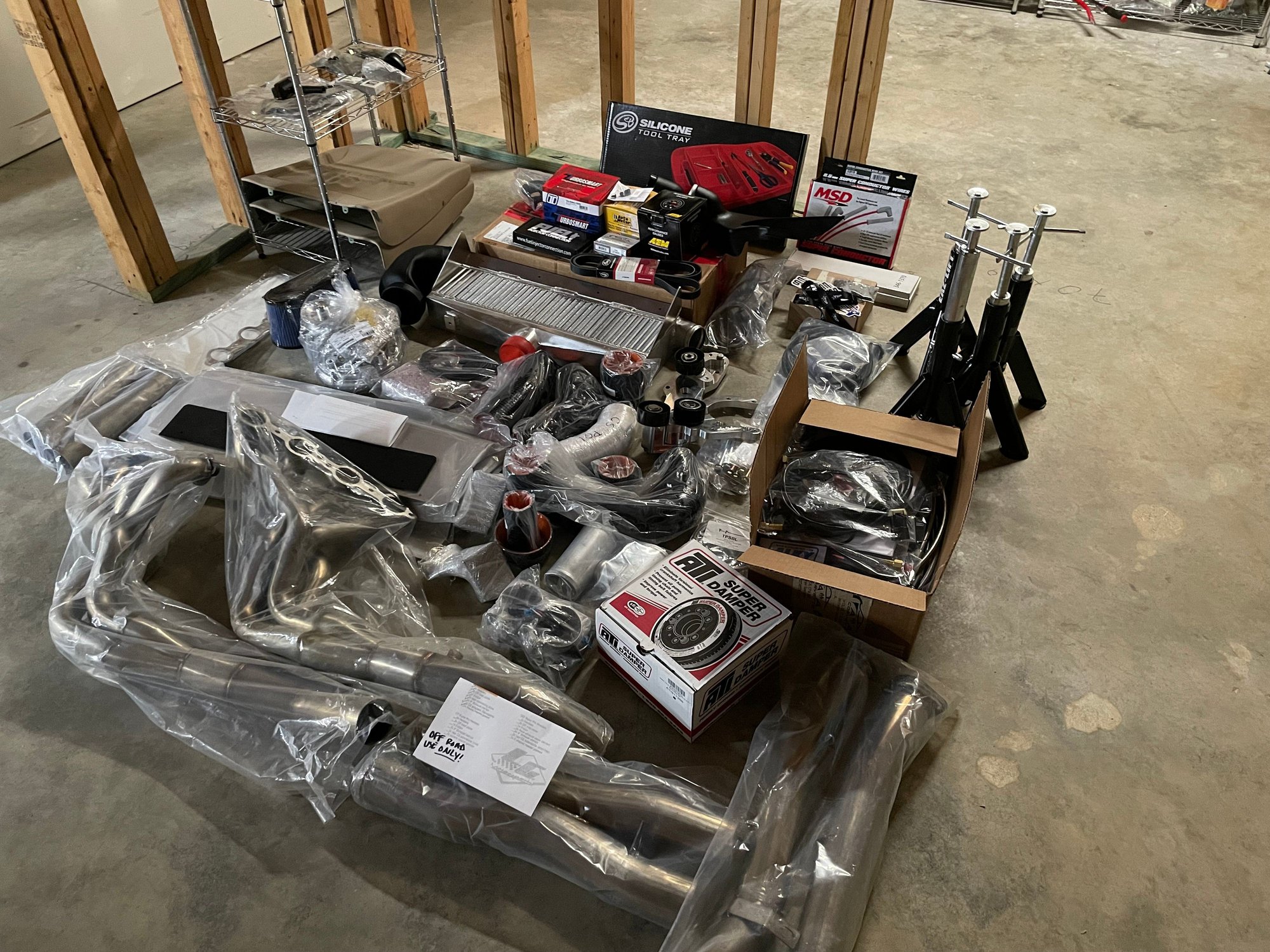

Thanks for the advice guys. A lot of things to consider here so I appreciate the input.
So far what I have purchased:
AA V3 Ti Kit - 6 rib
3.6" pulley
80# injectors
Katech C5R chain
Melling 10295 oil pump
Tick TP660DVSK dual valve springs / titanium retainers
Pushrod length checker (hardened pushrods later)
Timing cover / water pump / cam gaskets
LG 1 7/8" pros with catless X-pipe
AEM Wideband
Autometer boost gauge
A pillar pod
I'm still looking around at a lot of other items that need to be purchased including the fuel system, cooling system, and clutch.

Parts are starting to arrive...AA kit showed up yesterday after sitting at a FedEx distribution center for 3 weeks!

just wait until she get's home and see's what's cooking for dinner!!
great parts ****. Makes me want to update the p1sc 6 belt drive to my A&A with 8 rib. I went with the innovators west 10% OD pulley so you can run a bit larger blower pulley for less slip
600 at the tire is plenty of fun on street tires. My turbo car puts down 800 which is fun at the track but more terrifying than fun on the street. The blower cars ramp the power more linear and you don't get to full boost until max rpms so they tend to be a bit more controllable (and often better) on the street.
I was about to yank my p1sc and go twins again, but I'm mellowing as I get older and I think 800 at the tire will take me from zero to jail fast enough.

AA dual fuel system and Alky meth kit arrived today. Also received the C6 PS pulley and Straub trunion kit.
The only thing left before I start the install is to buy a clutch. I've been thinking about going with a Mantic twin disc. Would you all stick with a steel flywheel or go aluminum?

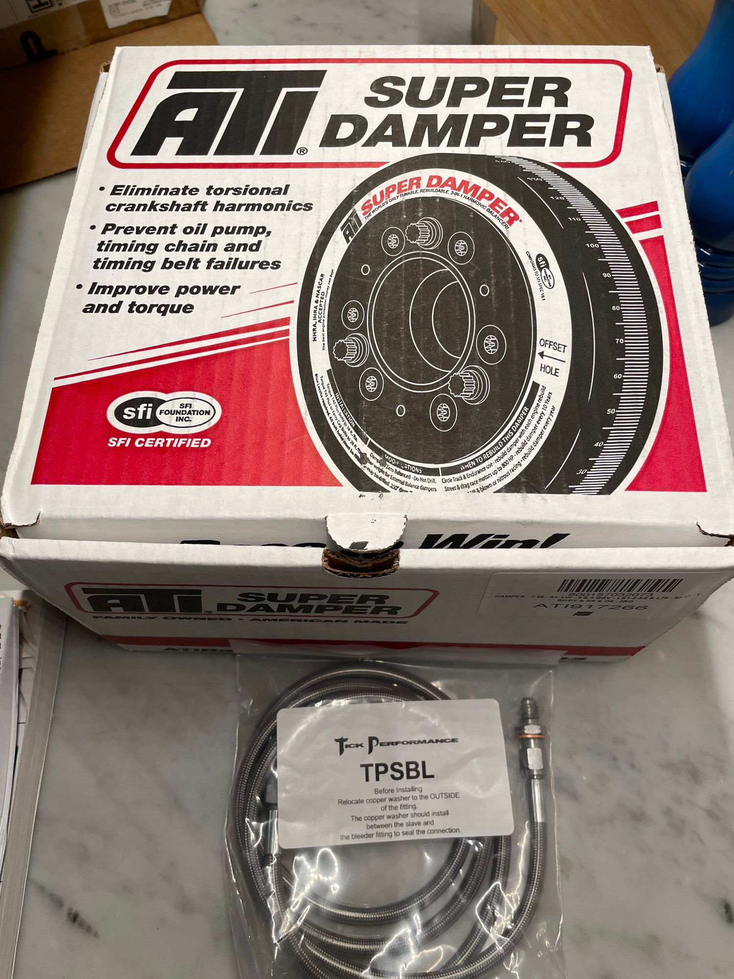

ATI balancer and speed bleeder arrived
The pile keeps getting bigger lol
Ended up going with the Mantic twin disc / lightened steel flywheel, which should arrive on Friday
Mantic Clutch
Figured I would go ahead and get the car set up. Swept the garage, moved the Jag out so there is plenty of room, and have been looking at multiple threads / youtube videos of the best way to approach the install. Loving the QuickJack already.
