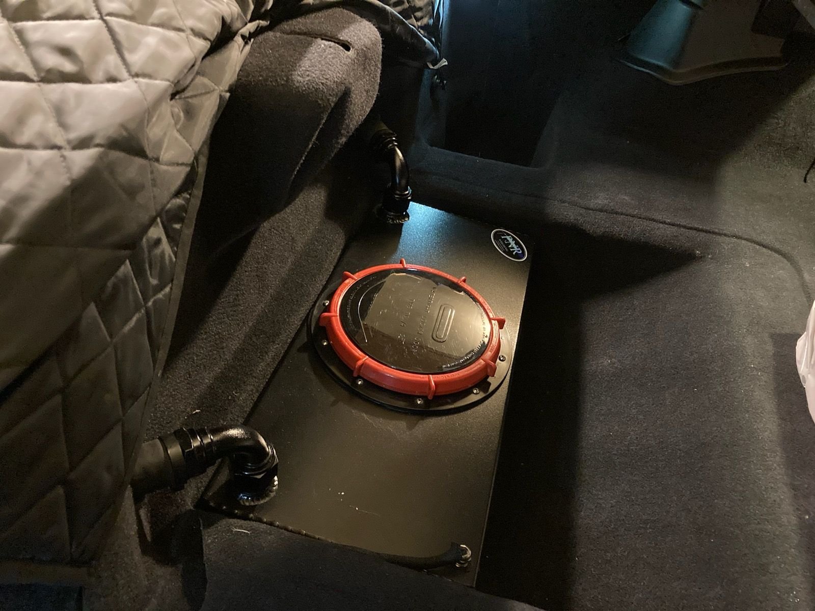

So I have a very large PNR aluminum trunk tank for my 2650 and was wondering, do you guys know if there is a tank that fits in the middle area (where people put a sub box) or something more compact? Current tank is 6 gal. Smaller would work even

Guys, thought I'd update. Did the conversion and put a smaller tank and smaller heat exchanger with a fan in the back. IATs went up by about 10F BUUUUT, my coolant and oil temps are like 20F lower in 100F weather!!

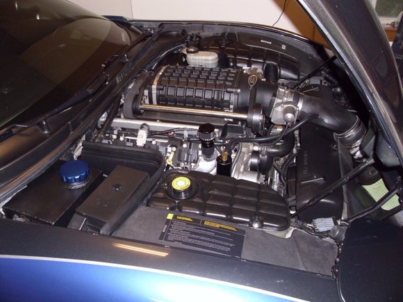

Bret built me one the size of the stock battery box (moved battery to the right rear cubby), and i've been happy.

Hows that tank with temps, being in the engine bay area? I'm running the Kong 2650 on a fully built LSX 388.

shoot!! must be raunchy!!
my case has been all over the place for a while... the a/c started leaking ever since i got the car back from build in spring 2019 and never got fixed until last week... so i ain't got any long-term temperature data. that said, when Bret was tuning (and the chiller was working great), i can't remember what temps the blower coolant maintained (thinking in the low 40s°), but he did mention that dyno pulls on an almost-100° TX day were showing IATs around 100° at 10psi. we didn't get that detailed of data on the 13psi tune (street driving only).

already done - that's how i got the 2.5gal tank pictured above in the battery spot.
i'm also still using my stock magnuson intercooler pump.
