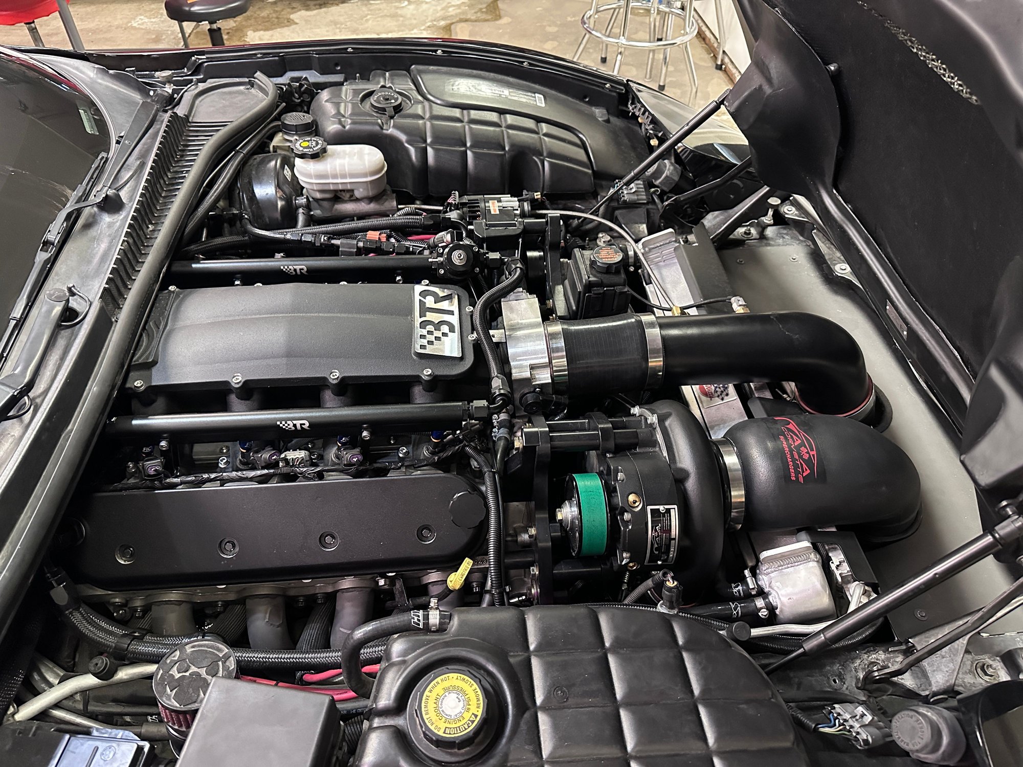

Car made 715 624 on the dyno.
2001 6 speed C5 corvette LS1 stock bottom end. mods are
stock 243 heads
BTR equalizer 3 intake manifold
Nick Williams LS1 style 102mm TB
FIC 1000cc injectors
BTR jam cam
A&A v3 SI griptech 8rib 3.6 pulley
A&A flip drive
ARH 1 7/8 headers no cats
chrisracing dual 450 pump setup
tuned on e85
monster lt1s twin disc clutch
ECS transmission brace
Rick wells differential mount
16 degrees of timing
14 pounds of boost

A&A v3 SI griptech 8rib 3.6 pulley:
im quite surprised your making that much boost. what rpm?
edit: oh, overdriven balancer?
